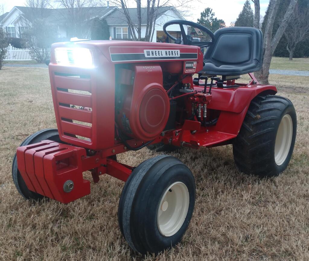

markseven 93 #13 Posted September 30, 2025 Does my bronco 14 have the voltage rectifier external or is that behind the flywheel next to the stator Share this post Link to post Share on other sites
kpinnc 18,714 #14 Posted September 30, 2025 3 hours ago, markseven said: Does my bronco 14 have the voltage rectifier external or is that behind the flywheel next to the stator Should be external. May be mounted behind the dash tower. If not it's mounted on the engine tins. 1 Share this post Link to post Share on other sites
953 nut 67,195 #15 Posted September 30, 2025 Your voltage regulator should look like this one mounted in the hood stand. 1 Share this post Link to post Share on other sites
Maz91 305 #16 Posted October 1, 2025 16 hours ago, 953 nut said: Your voltage regulator should look like this one mounted in the hood stand. This absolute disaster of a garage looks just like my garage 🤪 1 Share this post Link to post Share on other sites
953 nut 67,195 #17 Posted October 1, 2025 18 hours ago, Maz91 said: This absolute disaster of a garage looks just like my garage 🤪 Not my garage, I borrowed that photo from another thread to show where the regulator is mounted. 1 Share this post Link to post Share on other sites
Maz91 305 #18 Posted October 2, 2025 (edited) It’s my garage hahaha @953 nut Edited October 2, 2025 by Maz91 Tagged a member 1 1 Share this post Link to post Share on other sites
