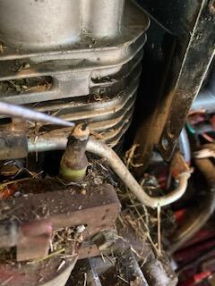

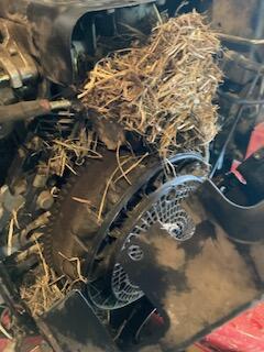

John A 35 #13 Posted October 2, 2025 October 2, 2025 Guys: Okay, I have found a serious problem with the Ignition module. The high voltage wire which goes directly to the spark plug was gnawed off. Probably by a mouse since I found a large nest under the engine shroud. I ordered a replacement module from a local parts dealer on Tuesday. It was supposed to arrive the next day. After not hearing from the dealer I called and found the part was misplaced. So now I need to wait for several more business days for a reorder from Granger. Anyone have suggestions for an alternative or faster shipment along with an approximate price for an OEM replacement? The KOHLER engine is a CH15S, Spec 44533, Serial # 3506918161. I was initially quoted a price of approximately $35. I am not sure of the price from Granger will be. Thanks for the HELP with the troubleshooting. All the safety switches tested out as working. Your help was invaluable to me. Of course, the last thing I looked at, was the coil. John A 2 Share this post Link to post Share on other sites

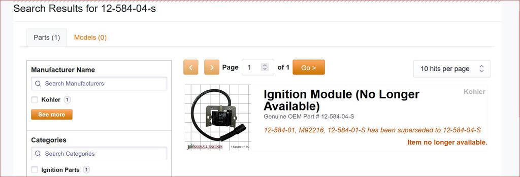

John A 35 #15 Posted October 2, 2025 The Part # listed on Part Tree is 12-584-04-S. John A Share this post Link to post Share on other sites
Ed Kennell 47,946 #16 Posted October 2, 2025 I don't know what the difference is between the 01, 04, and 45 models. Maybe someone will chime that can help. Share this post Link to post Share on other sites
RED-Z06 2,720 #17 Posted October 2, 2025 O4 and 01 should interchange, 04s is long discontinued 1 1 Share this post Link to post Share on other sites
Lagersolut 808 #18 Posted October 3, 2025 From Jacks small engines 1 Share this post Link to post Share on other sites
Lagersolut 808 #19 Posted October 3, 2025 (edited) The Jungle site also has an aftermarket alternative for $18 if OEM doesn't matter Edited October 3, 2025 by Lagersolut 1 Share this post Link to post Share on other sites
John A 35 #20 Posted October 3, 2025 Guys, My local parts dealer came through late this afternoon and found the misplaced module I ordered on Tuesday. All the parts and switches are reinstalled along with the new module. The tractor started immediately when I turned the ignition key. It is running great. It took me longer than expected to reinstall the metal engine shroud. Below are two pictures of the problem. I spent probably over an hour removing the grass all around the head of the engine using a vacuum. I had not noticed the engine overheating but with all the grass and straw removed it should run cooler, Thanks to all for the advice. John A 2 1 Share this post Link to post Share on other sites
