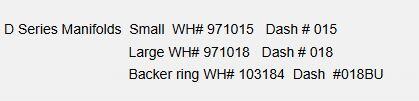

JSW 9 #1 Posted September 27, 2025 Does anyone know the o ring sizes used between the manifold and hyd.motor on d series? Share this post Link to post Share on other sites

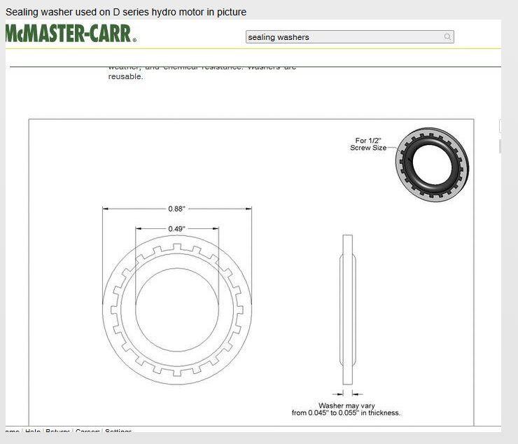

pfrederi 21,145 #2 Posted September 27, 2025 The sealing washer is 102817. I use a sealing washer from McMaster I have all the rings and the washer. PM your address and I will send you a set. 1 Share this post Link to post Share on other sites
