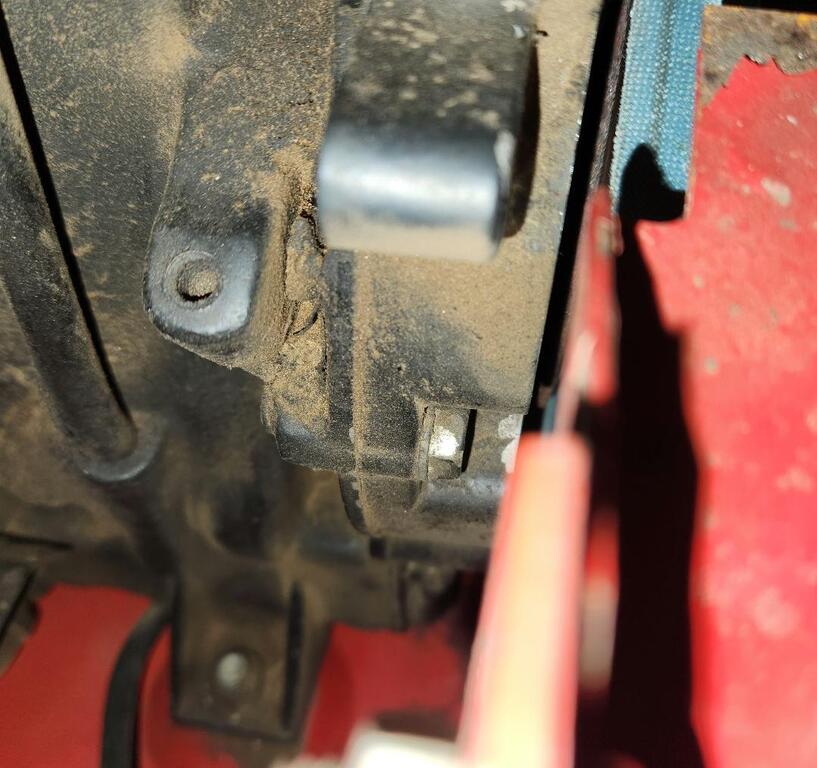

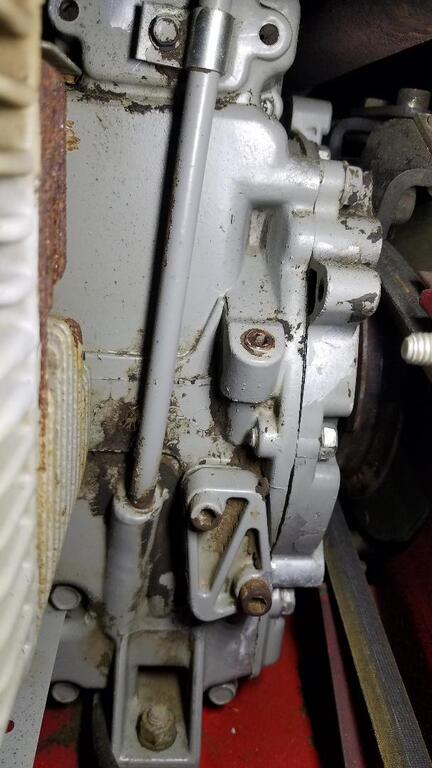

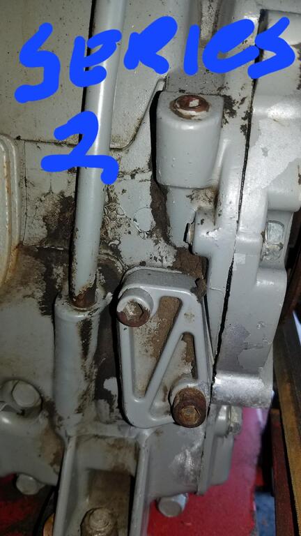

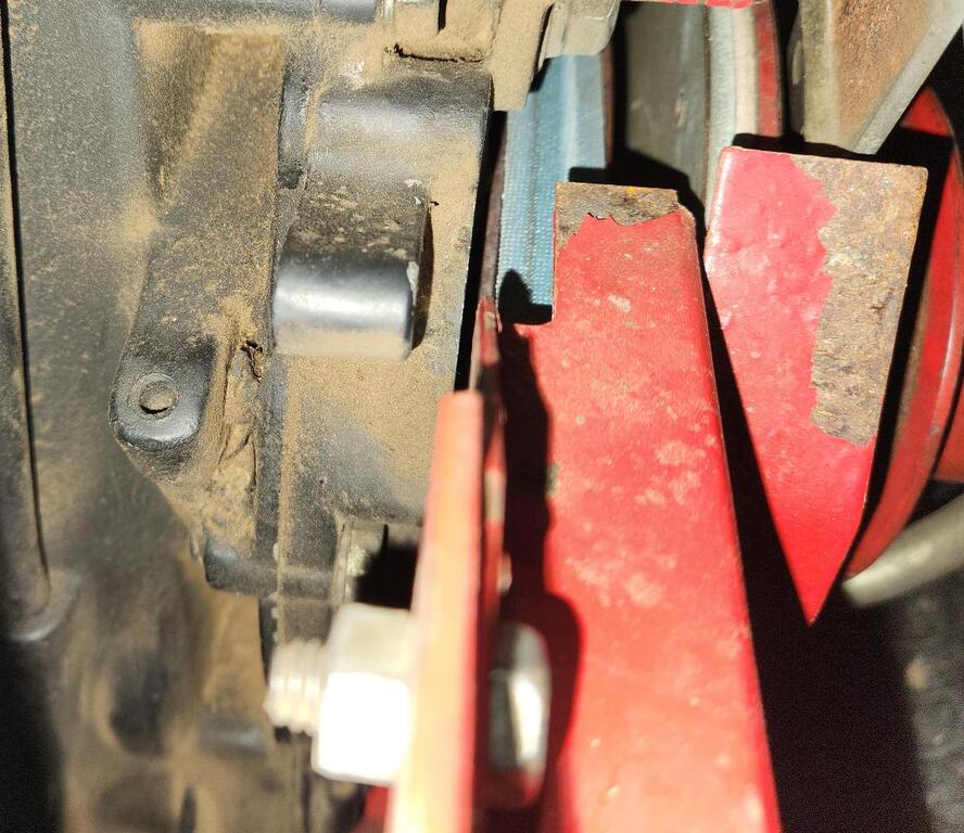

LarryD87301 14 #1 Posted September 25, 2025 (edited) I recently purchased a C175. The previous owner said it had a recent overhaul and fuel pump replacement. I used it a couple of times with the installed front bucket loader and rear mounted blade with no problems. I removed the bucket and blade and installed the 42-inch rear discharge deck mower. Now after a period of time operating the tractor it cuts out and stops running. Possibly after 45 minutes to an hour of running. I didn't run the tractor that long while the loader was installed. I first thought it was a fuel issue but after a little research I see the tractor has a temp. sensor that shuts off when the oil reaches a certain temp. The engine starts after sitting 15-20 minutes. I did a search and found a thread that mentioned cleaning the fins on the engine cylinders and around the transmission. I blew them out with compressed air, but they weren't dirty. I looked all around the engine and don't see the sensor. Any Ideas? I have a 1981 C175 Twin Automatic a 42 MR02 rear discharge deck mower the Kohler K17 sn 10034679. so, the sn indicates it is a series II engine, but my research said one way to tell a series I from a series II is an oil filter. I don't see an oil filter. Edited September 26, 2025 by LarryD87301 Share this post Link to post Share on other sites

oliver2-44 11,694 #4 Posted September 25, 2025 I'm not a Kohler Twin guru. But to my knowledge Kohler supplies an" Oil Sentry", not an oil temperature switch. This is an oil pressure switch, It is located down around the oil pan possible near where the optional oil filter adapter would mount and has 2 wires coming out of it. 2 Share this post Link to post Share on other sites
pfrederi 21,046 #5 Posted September 25, 2025 The spec number of the engine will ID Series 1 or 2. I have never heard of a temperature cutoff on a KT. Above comments about the coil failing are first choice. 2 Share this post Link to post Share on other sites

Brockport Bill 2,455 #7 Posted September 25, 2025 here are some Series 1 and 2 photos of design differences -- there are some You Tube videos also of the differences of the "filter" area Share this post Link to post Share on other sites
