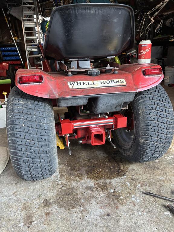

biscuit1088 9 #1 Posted September 25, 2025 has anyone tried to put a sleeve hitch on a gt14? i dont have a 3pt and want to get to the plow day coming up. 3 Share this post Link to post Share on other sites

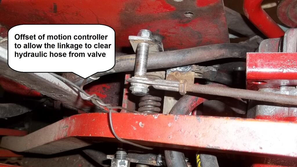

953 nut 70,656 #2 Posted September 25, 2025 Anything can be done if you have enough determination. The three point hitch is connected to the lift cylinder by a heavy bar. You may be able to replicate this using a cable and a couple of pullies to lift the sleeve hitch. Disregard the caption, it relates to swapping a Eaton 1100 in place of the Sundstrand. Share this post Link to post Share on other sites

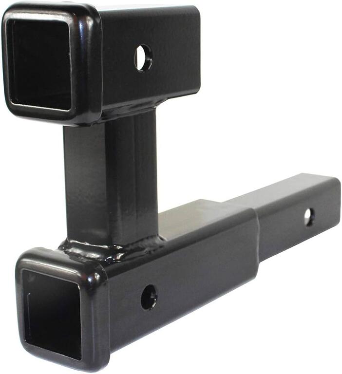

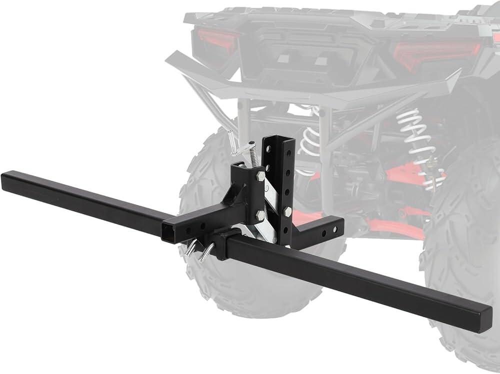

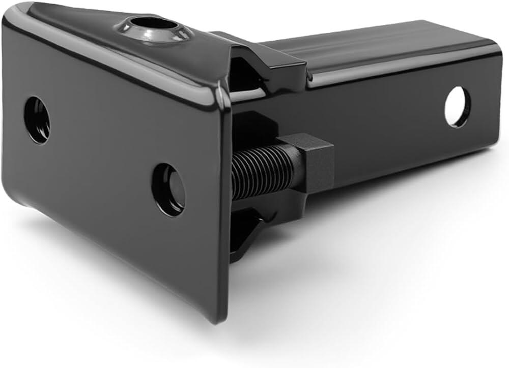

SylvanLakeWH 32,921 #3 Posted September 25, 2025 Not a GT 14 guy but here's what I'm working on for the same concept on my C-125 manual (no hydro): 2" receiver, adjustable hitch, 2" sleeve hitch adapter, winch to raise / lower. Plan bypass the manual adjustment and use winch above. ~ $200. 1 Share this post Link to post Share on other sites
