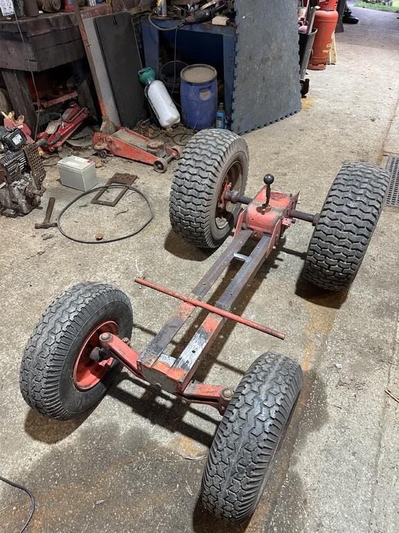

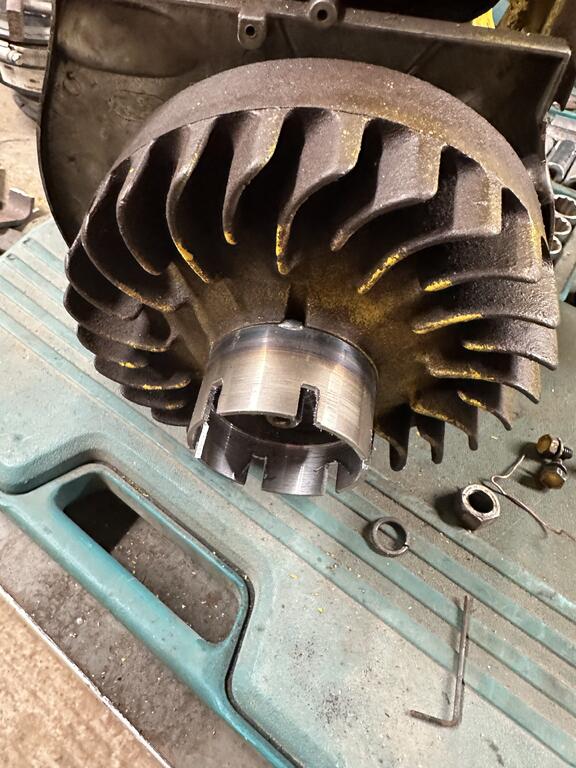

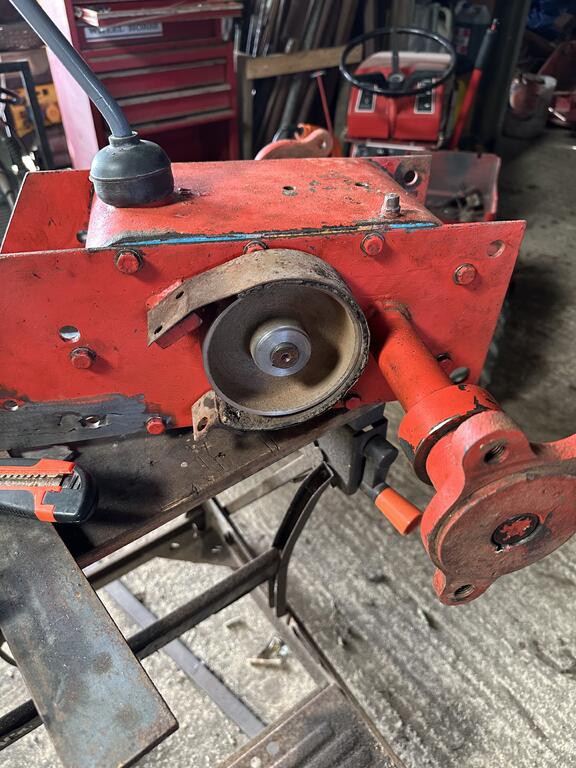

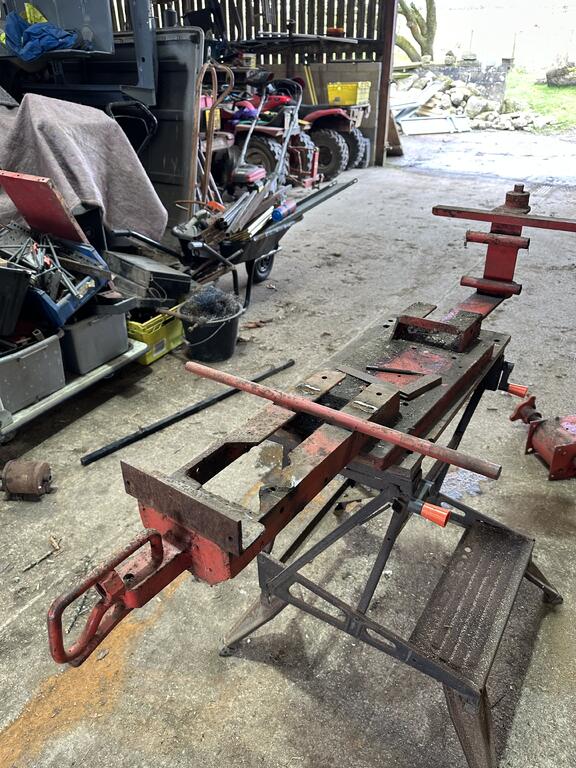

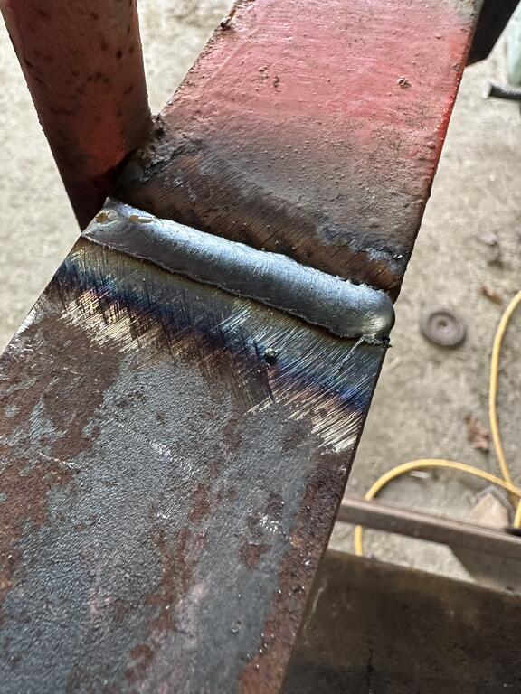

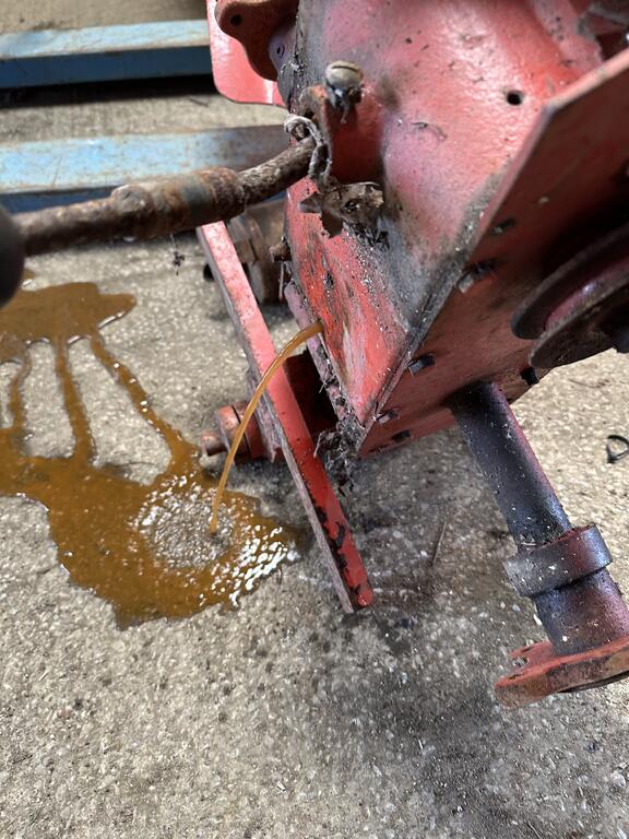

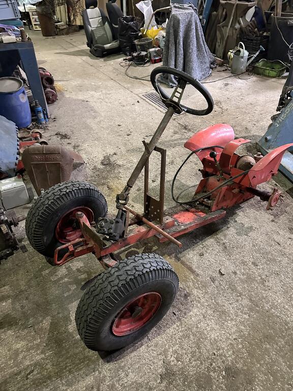

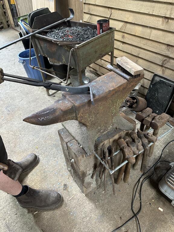

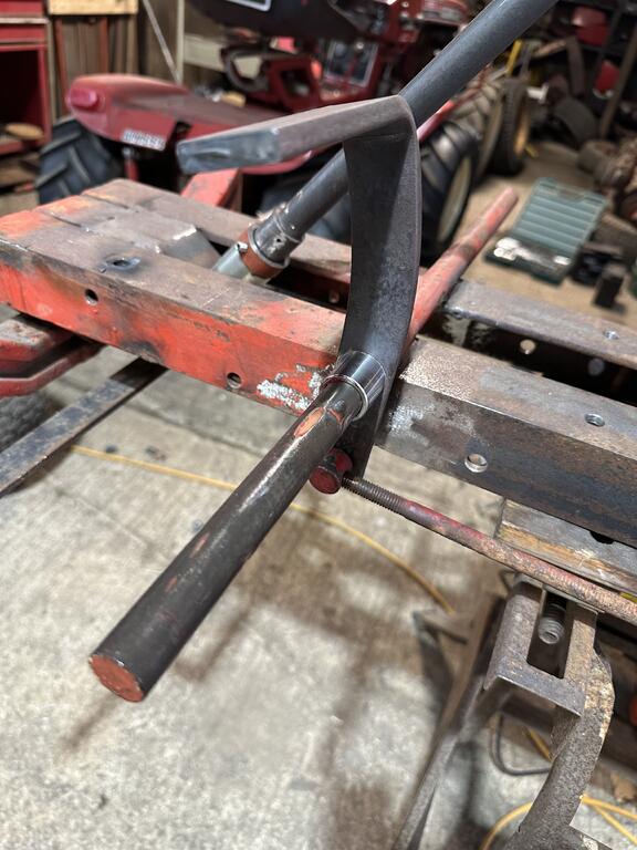

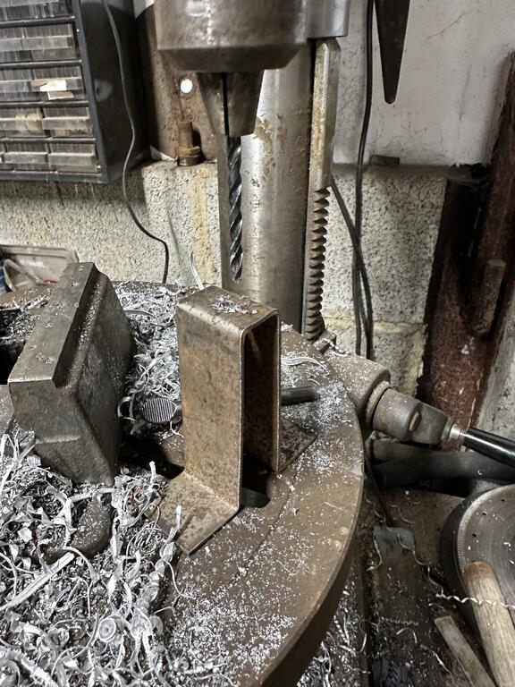

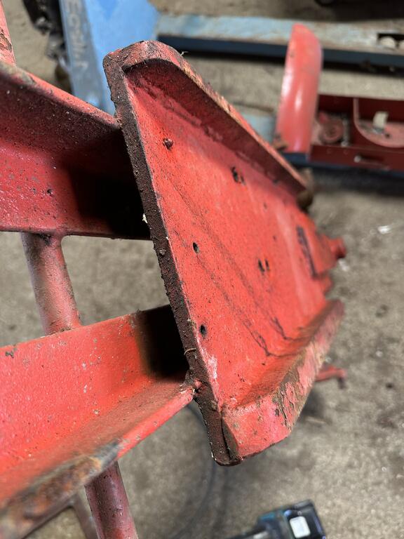

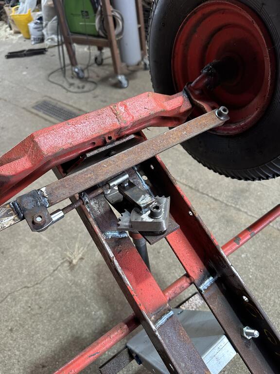

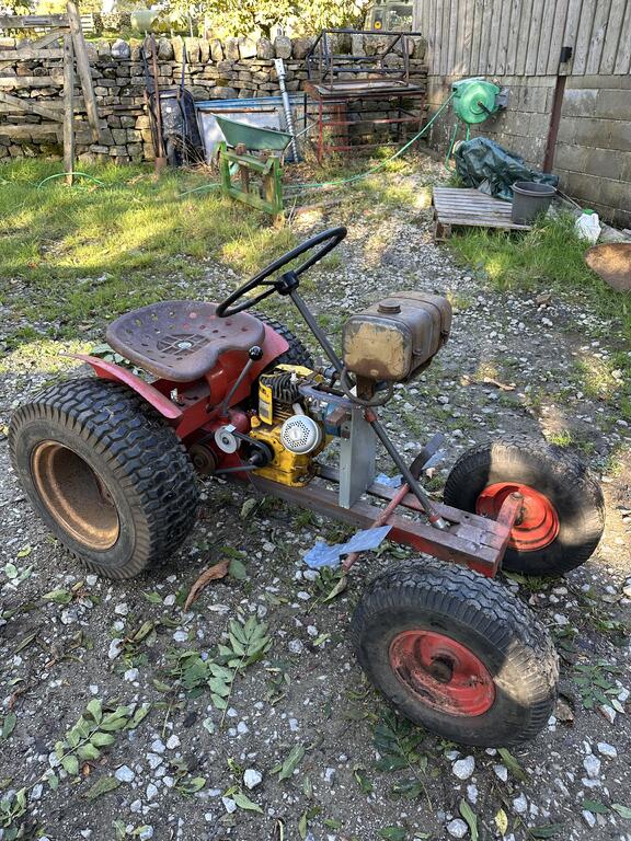

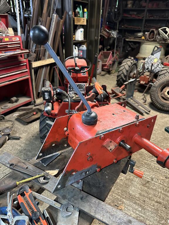

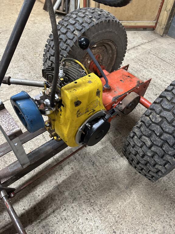

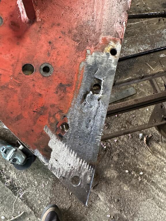

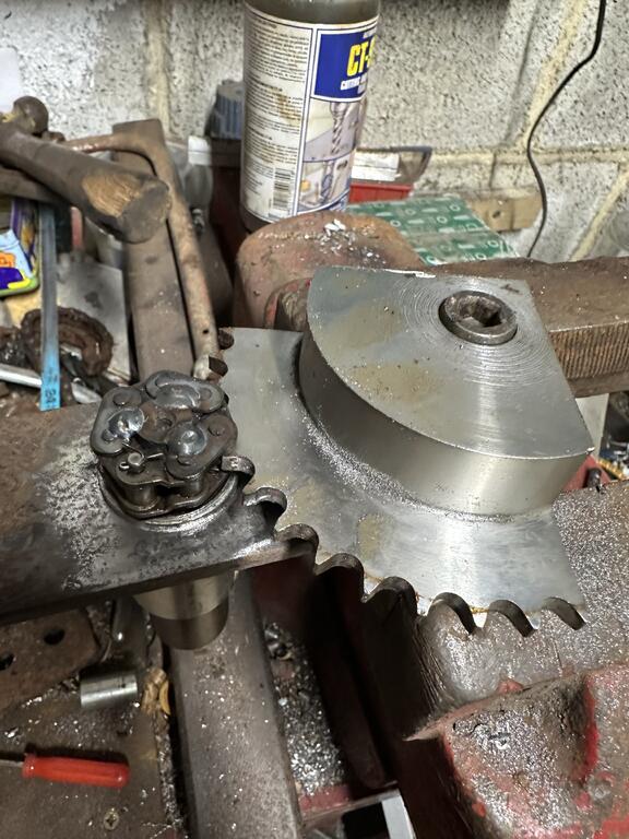

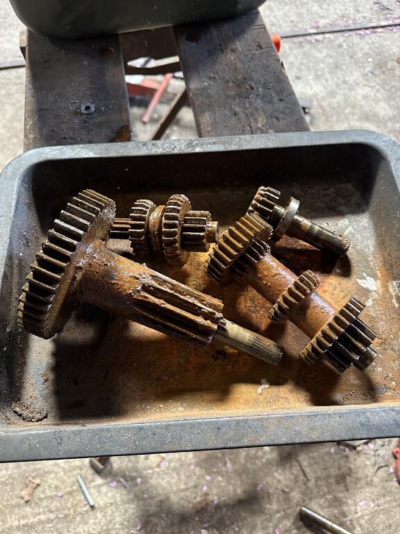

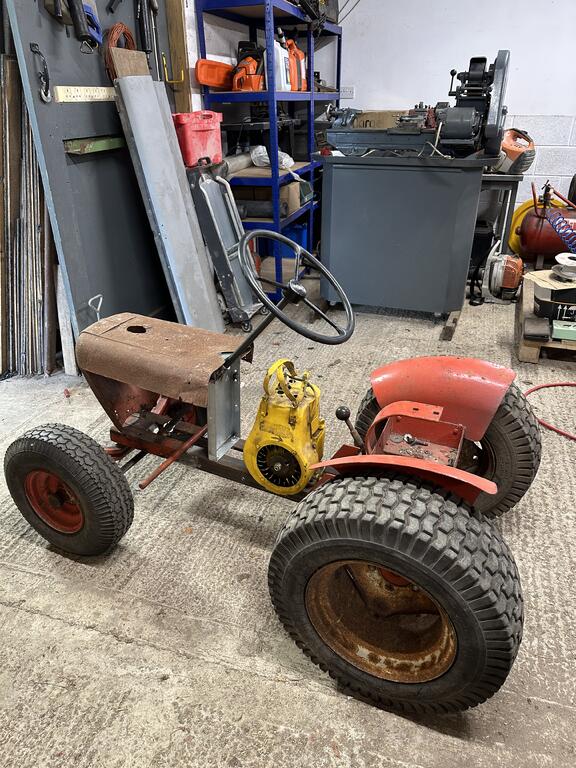

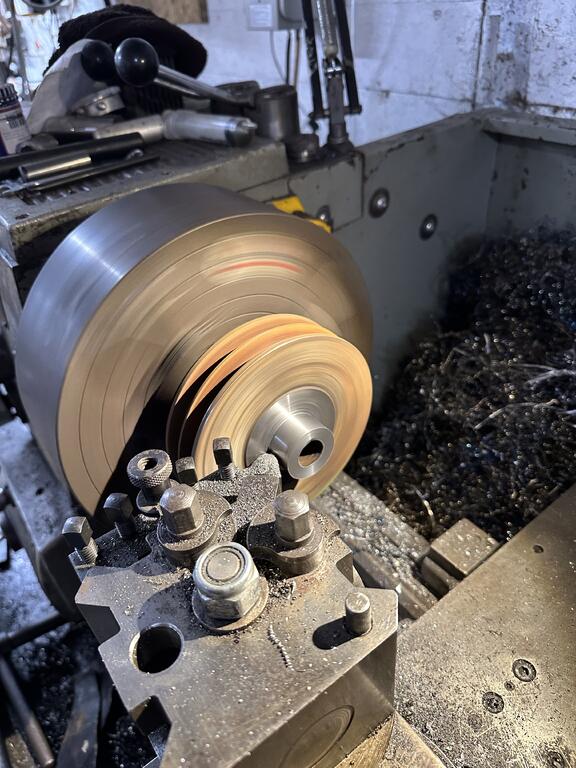

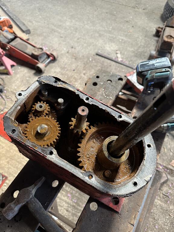

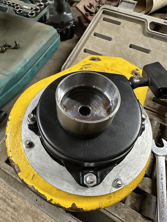

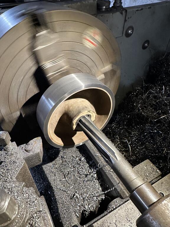

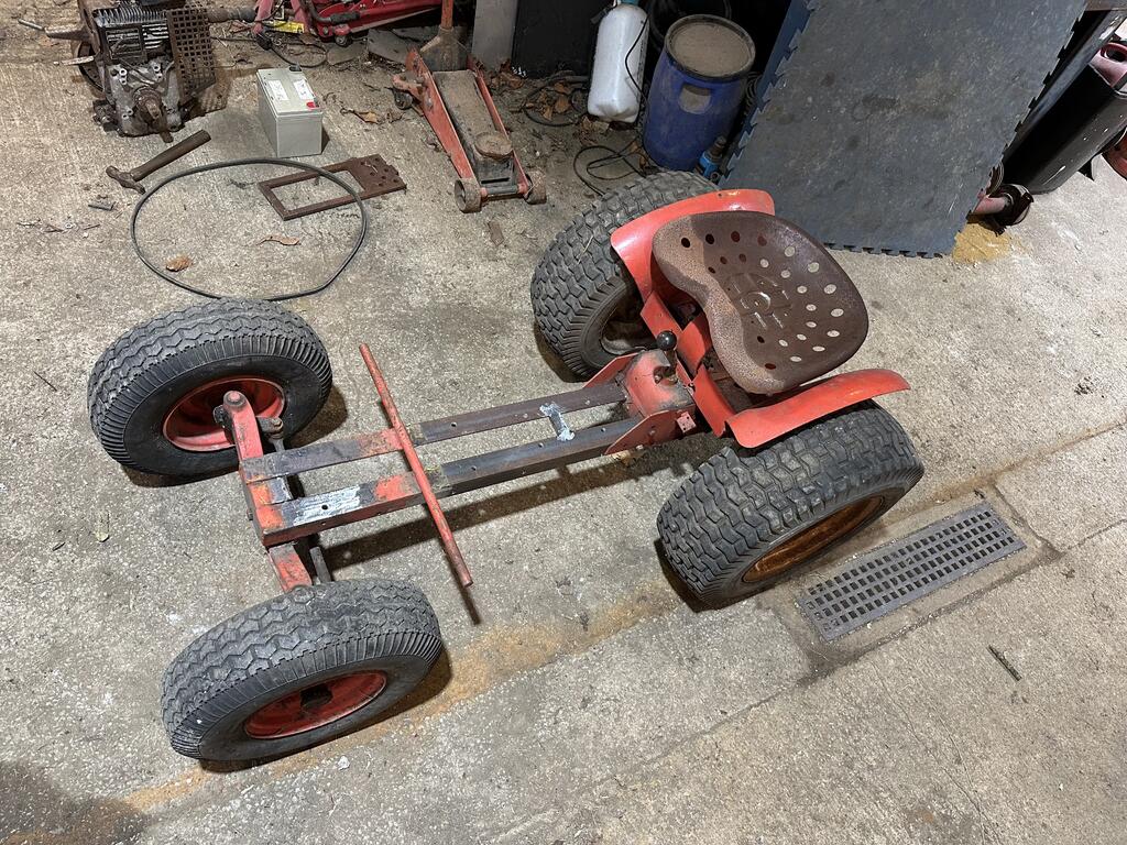

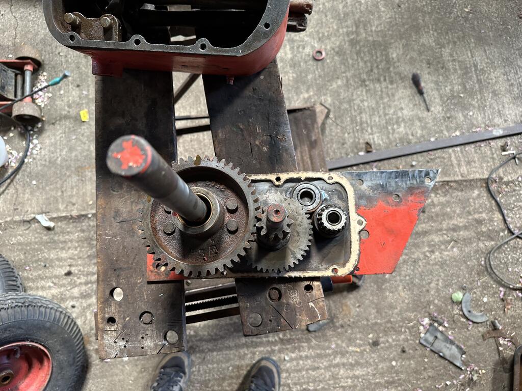

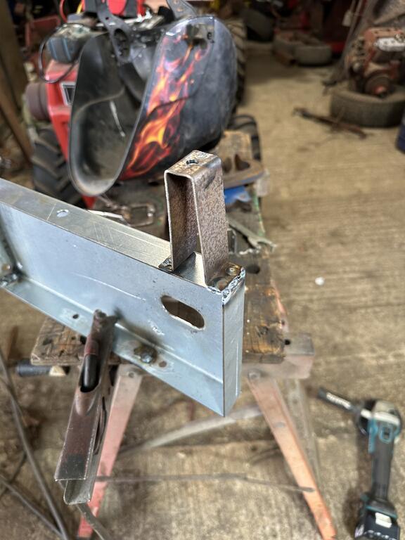

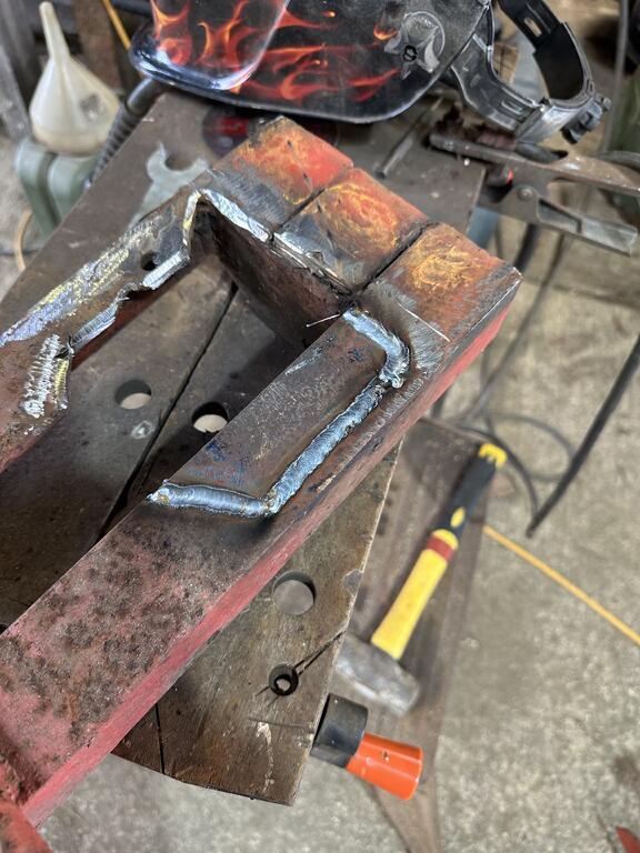

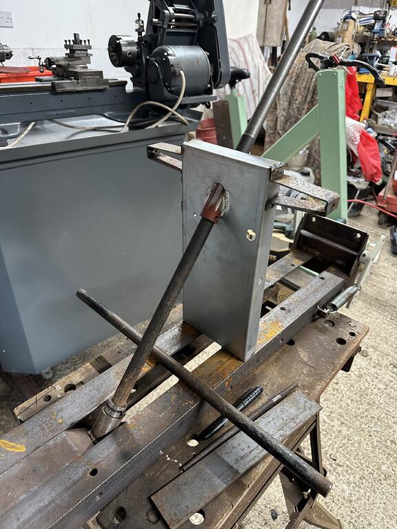

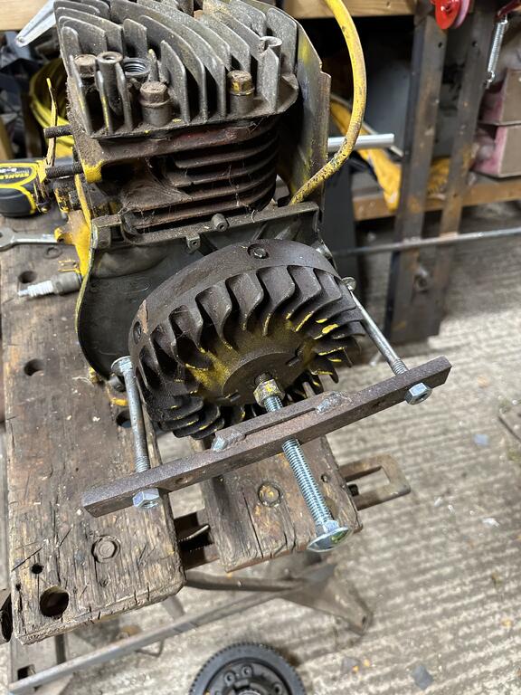

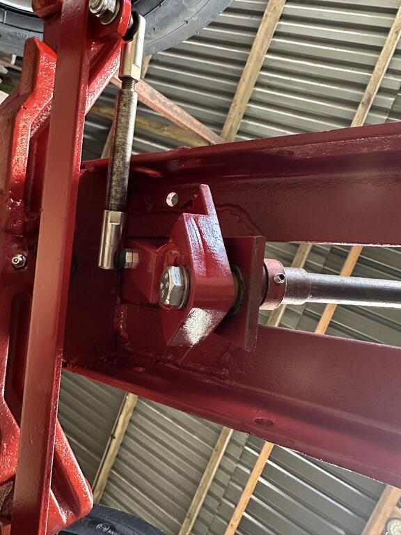

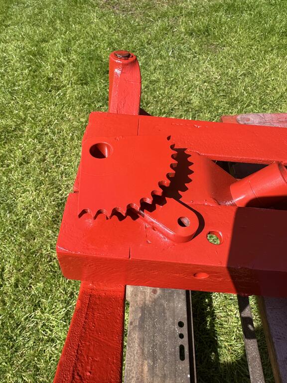

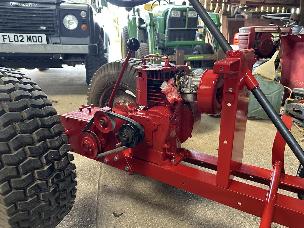

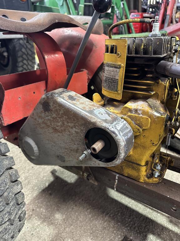

meadowfield 3,210 #1 Posted September 23, 2025 (edited) Not super rare, but equally they only surface once every six months and there’s a queue waiting to grab them! I managed to acquire a suburban 400 from a young lad who bought it then realised he couldn’t do anything with it! Had a very large Briggs engine fitted, a VW Beetle steering box and too many hacks to mention. he nabbed the narrow rears and left me with the rest! gearbox full to the brim with water! Interesting stretch chassis to take a Briggs engine. lots of chassis patching! rolling..... making a new hoodstand steering gears - same size and ratio as the original - but will outlast them! looking more like it onto that gearbox it was a mess, all the bearings were gone! they had chopped the bottom of the casing for some reason nearly together - amazon packaging to the rescue as a gasket done - with a modifed C series shifter onto the brake drum - I turned down and old cast pulley. reamed the inside to 3/4" all done - just the pedal and linkage to sort.... Ewan very kindly fired up the forge and made me a pedal. new brake/clutch pedal in place - I thought a bigger bush can't be a bad thing! donor Clinton engine didn't spark - home made puller did a reasonable job. Points cleaned up and all connections clean - we were in action! didn't have a pull start either - so made a start cup and used a new tecumseh pull start finally made two footrests to match. Hard work in the press, but a modified bolster chisel did the job! Finished - just needs the right steering wheel and hood! Does anyone have something that could be shipped to the UK? Edited September 23, 2025 by meadowfield 4 15 Share this post Link to post Share on other sites
oldlineman 1,821 #2 Posted September 23, 2025 Very nice work and weld, looks like your right leg won't get cold 4 3 Share this post Link to post Share on other sites
meadowfield 3,210 #3 Posted September 23, 2025 1 minute ago, oldlineman said: Very nice work and weld, looks like your right leg won't get cold thanks - longer pipe is on the way 1 1 Share this post Link to post Share on other sites
Pullstart 71,561 #4 Posted September 23, 2025 Those welds look better than robotic! Awesome work! 5 Share this post Link to post Share on other sites

stevasaurus 23,892 #8 Posted September 23, 2025 Outstanding work and thankyou for all of those pictures !! I think that transmission looked pretty good for all of that water that was in there. 3 Share this post Link to post Share on other sites
8ntruck 9,420 #9 Posted September 23, 2025 Nice work to bring that tractor back. Just curious - what is Ewan's last name - Smith? I like his forge set up. 2 Share this post Link to post Share on other sites
meadowfield 3,210 #10 Posted September 23, 2025 3 hours ago, 8ntruck said: Nice work to bring that tractor back. Just curious - what is Ewan's last name - Smith? I like his forge set up. Yes, that’s my son - you might have seen some of his work. 2 1 Share this post Link to post Share on other sites

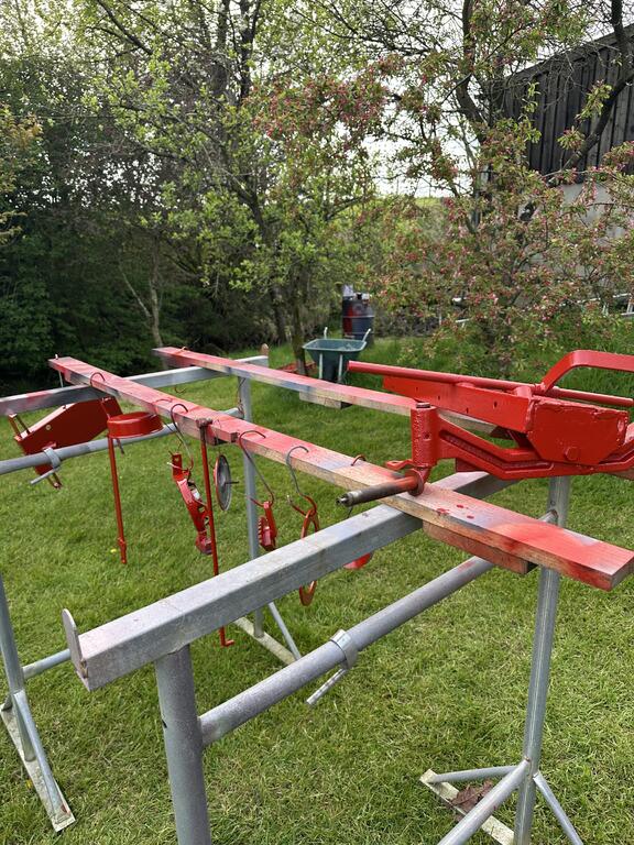

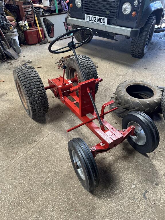

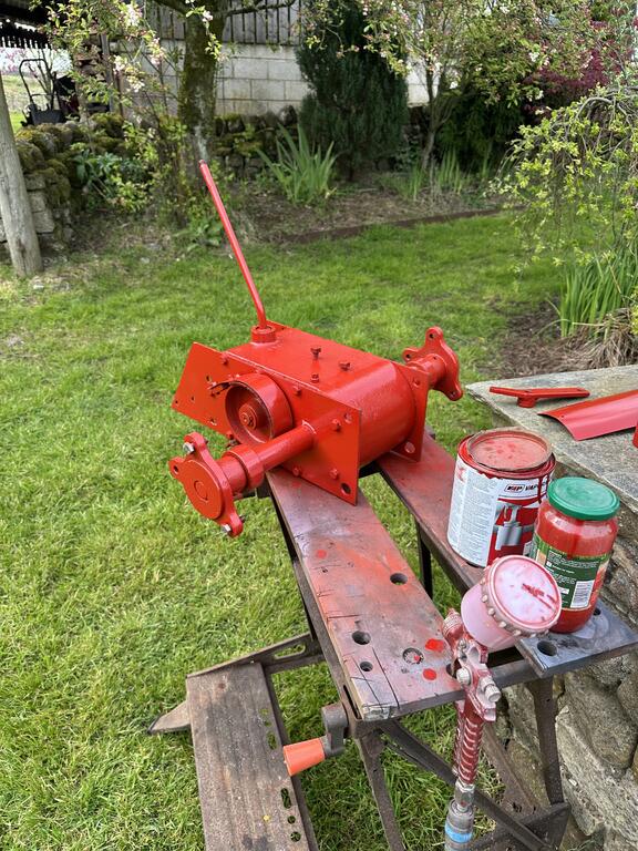

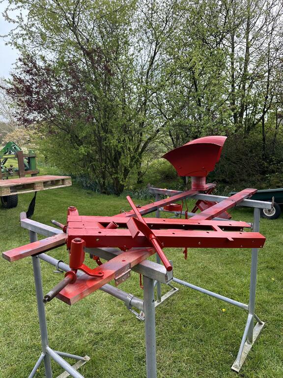

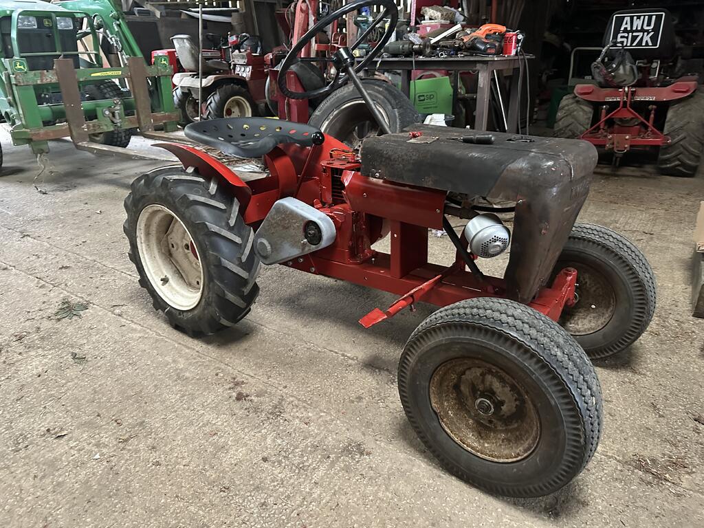

meadowfield 3,210 #16 Posted May 3 (edited) A bit further, it’s been good weather for painting! still looking for a hood, anyone up for chopping one in half and mailing me…. The UK Wheelhorse show is first week in June! Edited May 3 by meadowfield 6 Share this post Link to post Share on other sites

Treepep 1,151 #18 Posted May 3 A bit further, it’s been good weather for painting! Never thought of using marinara Looks great as always! 1 Share this post Link to post Share on other sites
kpinnc 19,107 #19 Posted May 3 (edited) 9 hours ago, meadowfield said: A bit further I had to go back through this thread for reference. Wow you have done alot of fabrication to get the Suburban to this point! And the work is spectacular! Well done! I hope you find a hood. Keep an eye on Ebay as well. Pricey I am sure, but you may get lucky. Edited May 3 by kpinnc 2 1 Share this post Link to post Share on other sites

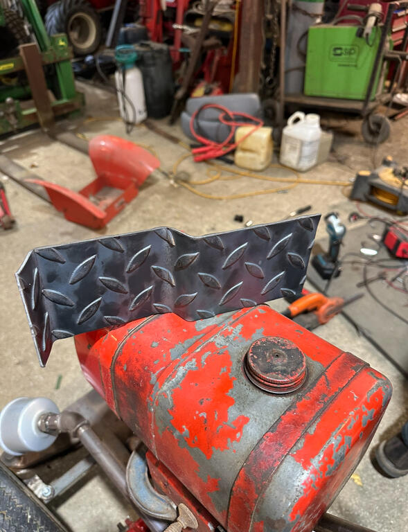

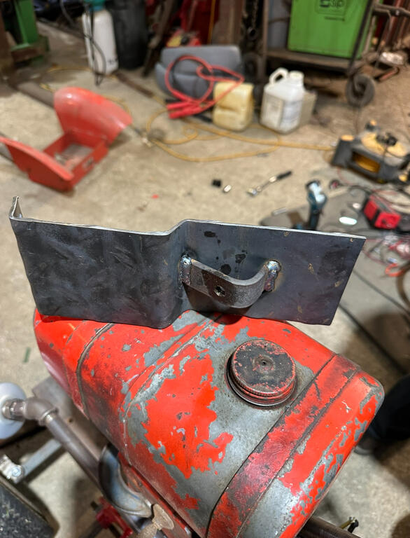

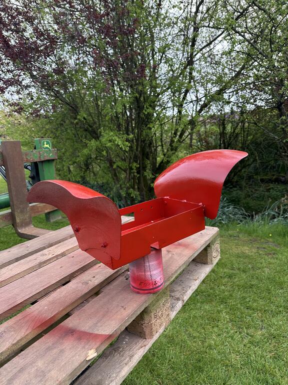

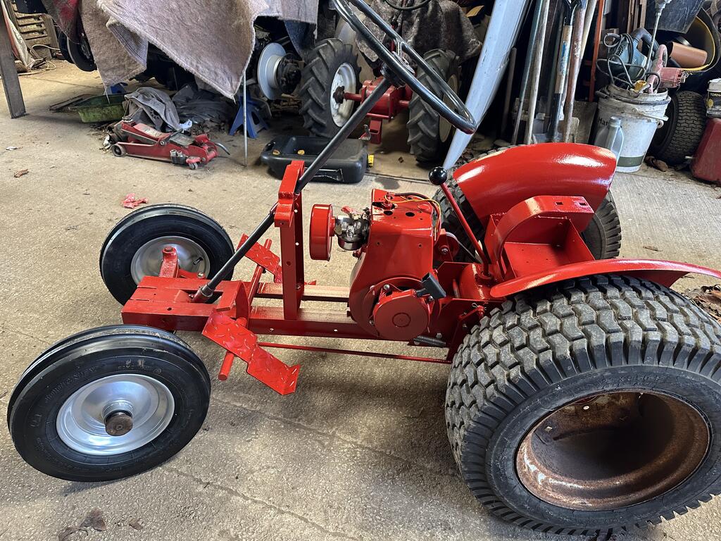

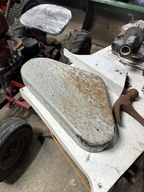

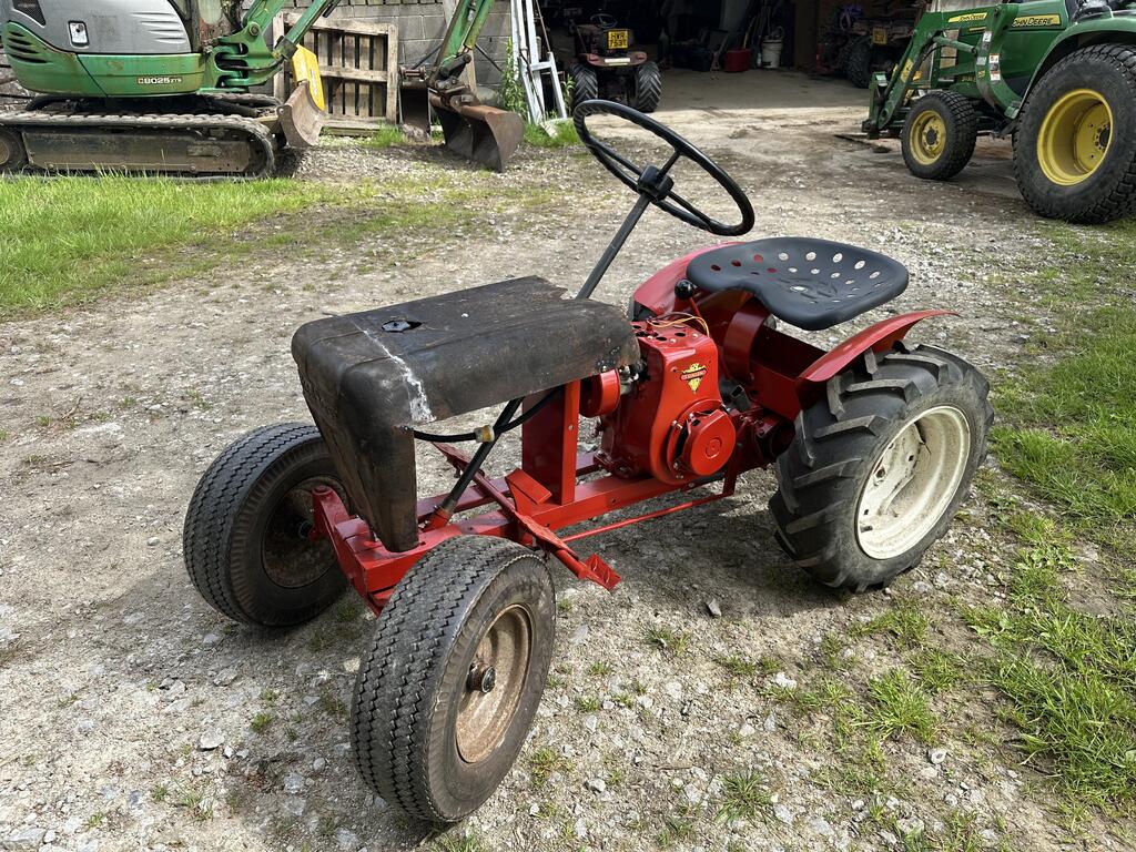

meadowfield 3,210 #21 Posted June 1 (edited) A bit more progress, made a belt guard and made the hatchet job hood fit for now…. The UK wheel horse roundup is in 4 days time! A piece of old tin shelf hammered around a former. Hole drilled and dimple pressed in. Hood has been in the e-tank and hammered into a shape that nearly fits. Belt guard and homemade heatshield in place too Edited June 1 by meadowfield 2 8 Share this post Link to post Share on other sites

meadowfield 3,210 #23 Posted June 2 17 hours ago, AlexR said: Are you planning on getting this tractor fully done for that? If so not now - I'm away with work for 3 of those days! so it goes to the show as is.... 100% functional - 80% cosmetic, still waiting for the right steering wheel (this one is a massey harris one) and a hood. 2 Share this post Link to post Share on other sites
953 nut 70,649 #24 Posted June 3 On 6/2/2026 at 4:27 AM, meadowfield said: steering wheel (this one is a massey harris one) Yes, it did appear to be just a little big for the RJ. You are doing an amazing job. 1 Share this post Link to post Share on other sites
