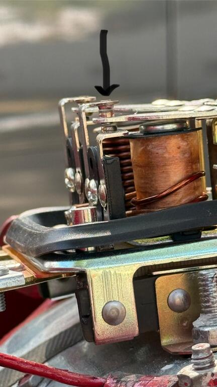

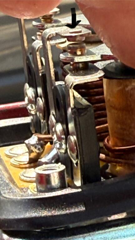

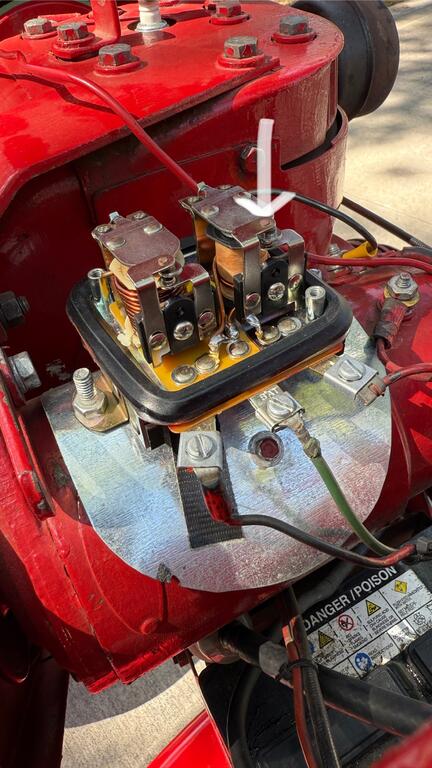

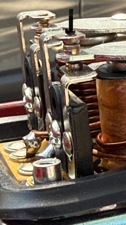

Al C. 1,480 #1 Posted September 22, 2025 (edited) My 1967 Wheel Horse T1067 developed an electrical problem last week. The generator light started coming on at full throttle. I did some testing. The generator was putting out plenty of volts. I opened up the regulator and noticed that one of the contacts was sparking when the generator light was on (see pictures and arrows). So I sanded the contacts lightly and adjusted the contact head so that the points made full contact at full throttle. The generator light now seems to be functioning normally. I have no idea why what I did seems to have fixed the problem, or why the problem started in the first place. Can anyone help me with an explanation? Have I potentially caused another problem down the road with my solution? Thanks! Edited September 22, 2025 by Al C. Share this post Link to post Share on other sites

adsm08 5,247 #4 Posted September 23, 2025 The regulator is just a series of electro-magnets and contact points. As the voltages change so do the strengths of the magnetic fields. This sets the voltage. It also causes the contacts to "float" ever fully in contact, or fully apart. This allows arcing. Arcing causes carbon build up. Carbon is not very conductive and will cause issues. Cleaning the contact points allowed for better continuity, and thus better operation. Depending on the grit of the sand paper used you may have removed some protective coating, but it may have also been burned off if there was enough carbon build up to cause issues. I'd run it and see if any new issues crop up before replacing it. 3 Share this post Link to post Share on other sites
Handy Don 17,735 #5 Posted September 23, 2025 (edited) You went to the right place and did the right thing as the first step! The WH “generator” light illuminates when the engine is running and voltage being put out by the charging system is less than what is already in the battery. The WH regulator really does two jobs: - connects the generator to the battery only once it is putting out more than 12v (electromagnet #1’s contacts) and - regulates the voltage that is charging the battery (“floating” electromagnet #2’s contacts). it’d be a good idea, if you can, to confirm that the charging voltage is now in an acceptable range. After the engine has been running for a few minutes, set the speed to about half-throttle and use a voltmeter to check across the battery terminals. Ideally, it should be between 13.5 and 14.5 volts. Edited September 23, 2025 by Handy Don 2 Share this post Link to post Share on other sites
