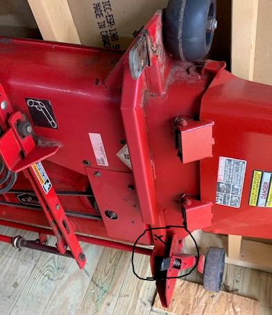

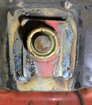

JoeM 10,081 #2 Posted September 21, 2025 9 hours ago, RED-Z06 said: Was the power steering on them pretty strong, reliable? I have several and the power steering has been real good. I have the FEL on a power steer xi now for 5 years no issue and I use it a lot especially with the forks. One issue on the xi machines is the front axle pivot. if it has not been serviced. chances are it needs some work. The pivot shaft wears the front hole egg shaped. Not a bad repair but none the less a place to look. pull-start has a much more elaborate repair on a thread, I just plated the front of the frame and tightened it up nicely. on the 52 inch deck the place to look is on the discharge side. they crack in this area circled. I reinforced this during the repair with a square tube. That deck cuts the nicest of all that I tried, it has a lot of lift. The 522xi without a deck weighs in just north of 800, A good heavy machine. As most WH's the rear hub keys can be another place to look. I have several and my kid runs one and I think these machines was WH best kept secret. Very comfortable to drive and run. 1 Share this post Link to post Share on other sites
peter lena 9,939 #3 Posted September 21, 2025 @JoeM take advantage of what works , enhance it , another vital part of those is structural stress cracking , as you know , looking at that deck area , spindle belt return , easy spot for an added idler pulley , the belt bounce , eats bearings , that bounce is also related to incremental bearing hang up , caused by wrong lubrication in bearings . good improvement spot , pete Share this post Link to post Share on other sites

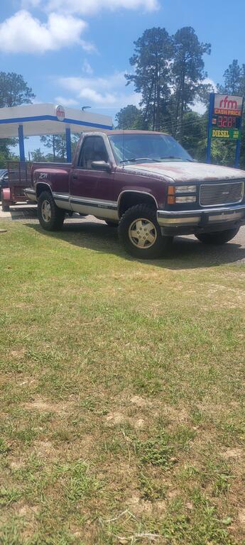

RED-Z06 2,718 #4 Posted September 21, 2025 (edited) My problem isnt the tractor, or the money...its just not wanting to get stranded 3 counties away with a trailer. I love my 94 Sierra, ive had it now for 15 years, when i got it, it had a new GM Crate 350, everything on the engine was new...water pump, compressor, fan clutch, pulleys, radiator. In 2016 i had the trans fully overhauled...and in 2021 i rebuilt both driveshafts. 3 weeks ago..it lost its brakes, never fully explained it but after refilling the fluid and some bleeding the brakes have been fine. Last week, left home and..a mile up the road.."check gages"...water at 240⁰. Now, i check my water, oil, atf..religiously every 2 weeks and it was full a week prior. The back cover on the water pump had a thin spot..no rust or pitting, it just failed and emptied out my water. Replaced the pump on Friday and ive driven it 30ish miles since. Its just..its not unreliable, its just going through some stuff right now🤣. Its times like this i wish id kept my K3500 but it sat 99% of the time. Edited September 21, 2025 by RED-Z06 Share this post Link to post Share on other sites
