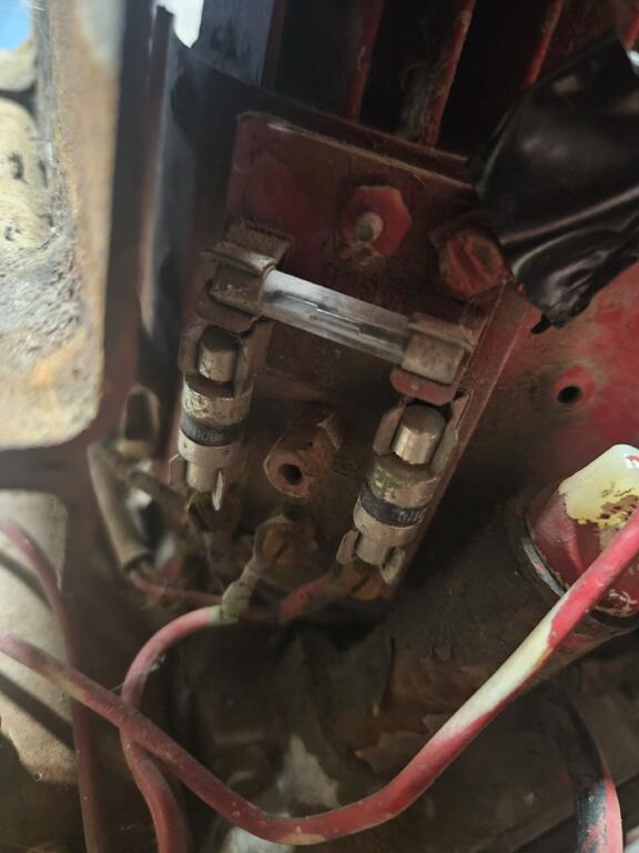

rmaynard 17,659 #4 Posted September 20, 2025 Can you give us a picture of the fuse box in question? Share this post Link to post Share on other sites

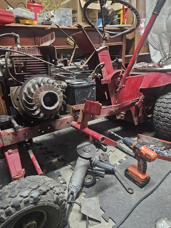

red baron 1 #5 Posted September 20, 2025 Im not getting fire so i pulled the flywheel off andchecking condition of stater any recomonditions Share this post Link to post Share on other sites
rjg854 13,454 #6 Posted September 20, 2025 @red baron The first thing to start with would be cleaning up all your connections. Be sure all of them are nice and clean, and your grounds are good. Share this post Link to post Share on other sites
pfrederi 21,342 #7 Posted September 20, 2025 The "Fuse Box" is really a set of diodes and a fuse that are the battery charging system. It does not affect the ignition (spark) You can download the service manual for the engine here click on picture 2 Share this post Link to post Share on other sites
