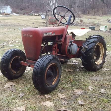

WHGuy413 2,859 #1 Posted September 17, 2025 I have dug my original rj with the hopes to get it running for a cool rides car/tractor show at my boys school in a couple weeks. I went to pull it over and the recoil is stuck hard. No movement at all. It’s not the engine that spins easily just like it should. I’ve taken all the little pieces off to try lift the part that the rope wraps to and it wont budge. I’ve got it soaking in pb blaster. Anyone have any suggestions to get it freed up? Old picture of the tractor for attention too. Share this post Link to post Share on other sites
