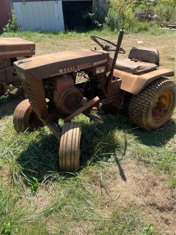

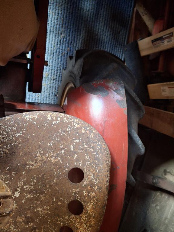

terc 27 #1 Posted September 17, 2025 Hello All I recently picked up a barn find commando 8. I'm still trying to decide what I want to do with this tractor, Since the body parts have lost most of the paint color, I need to get started with the 8hp Kohler engine, that may a deciding factor as to what I do with tractor There are no rust holes only the sheet metal has a lot of surface rust. So what do you guys say about this tractor. 4 1 Share this post Link to post Share on other sites
WHX?? 58,136 #2 Posted September 17, 2025 It's got good bones. 3 Share this post Link to post Share on other sites
ebinmaine 80,709 #3 Posted September 17, 2025 S/G engine with stirrups on a Commando?? Must be a very early one... I'll bet there's more red paint under there than one might think. 2 Share this post Link to post Share on other sites
terc 27 #4 Posted September 17, 2025 ebinmaine - I guess the big question is how or what do i use to find out how much paint is under that current patina. I have always accustomed to using a wire brush then spraying with a rusty metal primer. If its not a lot of work I would like to save whatever is there, just have never done that process 1 Share this post Link to post Share on other sites
WHGuy413 2,859 #5 Posted September 17, 2025 27 minutes ago, ebinmaine said: S/G engine with stirrups on a Commando?? Must be a very early one... I'll bet there's more red paint under there than one might think. @WheelHorse_Kid has a Commando 8 with s/g and stirrup foot rests. 17 minutes ago, terc said: ebinmaine - I guess the big question is how or what do i use to find out how much paint is under that current patina. I have always accustomed to using a wire brush then spraying with a rusty metal primer. If its not a lot of work I would like to save whatever is there, just have never done that process I would suggest a deep degrease and a gentle pressure washing first. Some guys have had success with a light wet sanding. I haven’t tried it on anything yet. 4 Share this post Link to post Share on other sites

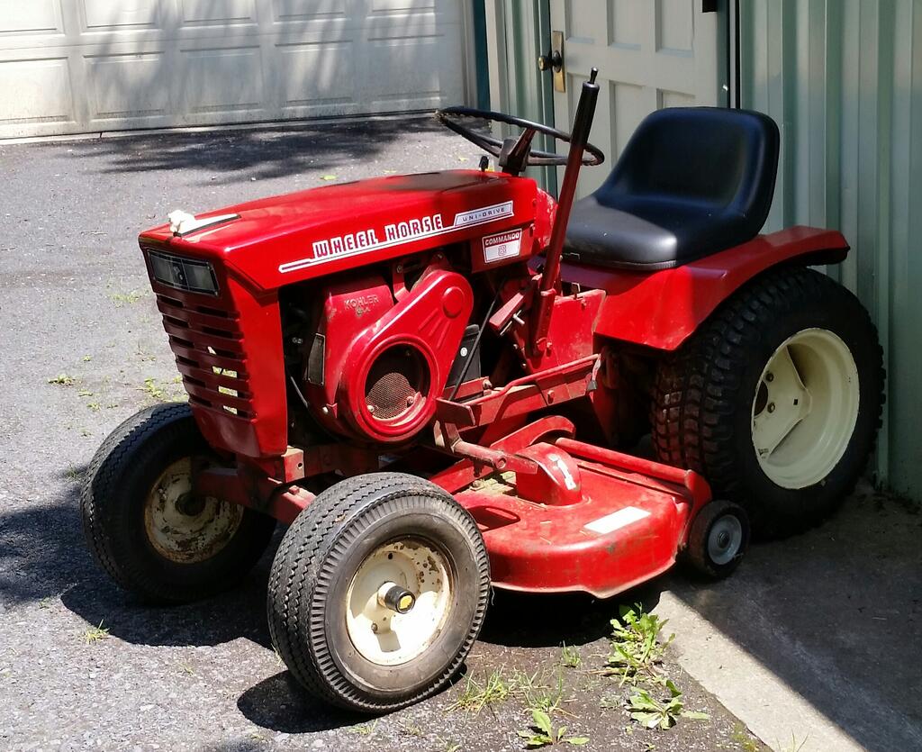

Pullstart 71,250 #8 Posted September 17, 2025 (edited) You’d be blown away at how much paint is still under all that rust! 600 grit wet/dry paper and some dish soapy water. Easy gentle strokes forward and backward. Keep it wet. Avoid the radiuses too much, they will wear faster. Go slow and check your results occasionally. Here is an example, this one was about as rusty as well. We also ran a little buffing compound across it at the 2018 Big Show too. Edited September 17, 2025 by Pullstart 2 1 Share this post Link to post Share on other sites

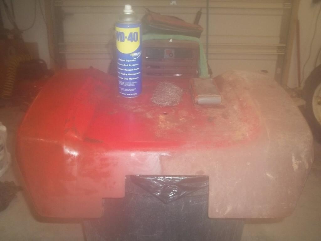

953 nut 69,315 #10 Posted September 17, 2025 I have used steel wool, 400 wet/dry sandpaper on a flexible sanding block, and WD-40 to bring back the red that is hidden under the rust. Regardless of the type of abrasive (scotch-brite, wet dry paper, steel wool) use a random pattern and light downforce when you work large areas like the hood and fender pan. If you go diagonally (left front to right rear alternating to right front to left rear) your strokes will less noticeable. 2 Share this post Link to post Share on other sites

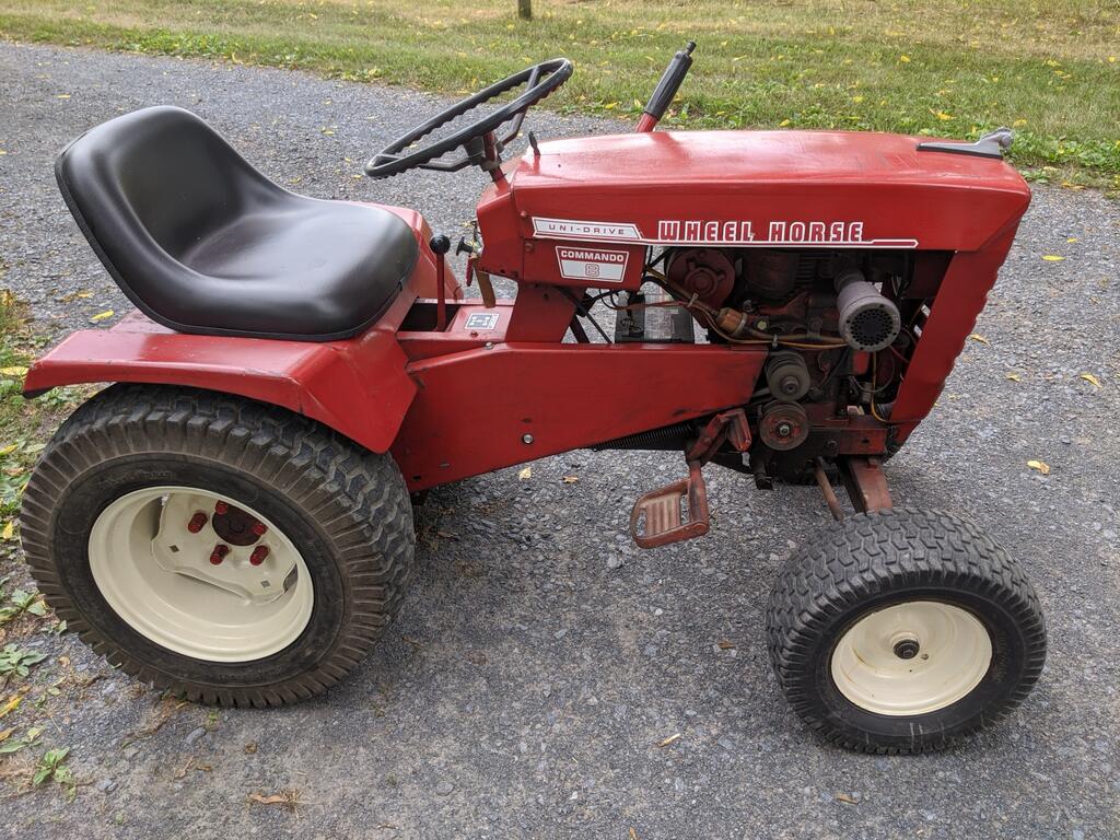

rjg854 13,359 #13 Posted September 17, 2025 13 hours ago, ebinmaine said: S/G engine with stirrups on a Commando?? Must be a very early one... both of my Commandos are like that 3 Share this post Link to post Share on other sites
WHGuy413 2,859 #14 Posted September 17, 2025 4 hours ago, Pullstart said: You’d be blown away at how much paint is still under all that rust! 600 grit wet/dry paper and some dish soapy water. Easy gentle strokes forward and backward. Keep it wet. Avoid the radiuses too much, they will wear faster. Go slow and check your results occasionally. Here is an example, this one was about as rusty as well. We also ran a little buffing compound across it at the 2018 Big Show too. I remember that tractor well! After you bought it it looked like a whole new rig. 2 Share this post Link to post Share on other sites

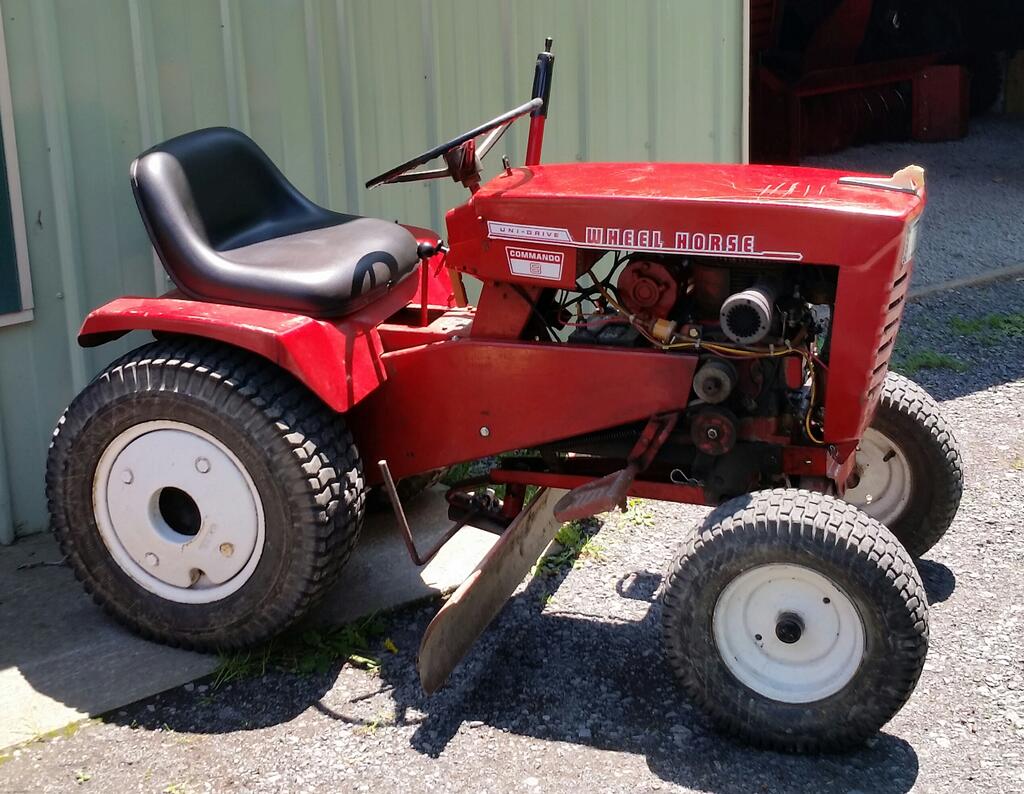

rjg854 13,359 #19 Posted September 17, 2025 51 minutes ago, ebinmaine said: Is a Commando Short frame or long frame? 5 Share this post Link to post Share on other sites

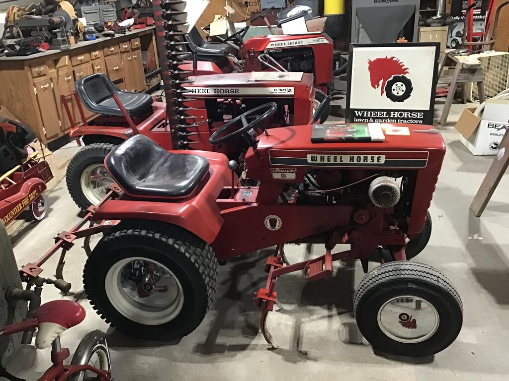

c-series don 12,447 #20 Posted September 17, 2025 Here’s my Commando, with the wrong hood decals! 2 Share this post Link to post Share on other sites

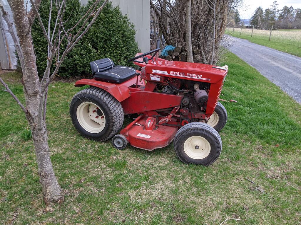

Retired Wrencher 6,989 #21 Posted September 19, 2025 On 9/16/2025 at 8:48 PM, terc said: ebinmaine - I guess the big question is how or what do i use to find out how much paint is under that current patina. I have always accustomed to using a wire brush then spraying with a rusty metal primer. If its not a lot of work I would like to save whatever is there, just have never done that process Terc: I would just clean everything with some gas make sure there’s no oil or grease anywhere one part at a time. And I always choose Marvel mystery oil with a rag and wipe all metal parts down. wipe off excess. This bring back the patina that is there. There are other methods, but I find this much easier. Just take your time with it and you’ll be happy. This is how mine came out. 1 1 Share this post Link to post Share on other sites

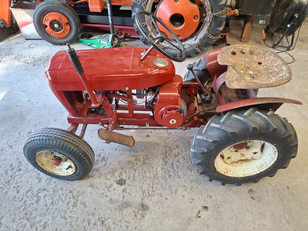

WHX?? 58,136 #24 Posted September 19, 2025 On 9/17/2025 at 8:51 AM, rmaynard said: No matter what you put on it, rust will continue to slowly eat away at the metal. I agree with everything Bob but that statement. If you take away the oxygen the rust will stop. Say by coating with grease or oil or even WD-40. We have this discussion every year at plow day about our shares & lots of guys just use WD and it seems to work. Funny no one has mentioned boiled linseed oil. Now I have only used it one or twice but it seems to work. It dries and protects put it does attract dust which usually washes off in mild soap and water. It leaves a dull patina which I prefer. I believe patinas shouldn't be shiny unless a custom. It probably should be reapplied every so often. This 400 was done with it. On 9/17/2025 at 4:46 PM, c-series don said: with the wrong hood decals! There is no such thing as wrong decals Don .. unless they say JD ... Nice tractors this thread fellas ... 1 1 1 Share this post Link to post Share on other sites
