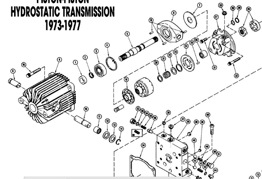

Krice58 176 #1 Posted September 16, 2025 I recently had a leaky gasket on the drivers side of the hydro where the hydro motor sits behind the rear wheel, and in order to do so you had to take off the motor cover, the 4 Allen head bolts and the 4 mounting bolts. In addition you had to remove a snap ring as well as an open ball bearing. After changing the mounting gasket and reassembly, I got nothing. Tractor won’t move in either direction, and hydro lift doesn’t work. Everything was functioning before. I did lose fluid when I opened it up so I did top it off but to no avail. Free wheel valve is closed, parking brake isn’t stuck. I’m lost. Help! Share this post Link to post Share on other sites

pfrederi 21,046 #5 Posted September 17, 2025 (edited) Motor in the picture is on correctly.. Is the pump input shaft spinning with the pulley? No lift means the charge pump is not working Edited September 17, 2025 by pfrederi 1 Share this post Link to post Share on other sites

pfrederi 21,046 #13 Posted September 18, 2025 Remove #37 pour in your fluid till it over flows and try again operate the lift..may have to repeat 2 Share this post Link to post Share on other sites
