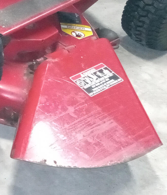

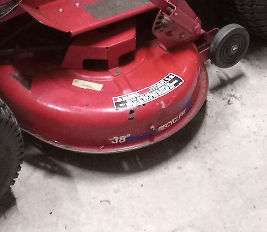

OldNoob 27 #1 Posted September 14, 2025 There's one spot in my yard where i have to mow pretty close to the edge of a ditch. Every time i do it it involves a lot of leaning and fear of topping over. Every time i think it would be nice if i had a wider deck and i wouldn't need to get so close to the ditch. Has anyone ever upgraded a 38" side shoot to a 3 blade 48"? I'm guessing the mounting arrangement is a bit of an issue. Share this post Link to post Share on other sites

Brockport Bill 2,478 #3 Posted September 15, 2025 7 hours ago, OldNoob said: There's one spot in my yard where i have to mow pretty close to the edge of a ditch. Every time i do it it involves a lot of leaning and fear of topping over. Every time i think it would be nice if i had a wider deck and i wouldn't need to get so close to the ditch. Has anyone ever upgraded a 38" side shoot to a 3 blade 48"? I'm guessing the mounting arrangement is a bit of an issue. i don't believe there is a "38 side chute" so not sure what model deck you actually mean? WH had a 36, and 42 rear discharge -- plus a 37 side discharge ( that has a very different configuration with above the shell spindle pulley units ) , also a 42, 48 and 60 side discharge? Frankly, can't magine how deck shells would be re-fabricated to be a bigger wider shell ? Why not simply get a wider next larger size wh mower deck? 1 Share this post Link to post Share on other sites
953 nut 69,341 #4 Posted September 15, 2025 @OldNoob, I see on your profile that you have a 210-5. That is a vertical crankshaft engine lawn tractor and the attachments from the larger garden tractors will not fit without significant modification. Also, a 48" mower deck would be a lot to ask of a ten horsepower Briggs and Stratton. 1 Share this post Link to post Share on other sites

Brockport Bill 2,478 #6 Posted September 15, 2025 Didn't realize you were referencing a 200 series lawn mower....i assumed you owned a 300, 400 or 500 garden tractor model to wsnt to operate a 48 inch deck? 2 Share this post Link to post Share on other sites
