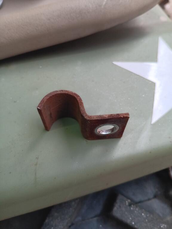

ebinmaine 77,976 #1 Posted September 14, 2025 This goes under the feets steps on a C series or newer. 1 Share this post Link to post Share on other sites
stevasaurus 23,657 #3 Posted September 14, 2025 ACE or any hardware store has them. Used to hold cable, wire, tubing in place. You could probably get what you need off any telephone pole. With all of the granite in Maine, they may be in your back yard on any pole. 4 Share this post Link to post Share on other sites
ebinmaine 77,976 #4 Posted September 14, 2025 7 minutes ago, squonk said: Clamp Good job Mike. 4 Share this post Link to post Share on other sites

ebinmaine 77,976 #6 Posted September 14, 2025 2 minutes ago, squonk said: I looked up my c-160 parts diagram on Jacks. Of course they don't show the clamp. I appreciate the effort though! 1 Share this post Link to post Share on other sites
wallfish 19,539 #7 Posted September 14, 2025 You can find them in the electrical section for conduit clamps 9 Share this post Link to post Share on other sites
squonk 45,899 #8 Posted September 14, 2025 #7456 Bracket. I'm sure A-Z has a pail full 3 Share this post Link to post Share on other sites
Blue Chips 710 #9 Posted September 14, 2025 (edited) You might have a look at this site: https://kugelkomponents.com/product-category/line-clamps/single-line-clamps/ I don't know if they sell individual ones. Prices are for a multi-pack. Note: These are stainless steel clamps. For my tractors, Toro just calls it a 'foot rest bracket.' Edited September 14, 2025 by Blue Chips Added detail. 2 Share this post Link to post Share on other sites
gwest_ca-(File Mod) 12,092 #10 Posted September 14, 2025 EMT tubing has odd diameters. 1/2" is .706" OD and 3/4" is .922" OD and the clamps fit accordingly. I'll guess the one you want is for 3/4" round bar. The 1/2" clamp should work. Commonly called a one hole strap. 4 Share this post Link to post Share on other sites
953 nut 64,856 #11 Posted September 14, 2025 1/2" Ridged electrical conduit has an outside diameter slightly over 3/4" and the clamps are made of heavier material. A bag of 5 cost less than $ 2.00 at the big box stores. https://www.lowes.com/pd/Sigma-Electric-ProConnex-1-2-in-One-hole-Strap-Intermediate-Metal-Conduit-Compatible-Galvanized-Rigid-Conduit-Compatible-Rigid-Metal-Conduit-Compatible-Conduit-Fitting/1000152549?store=717&cm_mmc=shp-_-c-_-prd-_-elc-_-ggl-_-CRP_SHP_LIA_ELC_Online_Mid_Priority(E+Band)_Omni-_-1000152549-_-local-_-0-_-0&gclsrc=aw.ds&gad_source=1&gad_campaignid=22867870040&gbraid=0AAAAAD2B2W97pEK6Dx69ZOiriDUVQ8XeP&gclid=CjwKCAjwz5nGBhBBEiwA-W6XRHKXVhha5lgVGfw3jClJatCIXIxjmkH4cqZBgmPIXmtiLxdzr92_mRoCOOMQAvD_BwE 3 1 Share this post Link to post Share on other sites
c-series don 11,759 #12 Posted September 14, 2025 @ebinmaine if you are looking for the factory correct ones I think I have some I can send you. Text me if you want them. 1 2 Share this post Link to post Share on other sites
oldlineman 1,663 #13 Posted September 15, 2025 953 nailed it we called them oneyed pipe straps for rigid pipe or conduit 5 Share this post Link to post Share on other sites
1968Commando 171 #14 Posted September 15, 2025 7 hours ago, ebinmaine said: This goes under the feets steps on a C series or newer. Conduit clamp 1 Share this post Link to post Share on other sites
Racinbob 12,878 #15 Posted September 15, 2025 (edited) Halex 1/2 in. Rigid 1-Hole Strap (4-Pack) 96111 - The Home Depot A little fine tuning will be needed. Get the ones for rigid pipe. The big box store straps for EMT are lighter. These days I've noticed that even the rigid straps are sometimes lighter. Edited September 16, 2025 by Racinbob 2 2 Share this post Link to post Share on other sites
gwest_ca-(File Mod) 12,092 #16 Posted September 15, 2025 1/2" rigid conduit has an OD of .840" 3/8" rigid conduit has an OD of .675" - Did not know there was such a thing 4 Share this post Link to post Share on other sites
