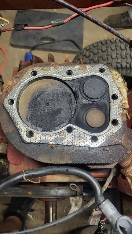

Engine is out of the tractor, I see what looks like an impression of the spark plug ground on the top of the intake valve. Exhaust manifold is looking like some sort of BIP frankenstein assembly. Have spare carb, carb rebuild kit, fuel pump rebuild kit.

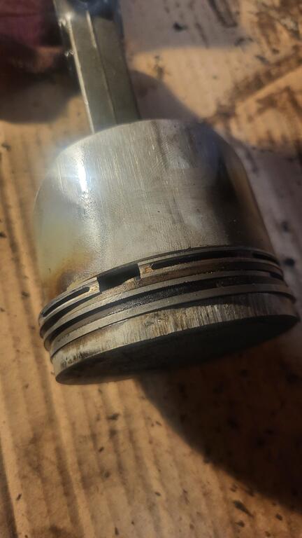

Alrighty, so, I'm wondering what this wear on the top of the piston is from? I think it's only on this side.

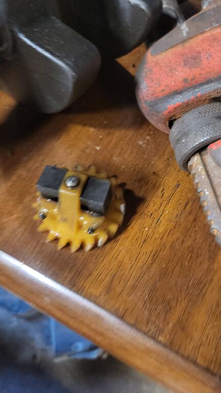

The roll pin and stop pin are hitting the governor gear.20250918_180138.jpg.881089d20f71c8e410fb7855b5a1eaf0.jpg

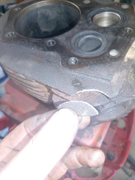

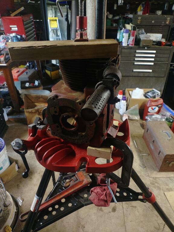

Chipped a fin getting the BIP homemade exhaust manifold off. Had to strap it to a pipe vise table, heat with a torch and use a cheater on a 18" pipe wrench to get it off. Chipped the fin when the pipe nipple finally broke loose. Maybe I should have just cut it out. It's not a bad chip and the head should mostly hide it. Just hate it happened.
Block is now at the shop.
Shop agreed bore .010 over.

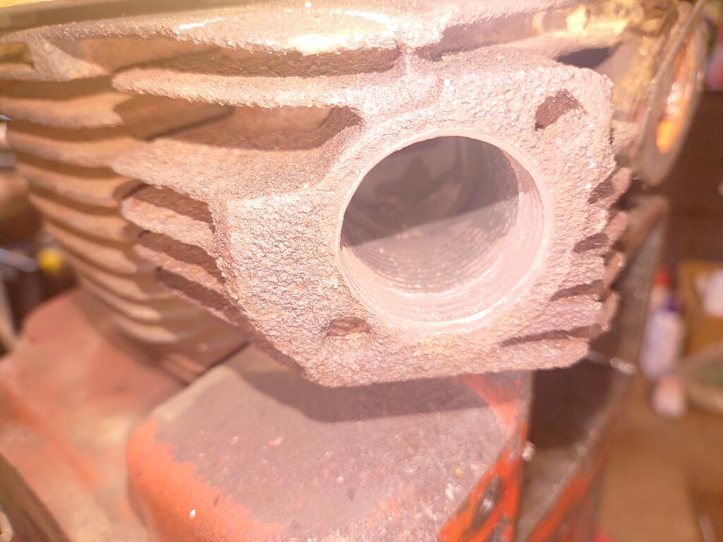

Pic of the exhaust outlet face.

What should the original exhaust manifold look like?
What you removed looks like the factory set-up, short nipple, 45,  another nipple about 3" long and a screw on muffler.

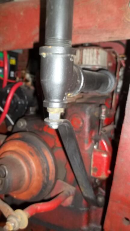

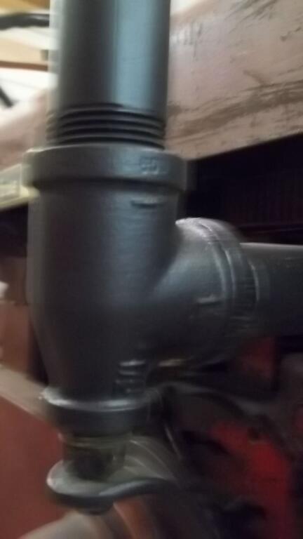

vertical stack with a weather cap
I did that when I first got the GT-14 a dozen or so years back, keeps the exhaust gasses out of my face. Having a brace under the pipe helps too.

BurtB
@953 nut now that's slick. How did you brace it?

I'll have to wait until I get the block back but we're totally doing the stack. Should be able to clean up the exhaust manifold face on the block, may need to helicoil the holes. Ask the machine shop to run a 1" pipe tap through the internal threads.
The exhaust is one inch Black iron pipe that screws into the engine block. The transition from horizontal to vertical is made with a black iron 1  ' X 1/2" X 1" T fitting. A 1/2" pipe plug was drilled and taped to 1/4-20 to secure the upper end of a brace that goes to the engine mounting bolt.

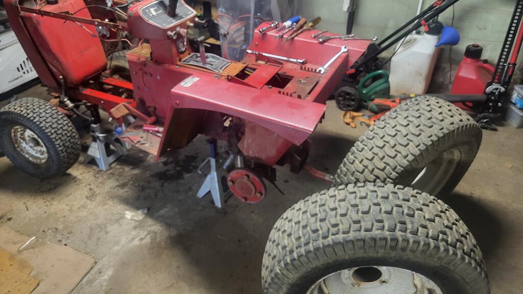

Panels have been taken off to access the transmission. The transmission will be took off tomorrow. Engine is currently in the shop, being re-bored, possibly will take ~2 weeks.

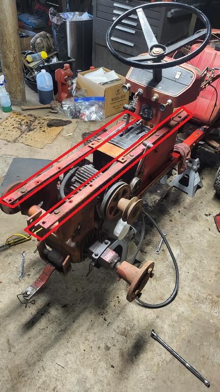

10 hours ago, Strudel said:
we're planning on separating the pump from the transmission to get the transmission out.
If you remove the two frame support bars outlined in red below there is no need to pull the pump.
  • Like 1
  • Thanks 1
BurtB
That is very helpful.
So, would the best way be to:
Pull those bars.
Put a jack under the transaxle/pump assembly.
Pull the 8 bolts holding it to the frame.
Lower it when free.
I'll add some picures later today before we try to pull it. I also have a question about the Nylon control plate slider thing and the tapered screw/pin that is part of the linkage.
953 nut
I'll add some picures later today before we try to pull it. I also have a question about the Nylon control plate slider thing and the tapered screw/pin that is part of the linkage. The ball on the motion control will slide out of the nylon plate.
Pull those bars.  Once the bars are out the four bolts holding the rear portion of the frame can some out and remove it. Put the bolts back in the holes to keep dirt out.
Put a jack under the transaxle/pump assembly.   I prefer jacking up the frame, block it up securely, then using an engine hoist to lift the transaxle but if you don't have one then I would take the time to build a dolly to transport it with. Much safer and easier to move the transaxle around the shop.
Pull the 8 bolts and hoses holding it to the frame. The bolt on the lower right side is the most difficult to remove so do it first while the other three are holding all the weight.
Lower it when free.

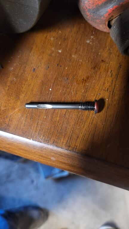

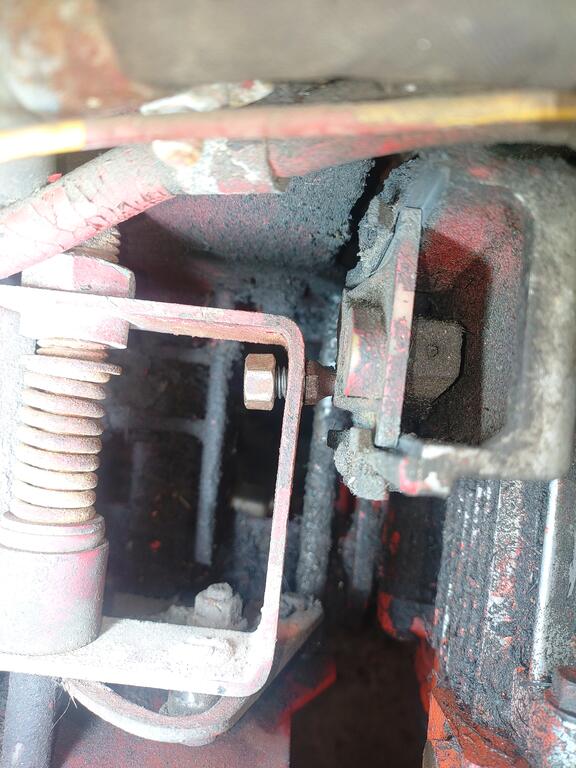

Pic attached of the ball on the motion control plate. Nut is backed off but it is firmly in the plate.
Also, this is not a 90-2062 unit, nameplate shows 90-2070.

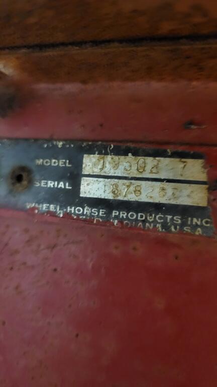

By the MN, tractor is a 72 or 73.
Tractor is MN: 1-0502 7 SN: 878267. Engine is MN: K321S Spec: 60149c, SN: 4050020. Transmission is MN: 90-2070 SN: 01-LA 32074
Just an update, transmission/axle is off the tractor and on a dolly. Have started a new thread in transmissions about it as this will probably get involved as I track down o rings, cut gaskets, and re-surface parts.
