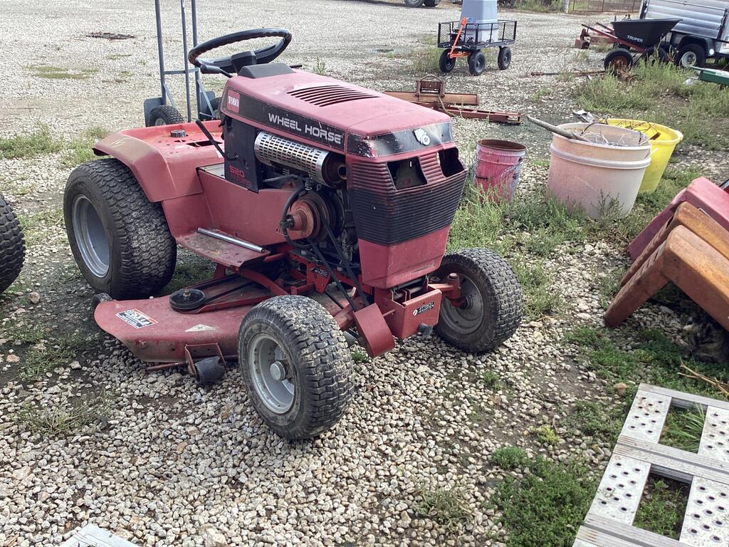

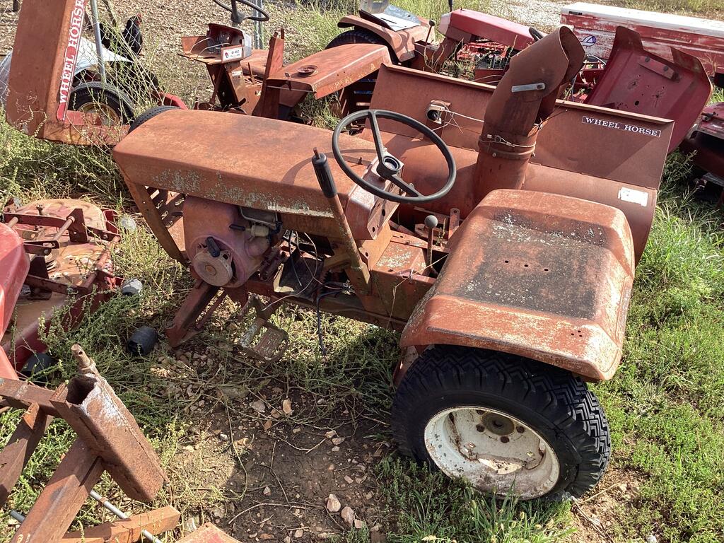

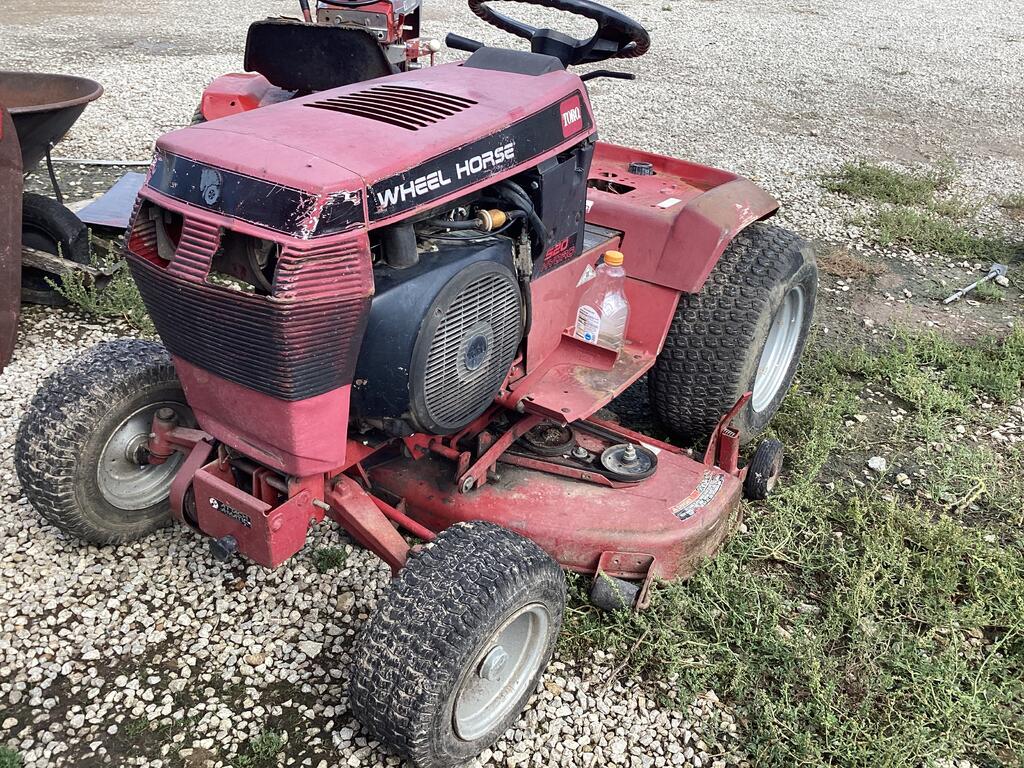

Easton Rich 1,097 #1 Posted September 14, 2025 Bought a 520-H and a 656 today, kind of impulse buys, but I’m happy! The two are getting delivered tomorrow. What should I expect? The 520 doesn’t run but it’s in decent shape. The 656 on the other hand, a little worse, sorry a LOT worse. Pictures when they come tomorrow 2 Share this post Link to post Share on other sites

Lee1977 7,629 #8 Posted September 14, 2025 (edited) Be sure to remove the engine cover and fender pan and clean all the cooling fins. The Onan moves a lot of air and will blow dirt and grass in to fill the fins. When change the oil filter make sure the half circle under the filter is clean of oil. Make sure the rubber engine vent on top of the engine is tight. Edited September 14, 2025 by Lee1977 1 Share this post Link to post Share on other sites

Lee1977 7,629 #15 Posted September 15, 2025 It's worth $125 the front axle and wheels are worth that. The slot hitch on the 656 is worth the $45. Both can be be made into nice tractors. Share this post Link to post Share on other sites

MainelyWheelhorse 2,394 #19 Posted September 15, 2025 1 hour ago, Easton Rich said: I will be posting a wanted ad in the classifieds also, but I’m in need of a set of fenders and a hood for my 520. If you’ve got something PM me. Thanks The 520 bodywork doesn’t look horrible. The sheet metal is pretty soft and you could get the dents out pretty easy with a rubber hammer/metal hammer and a block of wood. I fixed a pushed in nose on a spare hood like that. The dent in my 312’s hood was significantly worse before I massaged the hood on it.The fenders on the 520 look decent and could be fixed the same way. Share this post Link to post Share on other sites
Easton Rich 1,097 #20 Posted September 16, 2025 Yeah, I’ll see if I can get them out. Some are pretty bad that the camera doesn’t show. I’ll try to get some close-ups tomorrow. 1 Share this post Link to post Share on other sites

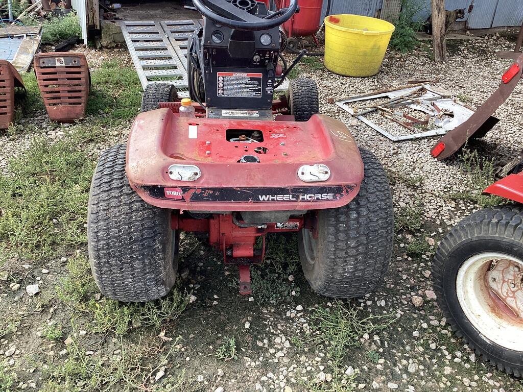

Easton Rich 1,097 #24 Posted October 19, 2025 Ok, I’ve got a problem. Someone has cut the wiring for the headlights. There are no wires coming from anywhere that would be to hook them up. Where do the long wires plug into? I’m stumped Share this post Link to post Share on other sites
lynnmor 8,701 #25 Posted October 19, 2025 37 minutes ago, Easton Rich said: Ok, I’ve got a problem. Someone has cut the wiring for the headlights. There are no wires coming from anywhere that would be to hook them up. Where do the long wires plug into? I’m stumped The headlights are grounded at the temperature sensor on the engine. The positive wire goes over the engine, but under the intake manifold, along with the temperature sensor wire and are protected with a sleeve. Those wires continue on to the 9 pin connector. Share this post Link to post Share on other sites
