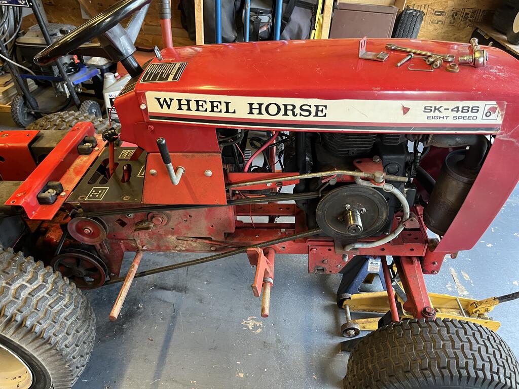

Nutiket 1 #1 Posted September 9, 2025 Hello. I have a stock SK-486. Any ideas on how to make it faster? Share this post Link to post Share on other sites
Ed Kennell 45,524 #2 Posted September 9, 2025 Increased diameter of engine pulley Decreased diameter of transmission input pulley These require belt and belt guard changes. Increased rear tire diameter. May require seat pan and foot rest mods. 4 Share this post Link to post Share on other sites
wallfish 19,540 #3 Posted September 9, 2025 How fast do you want it to go? Changing the engine pulley larger or the trans pulley smaller accomplishes higher RPM at the trans. There are many pulley calculators online Share this post Link to post Share on other sites

Nutiket 1 #5 Posted September 9, 2025 How would I know what to increase/decrease the sizes of the pulleys too? Share this post Link to post Share on other sites
wallfish 19,540 #6 Posted September 10, 2025 (edited) 22 minutes ago, Nutiket said: How would I know what to increase/decrease the sizes of the pulleys too? 1 hour ago, wallfish said: There are many pulley calculators online How would we know if we don't know what you're actually trying to do? Is this just to mow the lawn a little faster? Race it? How fast do you want it to go? I built a Wheel Horse that did 30 mph + The engine pulley from a Hydro driven tractor is an 1" bigger than the manual tractors. That's were you might want to start and gain a little speed Edited September 10, 2025 by wallfish Share this post Link to post Share on other sites

peter lena 9,812 #13 Posted September 12, 2025 @Nutiket check that upper rear idler pulley , known for failure and terrible undersize bearings , and related lubrication failures . another glairing thing to me , is the condition of that paint ! penetrating oil soak down , while in the shop . days / weeks wet , to soak in and feed recover paint , then a clean cloth mineral oil rub down , do it in stages , no rush , when paint finally looks , deep clean , a 6" electric palm buffer , and cleaner wax , just a light buffing , that paint stage is what you want , take advantage of it , did that on my 3 units . pete Share this post Link to post Share on other sites

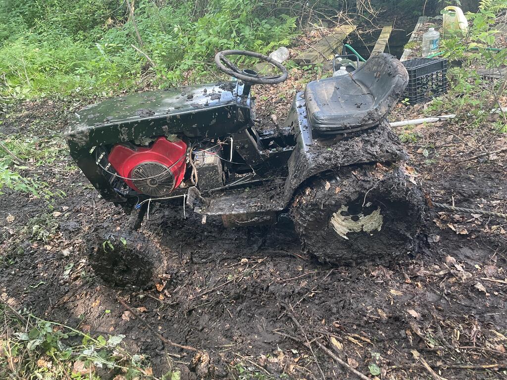

WHGuy413 2,851 #17 Posted September 15, 2025 My son spent the better part of last summer changing pulleys out on his b-80 “mud mower” some days I would come home from work and it would be crawling along in the back yard some days it would flying along. I think he has a 6” pulley on the engine now. It moves along but he still has plenty of power to play in the mud when we actually have it. I have to say he does have a 16hp v twin in it tho. 1 1 Share this post Link to post Share on other sites
