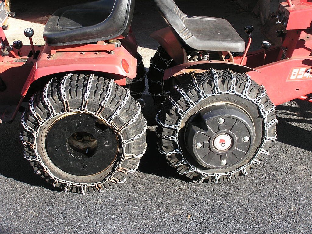

ri702bill 12,395 #3 Posted September 8, 2025 Tires are only part of what is needed to plow snow... A lot of us, like me, have dedicated winter and summer use tires mounted on their own rims. My preferred winter tireon my C81 is a turf design, has an inner tube filled with winter windshield fluid, 2 link chains and cast iron wheel weights. A similar but narrower setup on the 854. 2 3 Share this post Link to post Share on other sites
Krice58 165 #4 Posted September 8, 2025 22 minutes ago, ri702bill said: Tires are only part of what is needed to plow snow... A lot of us, like me, have dedicated winter and summer use tires mounted on their own rims. My preferred winter tireon my C81 is a turf design, has an inner tube filled with winter windshield fluid, 2 link chains and cast iron wheel weights. A similar but narrower setup on the 854. Nice. I have chains and wheel weights I’m going to put on in addition to the tires. 1 Share this post Link to post Share on other sites
ri702bill 12,395 #5 Posted September 8, 2025 Chains come in 2 varieties - 2 link & 4 link. I added extra cross links to fill in every side chain link that sits flat to the sidewall. This provides 3 things... More weight on the wheel More traction grip surfaces - you always have 2 crosslinks in contact with the ground. Much less tire spinning. This gives a much better ride on a freshly plowed driveway. Four link chains with the least amount of cross links can rattle your teeth. 2 Share this post Link to post Share on other sites
