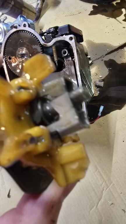

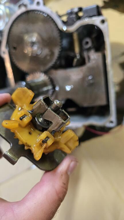

BrianX128 115 #2 Posted September 8, 2025 Ah great.. tore it apart and I don't see anything wrong: The little metal wings are free and push the center section out. I couldn't tell if it was on the threads or not, I was dumb and grabbed it to look at it before looking at anything else. I don't see anything that would have kept it from working? Share this post Link to post Share on other sites
wallfish 20,718 #3 Posted September 8, 2025 4 hours ago, BrianX128 said: I don't see anything that would have kept it from working Look for whatever that pin pushes on. (Gov shaft) Share this post Link to post Share on other sites

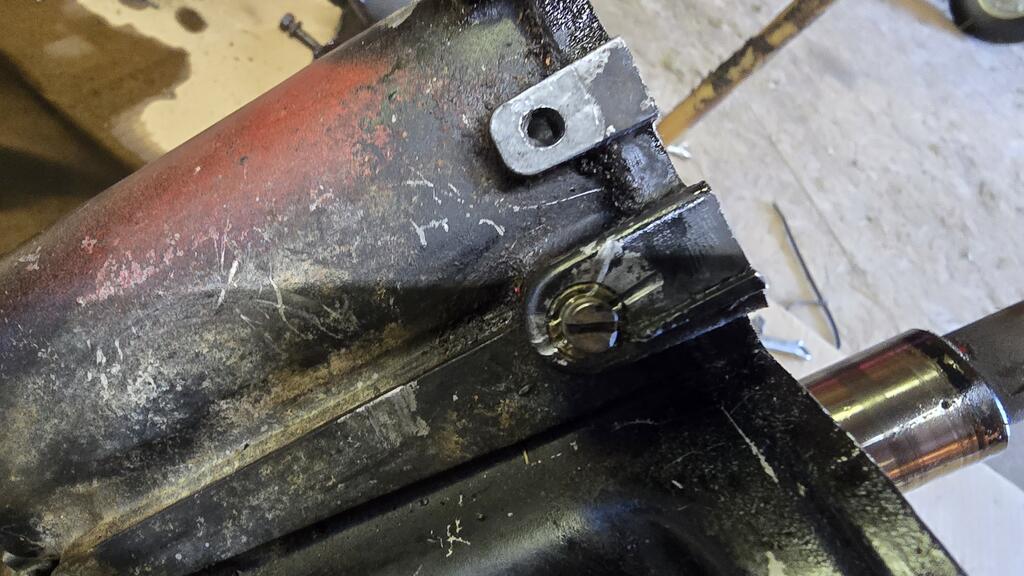

BrianX128 115 #4 Posted September 8, 2025 Hmmm wait a minute... Look at that indent on the housing from the cotterpin. That's embedded at wide open throttle so it would want to rest there and would struggle to push back towards idle. I got a dremel and made that all a flat surface. Also I don't have a picture but the hole the governor/ oil slinger rides on was egg shaped and would allow it to move "in" which would take away from its ability to fight high throttle even if the weights were pushing. I just ordered another one even though I think the main moving parts on this one are fine. Share this post Link to post Share on other sites
