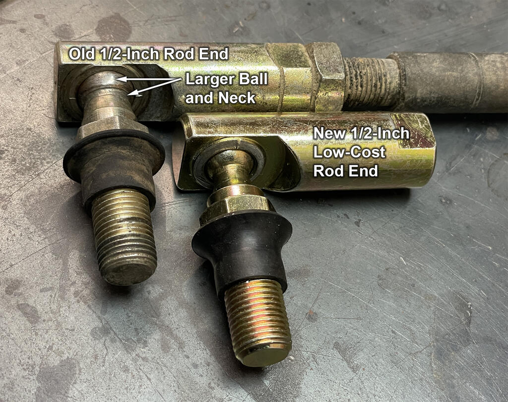

I’m currently doing some needed maintenance, adjustments, and repairs to my recently-acquired New Holland GT18 (the New Holland version of the Toro 518xi), which is the new companion to my 522xi.
The old steering tie rod ends had a lot of play in them, and one of them even had a washer welded onto it to keep the ball from popping out. The OEM replacements I was able to find were very pricey, so I looked for some lower-cost general-purpose rod ends that looked like they matched the originals. I found some that had the same threads and external measurements as the ones that were on the tractor. However, when I pulled back the rubber dust boots to see if the innards were the same, I found that the old rod end had a larger ball and larger neck on the stud where it meets the ball.
tie-rod-end-comparison-3a-smaller-image.thumb.jpg.e040bad8754fbffeec332b3e80e070c8.jpg
I won't speculate as to whether or not the low-cost replacement rod ends would be good enough, but I prefer replacement parts to be as strong or better than the originals, and I didn't have any load ratings to compare them.

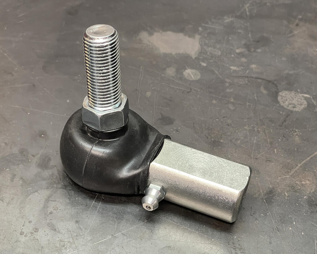

Thinking about it some more, I thought it might be nice to have greaseable rod ends, and Heim joints came to mind. I found some ½”-thread, stud-type Heim joints from McMaster-Carr that looked like they would do the job (the dimensions, thread sizes, swivel angle range, etc., looked OK to me).

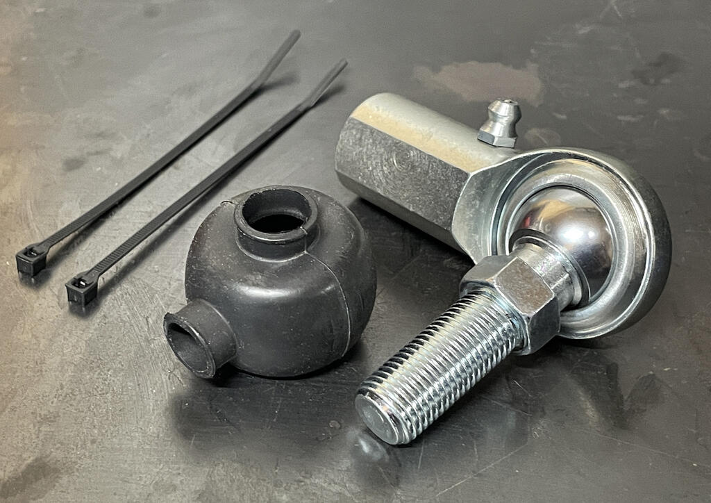

I wanted to install rubber dust boots on the joints, and I found some that I thought 'might' fit, although one of the holes was much smaller than the diameter of the female-thread shank of the joint, so it would have to stretch quite a bit…hopefully without tearing. If anyone knows about other dust boot options for these joints, let me know. In the meantime, I'm using these boots.
Here’s a photo of one of the Heim joints and one of the boots that I ordered (the boots did not come with the cable ties).
rod-end-with-boot-and-cable-ties-unassembled-smaller-image.jpg.ae135c4fd936d361f68f2682fe6be5b1.jpg

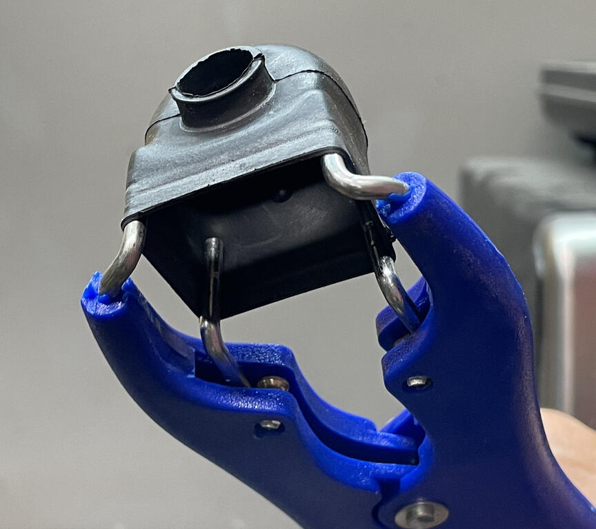

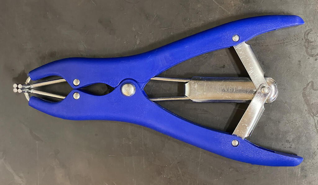

Trying to stretch the boot onto the joint with my fingers alone was not working very well. I noticed that some dust boot suppliers were selling four-prong stretching tools/pliers for that specific purpose. These tools appeared to me to be re-labelled ‘goat banding’ tools. Some of you with livestock would know that these tools are used for applying stiff rubber bands to a critter for the purpose of removing certain, shall we say, 'unwanted body parts.' Anyway, I found one at Tractor Supply for about 12 bucks that worked very well for stretching the dust boots.
I was pleasantly surprised to see how much the small hole in the boot could be stretched without tearing. I purposely over-stretched one (even farther than shown in the photo) just to make sure it didn’t tear. So far, none of them have torn, but I guess time will tell. After I figured out the best way of using it to install the first boot, the rest were a snap to install.
Here’s a joint with the boot installed (cable ties not installed yet):

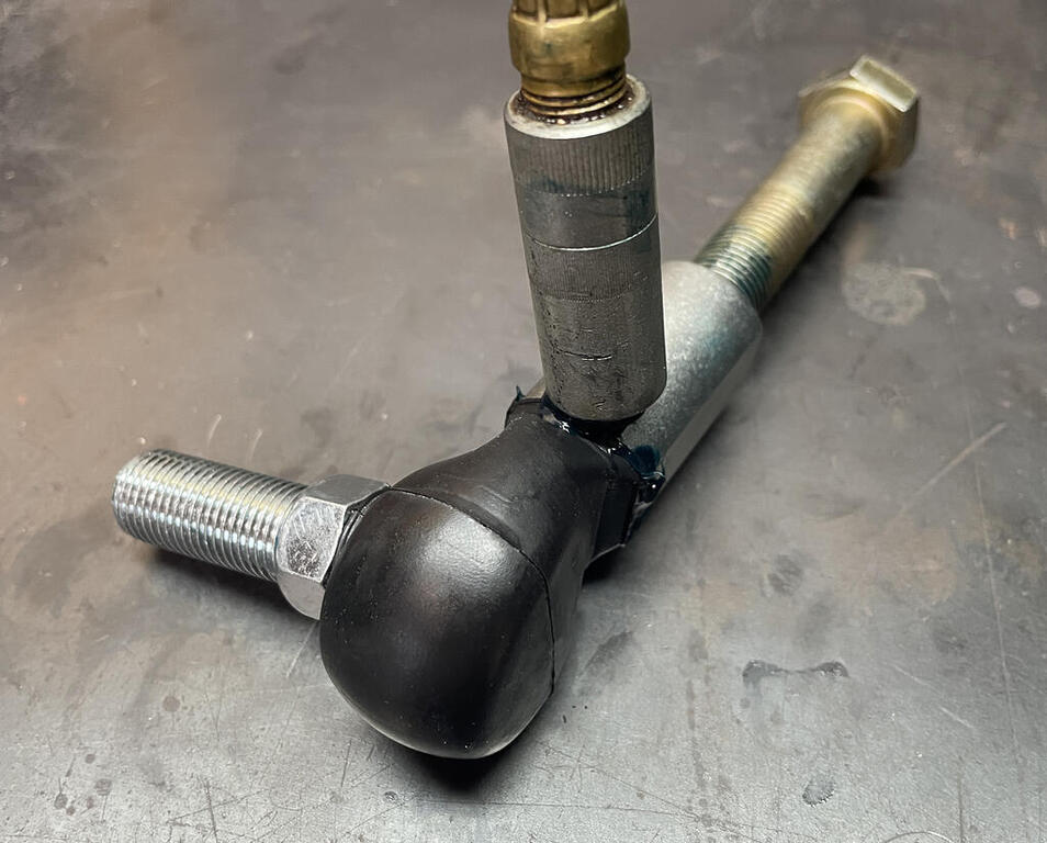

I thought I’d grease the joints before installing them on the tractor, as I wanted to make sure that the grease would go in OK without damaging the boots, and I also wanted to rotate the stud/ball while greasing it so that the initial charge or grease would completely surround the ball. I screwed a bolt (or the end of a tie rod) into the joints and pumped grease into them until it started to ooze out around the openings in the boots.

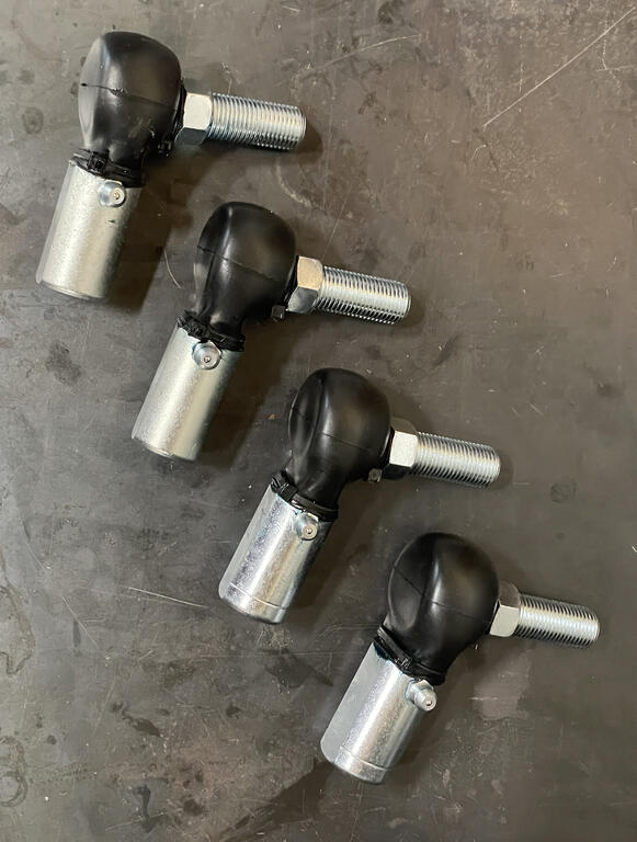

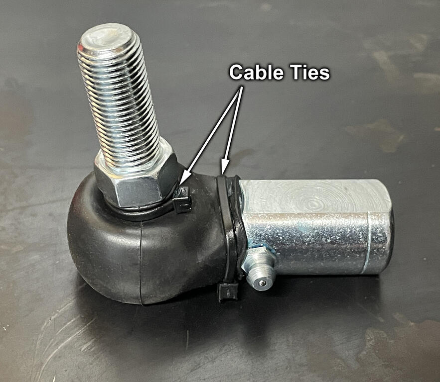

After greasing the joints I squeezed the boots a bit to force out any air bubbles and excess grease, and then installed cable ties on the boots. I don’t know if the cable ties are really necessary, but they at least make the boots appear more secure. I figured it couldn’t hurt.
rod-end-with-boot-and-cable-ties-smaller-image.jpg.5ddae902ad18c8f387f221e11913f629.jpg
Note: Before screwing the ends of the tie rods into the joints, I temporarily unscrewed the zerk fitting, which prevented air bubbles as well as the excess grease in the female-threaded part of the joint from being forced into the joint and boot. The residual grease in the threads should help prevent the joint from seizing up with rust over time. I had a #@*%! time getting a couple of the old rusted rod ends off. It took several long soaks in penetrating oil/solvent, applications of heat, and a barrage of unprintable language before they surrendered.
For future lubrication, I would slowly add just enough grease to see the boot swell up a bit and perhaps have a little bit ooze out.

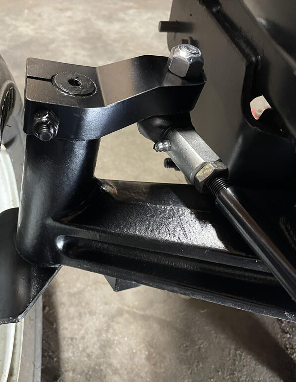

Here are the completed tie rod ends:
I installed the tie rods on the tractor, jacked it up by the frame, and checked for binding as I moved the axle tilt and steering through their full ranges of motion. Everything seemed fine to me. BTW, the nut is an all-metal distorted-thread lock nut.

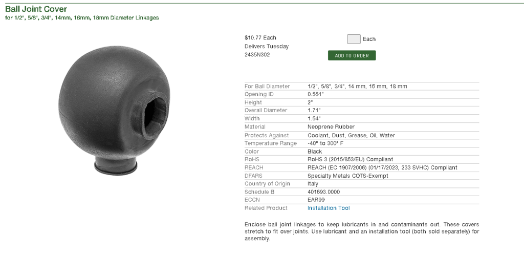

I obtained the studded heim joints from McMaster-Carr. I've been ordering stuff from them for about 40 years. Their prices are sometimes very reasonable and sometimes kind of pricey, but in any case, they have great customer service and super-quick shipping. I usually get my items the next day.
I ordered the boots directly from the Seals-It website. They were quite a bit cheaper there (6 boots for $34.76, plus shipping). I got the boots with two holes (RERS2B6PK, for studded rod ends) instead of three holes.

Blue Chips
On 9/7/2025 at 9:47 AM, JoeM said:
Looks like the same a MMC boot.
I just asked McMaster-Carr customer service.
2435N301 is Seals-It RERS2B and is a 2 hole version.
2435N302 is Seals-It RERS3B and is a 2 hole version.
