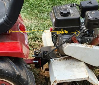

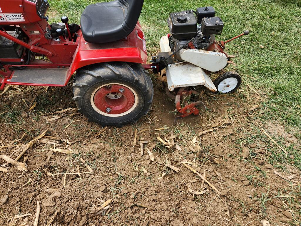

I am using a sears sleeve hitch tiller on a manual lift C120....is the a lift spring that can be used to make the lifting....easier?

If that black rod is the lift handle for the tiller, I would attach a heavy spring from there to  one of the seat bracket bolts.image.png.2a54f52aaaa22c74103729fc50a68f40.png
Old garage door springs work and I would also put a turnbuckle in line to adjust the tension.

The black handle @Ed Kennell is the drive belt engaging lever. The tiller is lifted with the same lift lever used for the mowing deck.

OK, I would try to fasten the spring and turnbuckle from the seat bolt to a bolt on the tiller engine.     I would do this to not only to reduce the load on the lift lever, but to also reduce the strain on the cable that connects the lift lever to the hitch.
