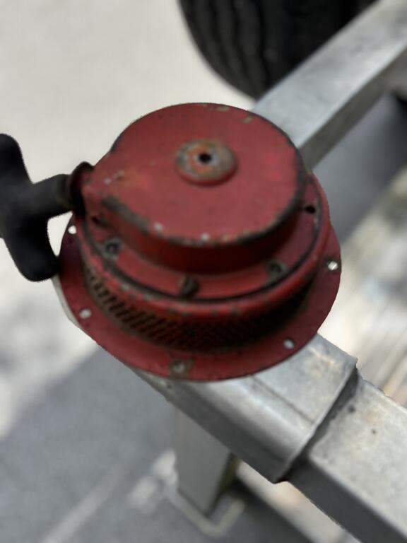

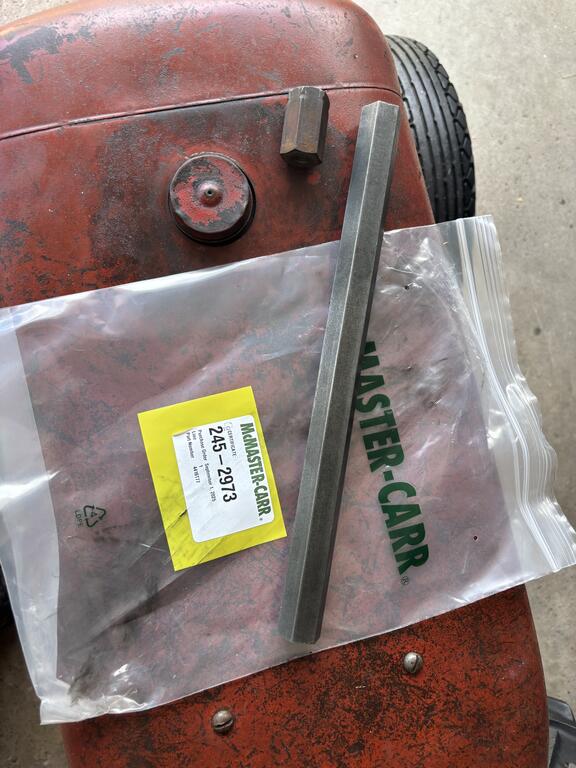

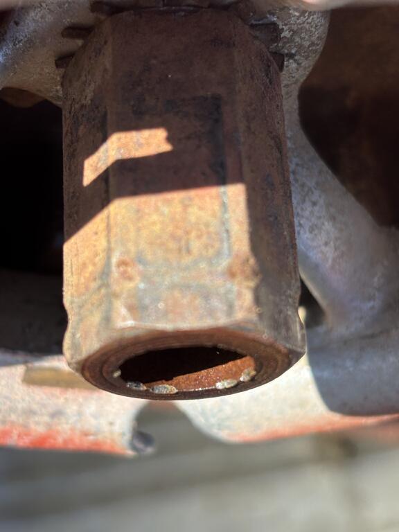

Lane Ranger 12,023 #1 Posted September 6, 2025 (edited) I am going to have some new Schnacke Nuts made for Kohler K 90 and 91 motors! I acquired a Schnacke with my latest RJ purchase and the 1 1/2 inch HEX Nut was already rounded which explained why the Schnacke was off the motor and the rope pull was being used! McMaster Carr sells 7/8 HEX rod in different lengths. I bought 12 inches which should make 7 good ones 1 1/2 long. I am also going to have the 7/16 x 20 threads placed on each end so the Kohler HEX Nut can be reversed and used on the other end after wear Edited September 7, 2025 by Lane Ranger 5 10 Share this post Link to post Share on other sites

8ntruck 9,021 #3 Posted September 6, 2025 I suppose one could weld up the worn portions, then grind/file the welds back to hex. That's assuming that the nut does not meed to be hardened. 1 Share this post Link to post Share on other sites
Lane Ranger 12,023 #4 Posted September 9, 2025 Joe Papke, the Schnacke Guru says I will need to harden these hex nuts so that will also be done on this project. I know the right blacksmiths with the right furnaces! 3 3 Share this post Link to post Share on other sites
lynnmor 8,875 #5 Posted September 10, 2025 On 9/9/2025 at 7:07 AM, Lane Ranger said: Joe Papke, the Schnacke Guru says I will need to harden these hex nuts so that will also be done on this project. I know the right blacksmiths with the right furnaces! You can only case harden cold rolled steel, but that isn't the best option for your part. You should have purchased an alloy steel and hardened it. One option 2 Share this post Link to post Share on other sites
8ntruck 9,021 #6 Posted September 10, 2025 McMaster Carr stocks higher carbon steel hex that could be hardened. Won't be tool steel hard, but it can probably get into the 40's on the Rockwell C scale. 1 Share this post Link to post Share on other sites

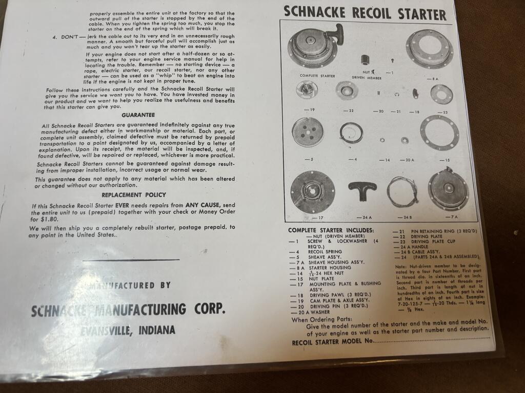

Lane Ranger 12,023 #7 Posted October 17, 2025 (edited) The Schancke operation instructions and parts list. Good reference information! Amazing guarantee in the 1950s for their recoil that they say could make 30,000 pulls outlasting your motor! Send recoil and a $1.80 to Schnacke in Evansville, Indiana to repair! Edited October 17, 2025 by Lane Ranger Share this post Link to post Share on other sites
