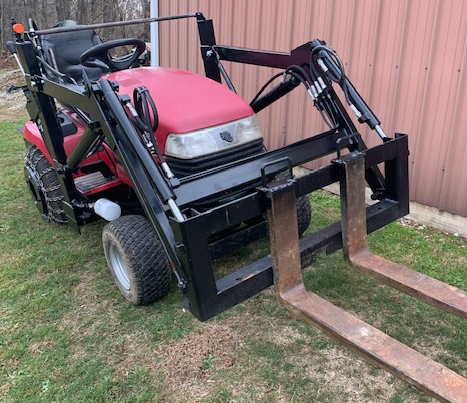

JoeM 10,268 #15 Posted September 6, 2025 10 hours ago, Awd79 said: how do we feel about a 520xi with 2,500 hrs for $500 no attachments and no front pto. 2500........Lots of hours, the hour meter works off of the oil pressure so it not a matter of someone leaving on the key. 518xi and 520xi machines don't have power steering. The 20HP water cooled 520LXI machines have power steering. The air cooled 522xi machines have power steering. For me a must using a loader. If you run across a machine that needs a PTO please ask why. If someone on had a bearing failure on the clutch, it may have caused the piece on the engine that keeps it from spinning to brake off. If it is just the PTO coil was bad or clutch is worn, new ones are out there for less than $200 I put this loader together in 20. It is on a 520LXI machine, dedicated. Runs good, I can carry around about 500 lbs but i have had more on it but it gets a bit dicey. I have a 522xi for mowing. Share this post Link to post Share on other sites

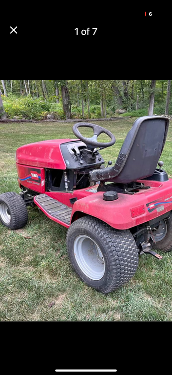

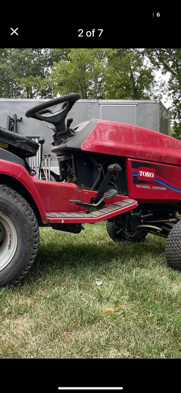

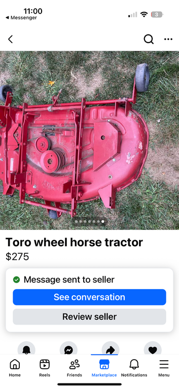

Awd79 31 #18 Posted September 6, 2025 So there was what I believe to be a 520xi for sale in my area by someone who had no clue what they had. Tractor, cart, and Belly deck all looked clean. Asked $275 and before I got there his brother in law took it. Share this post Link to post Share on other sites
