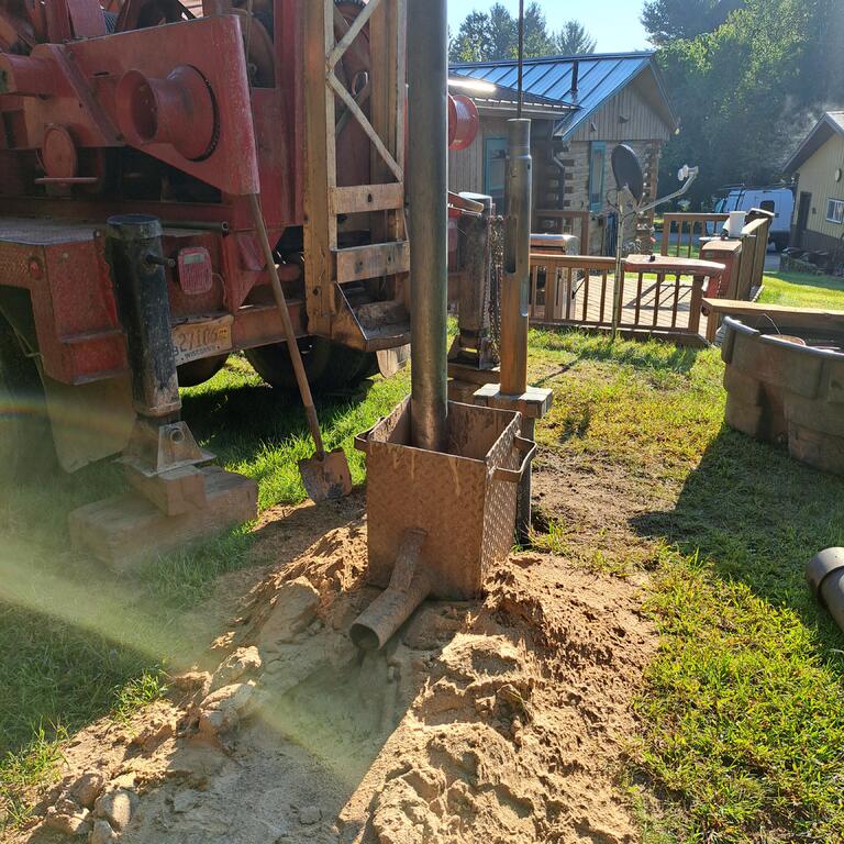

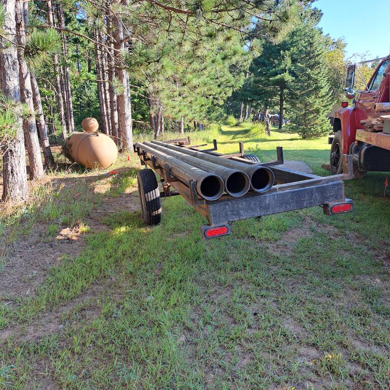

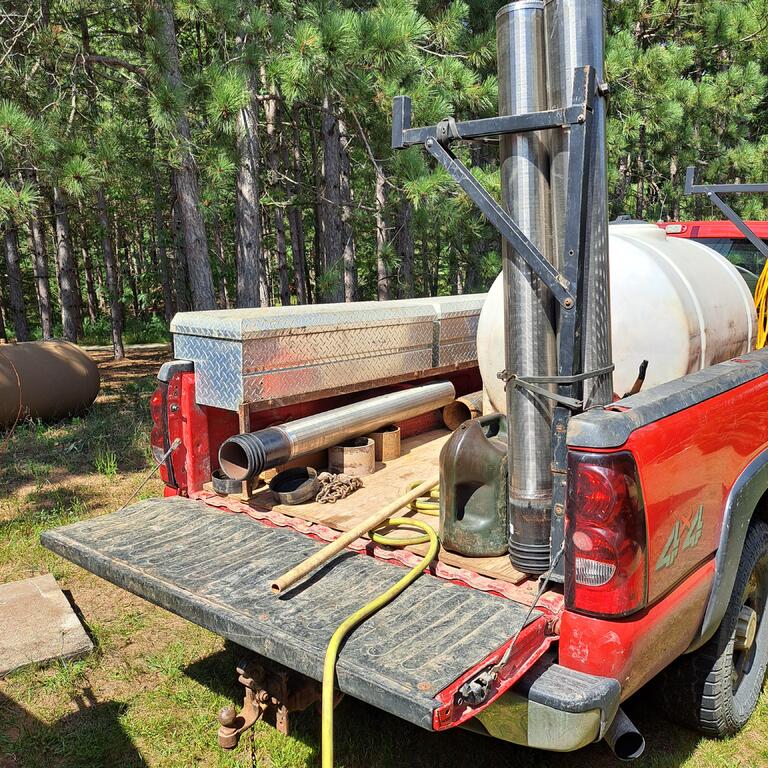

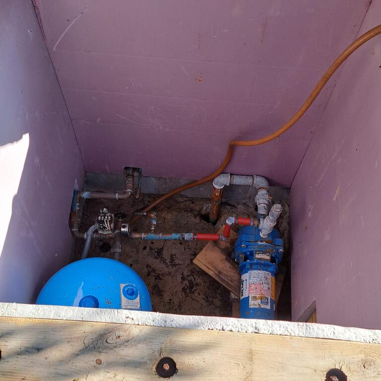

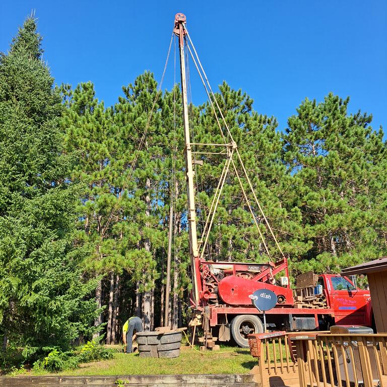

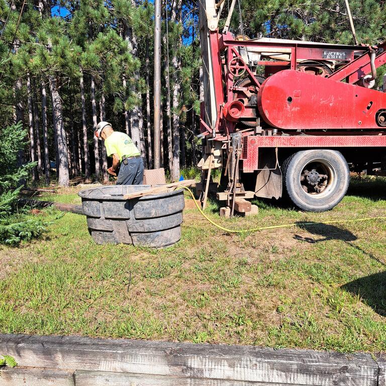

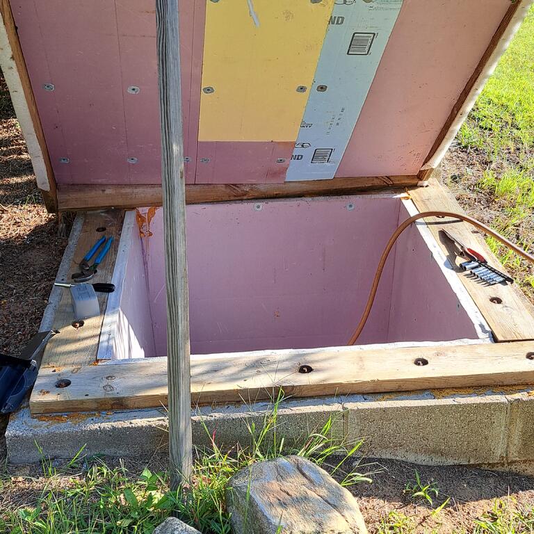

WHX?? 55,215 #1 Posted September 2, 2025 (edited) Well if The Pullstart can make a mess in his backyard. Time for a new water source. Way overdue... in the 40 years I lived here all we had is a 11/4" sand point down about 25 ft. Always good water in fact it comes from the waters of the Mecan River which I live next to. Perrier once wanted to put down humongous wells at its headwaters and peddle it. They got voted nay. Since its all sugar sand here points only last 10 years before they plug. I had replaced it before but it and the pump are down in a pit and not to code. Real old Bucyus Erie cable rig powered by a Continental four cylinder diesel mounted on a newer Ford 800 but is smaller to get it in where needed. Manual outriggers! All you equipment operators how would you like to have to set them with every move. Since i can pee faster than this delivers water I have it cross connected to the sprinkler system which is a 2" point down the hill. That one is only down 10 ' LP tank had to get temporarily moved to get the casings in. So far down 60 ft with enough pipe to 120. I think they plan on 180. Edited September 2, 2025 by WHX?? 17 Share this post Link to post Share on other sites
ebinmaine 77,530 #2 Posted September 2, 2025 What a neat rig! 1 Share this post Link to post Share on other sites

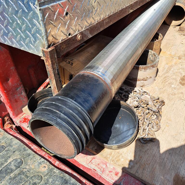

WHX?? 55,215 #9 Posted September 2, 2025 Ollie... basically a SS screen with a point on the end. The screen comes in different gauzes or the size of the screen. That's what plugs up. Eventually a void forms around the screen. They say if one shoots a gun or a fire cracker down the pipe it will clear the plug ... or blow the screen out . Now I don't know about that. Mama always says just put a new one down. This is the screen for a submersible. The pump sits inside of it. They can be pulled back out somehow to replace. Would imagine the pump has to be pulled to do it. 4 Share this post Link to post Share on other sites

WHX?? 55,215 #17 Posted September 3, 2025 1 hour ago, Beap52 said: Interesting topic. Finding water in the earth is interesting Beaps. They told me they like to see 40' of water minimum over the pump. Guessing the witching thing is for shallow wells. Interesting how this well is not drilled but pounded in. When he get so far he runs a pipe down and fills the pipe with dirt/slurry. then brings it up and dumps it. Kinda like a straw in a drink. I'll have to get a pic of it. A lot slower he only gets in forty foot a day. Less as it gets deeper he says. Most rigs have a regular drill to bring it up. Woulda never got one of those big rigs in the back yard without land clearing. At 30 ft he hit clay so the water I was tapped into sits on top of the clay. They say you need to go deep as the water is less contaminated. Your not supposed to drink out of a shallow well 'cause Pullstart drains his tractor oil in the dirt. ... 7 Share this post Link to post Share on other sites

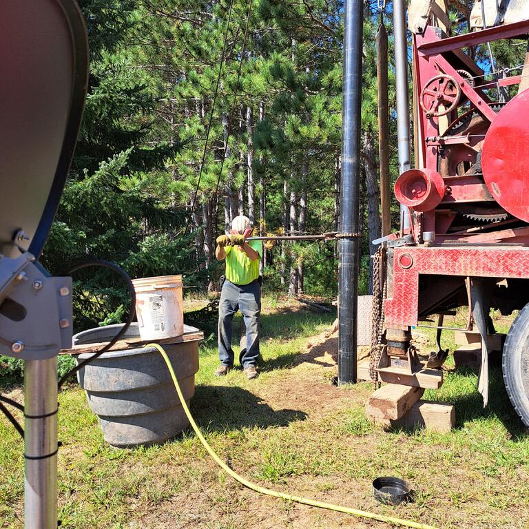

WHX?? 55,215 #18 Posted September 3, 2025 (edited) So here ya go Richard this guy is 74. Not a real big guy either but pretty spry. He set it all up by himself & saw him climb half way up with a five gallon bucket of water to dump down. Only guy on the job. Was told he is the only guy who knows how to run it. It shows he knows where every lever is second nature without looking. Funny he doesn't have an apprentice. Really no need for a second guy but to learn. An idea of how tall it is. The casing is in 20' lengths. they couple together with a big @ss chain wrench. He puts a choker around them to pick them off the trailer. They gotta be hevvvey. Video ... lemme know if don't work. Might need to get it on YT. 20250902_101017.mp4 Edited September 3, 2025 by WHX?? 11 Share this post Link to post Share on other sites
953 nut 64,303 #19 Posted September 3, 2025 10 hours ago, WHX?? said: this guy is 74. Was told he is the only guy who knows how to run it. It shows he knows where every lever is second nature without looking. Funny he doesn't have an apprentice. Really no need for a second guy but to learn. I guess when he gets old he may want to bring on a helper. 10 hours ago, WHX?? said: Video ... lemme know if don't work. Might need to get it on YT. That ponds it down rather quickly. Around here you get into granite at about 30 to 40 feet and it drills very slowly through for several hours. 2 1 Share this post Link to post Share on other sites
WHX?? 55,215 #20 Posted September 3, 2025 54 minutes ago, 953 nut said: That ponds it down rather quickly. Around here you get into granite at about 30 to 40 feet and it drills very slowly through for several hours. Thank you Richard. I asked the guy what happens if it hits a boulder or hard rock. He said if they can't pound or drill through it they abandon what they have down and move. 5 Share this post Link to post Share on other sites

WHX?? 55,215 #23 Posted September 4, 2025 Not much today got down another 30 ft to 130 total. Pulling up all red clay now. Pipe trailer went back for more as he only had 6 lengths on it. I think the magic number is gonna be 180 - 200. See what he does tomorrow then it's off to a show Dan and I have this weekend. Last one for the season. Guy works four 10's so no Friday action. 3 Share this post Link to post Share on other sites
