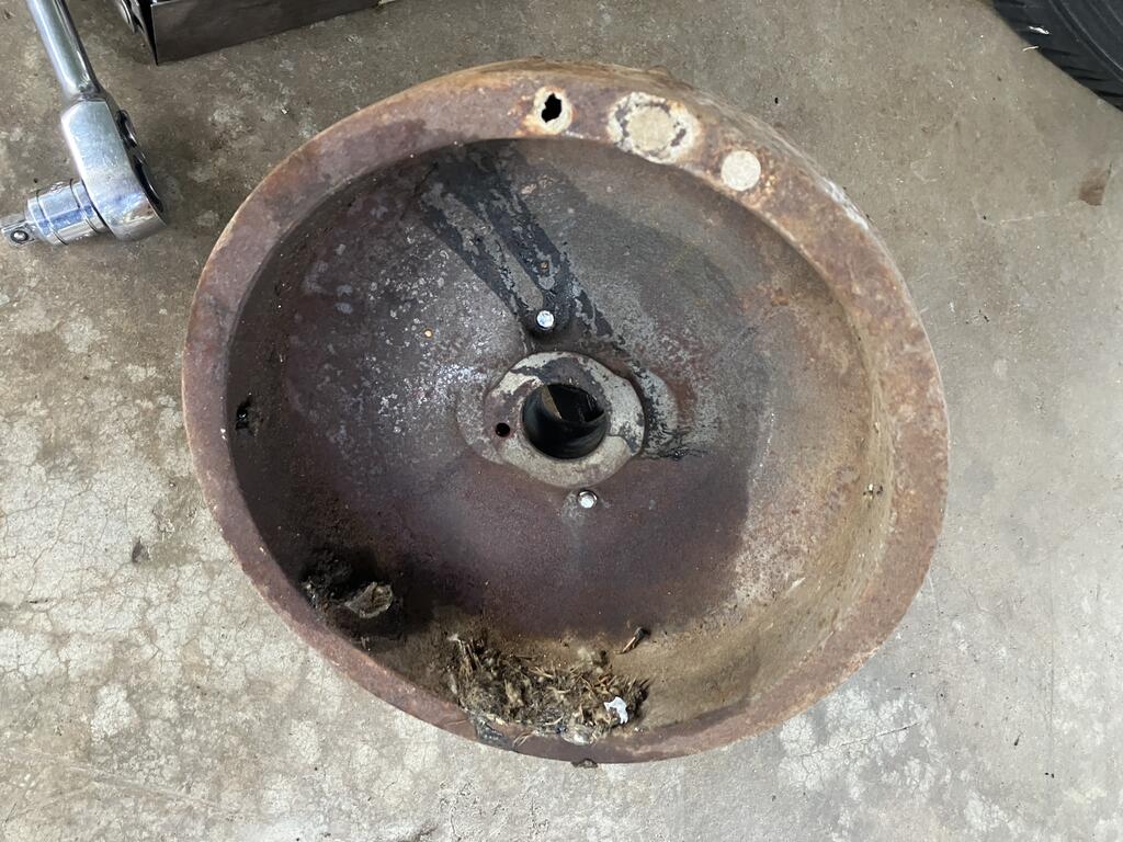

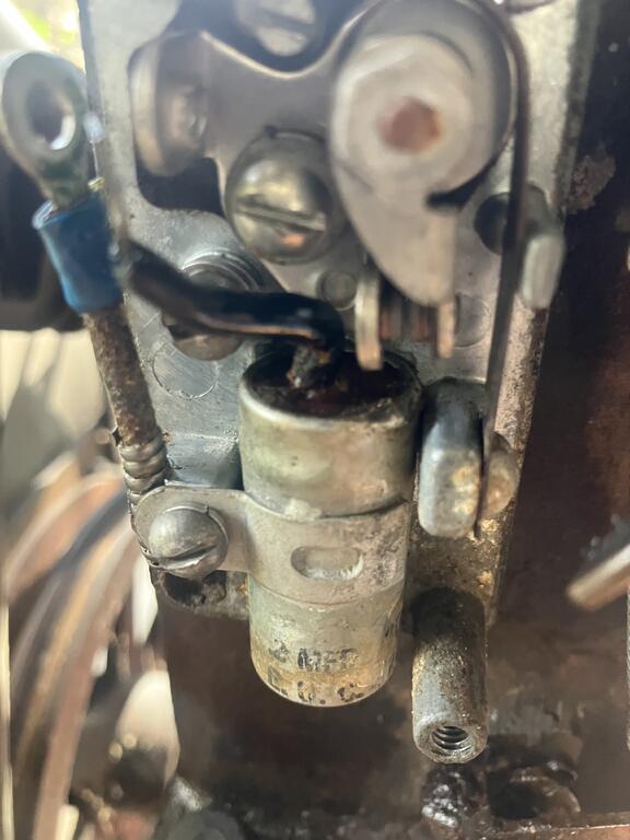

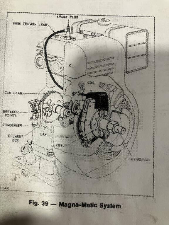

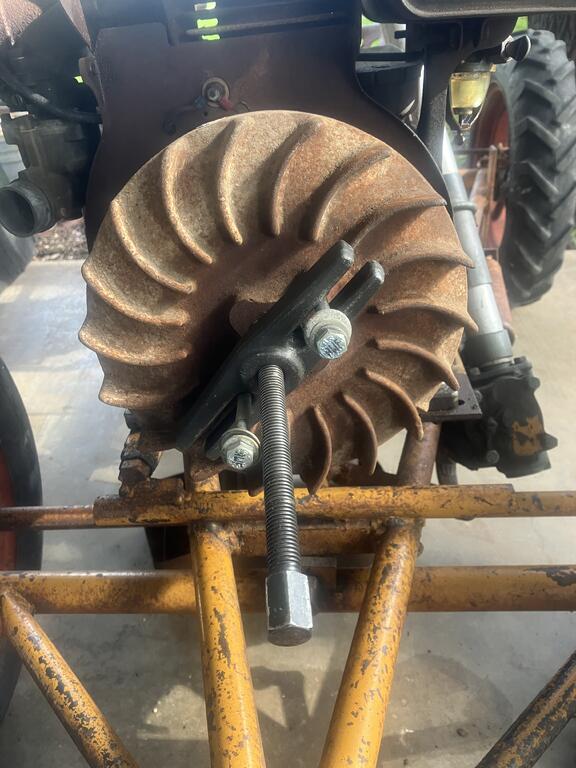

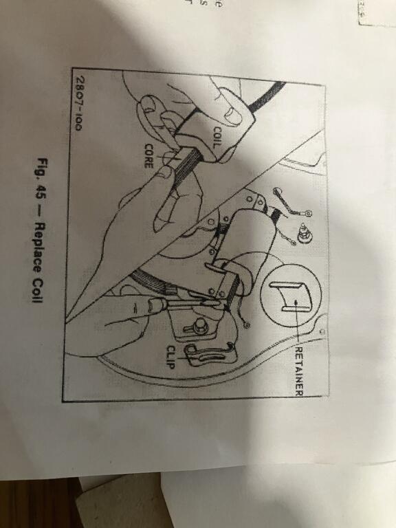

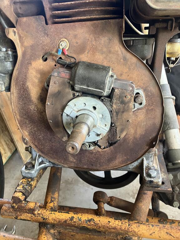

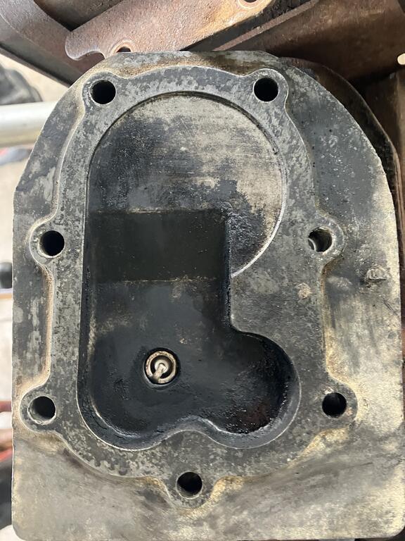

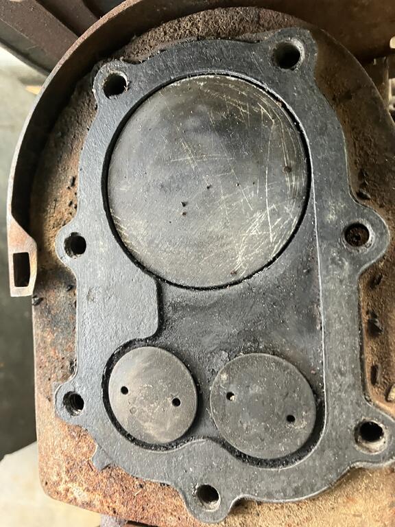

oliver2-44 11,076 #1 Posted September 2 (edited) Briggs Model 14, Type 202020, Serial 50066 I haven't run my Mayrath in a few months, Started it up Saturday morning to get it read for a show this coming weekend. Turned on the gas and it started on second pull of the rope. Drove it to the driveway, shut it off, got something, cranked it up and drove down the block. Went about about 2 blocks 2nd gear, and it died dead, no sputter, just dead. checked for spark at the top of plug, none. A little hard to do on the street, so I bravely grabbed the lead and pulled the rope- nothing. Pushed it home 2 blocks. I've never been into the ignition on this tractor except to clean the points when I got it out of a shed. It started right up with carb & choke tweaking. I've had it right at a year. If it ain't broke, don't mess with those old parts I told myself. So I soaked cover bolts and the crankshaft nut with penetrant for 2 days and gradually remove them. Thankfully they all came out, back and forth, back and forth This is the manual for this engine. Unfornatualy it doesn't give any coil resistance ranges. Model 14-domestic.pdf Model 14-domestic.pdf Amazingly the flywheel pulled off fairly easy, jus some tension and a mild smak of a BFH. Definitely needed cleaning, and the black asphalt varnish leaking out of the coil doesn't look good! Here's another pic of asphalt varnish down the side of the armature. The manual says there should be a 0.004 ths air gap minimum. However the insulation is filling the air gap here. but it is not grounding it out varnish on backside of flywheel Primary wire from coil attaches to this terminal , where a metal wrapped primary wire connects and goes to the points connection. Points and condenser in box on side of engine. The primary wire is on the right side of picture. I took a bunch of resistance reading with my meter, but didn't find any smoking gun as to why it died. Open - Coil ground wire to core 0.6 - Coil ground wire to coil primary wire -So this reads across both coils one end to the other. it seems to me this should read open the the 2 coils being separated? Open - coil Primary lead to core Open - Spark plug lead to core Open - Spark plug lead to ground 9.1 - Coil primary to spark plug lead Open - Primary wire to ground 0.2 - Primary wire from end at terminal by coil to end at connection to points. Open - Primary terminal to ground Open - Condenser lead to ground Open - Points to ground 0.7 - Resistance across closed points 12.8 - Crankshaft to rotor - no insulation on drawing, so i think this is good Open - Rotor to core Open - Armature to core I am surprised this is open, it must be insulated by rust? All help is greatly appreciated! @953 nut Your always a good electrical guy, so I'm tagging you @oldiron613 i know you have several old Briggs on your Speedex, so I'm tagging you also This is called Briggs Magna-Matic Ignition System. Since I'm this far into this engine, I'm also going to lift the engine and replace the block to oil pan gasket and of course the head gasket. I'm debating if I pull the carb and open the valve cove to check clearance. The engine runs good with about 1/4 choke, so carb could probable us a cleaning, but I hate to mess with an old Briggs carb that is working fairly well. . Pulling the front flywheel cover required several head bolts to be removed, so I pulled the rest to clean off any carbon. This is how it looked after just a wiping off, very little carbon The head also has very little carbon. That is a new plug I put in it to test if the plug was the issue. Edited September 2 by oliver2-44 1 Share this post Link to post Share on other sites
Handy Don 15,319 #2 Posted September 2 (edited) 55 minutes ago, oliver2-44 said: The head also has very little carbon. I've seen more after cleaning! I hope you’re able to resuscitate the old girl without a lot of trouble! To me, if in ohms, this is surprisingly high. This equates to 8 watts. I’d expect a reading less than 0.01Ω 0.7 - Resistance across closed points This, too, I’d expect to be near zero. 0.2 - Primary wire from end at terminal by coil to end at connection to points. Edited September 2 by Handy Don 2 Share this post Link to post Share on other sites

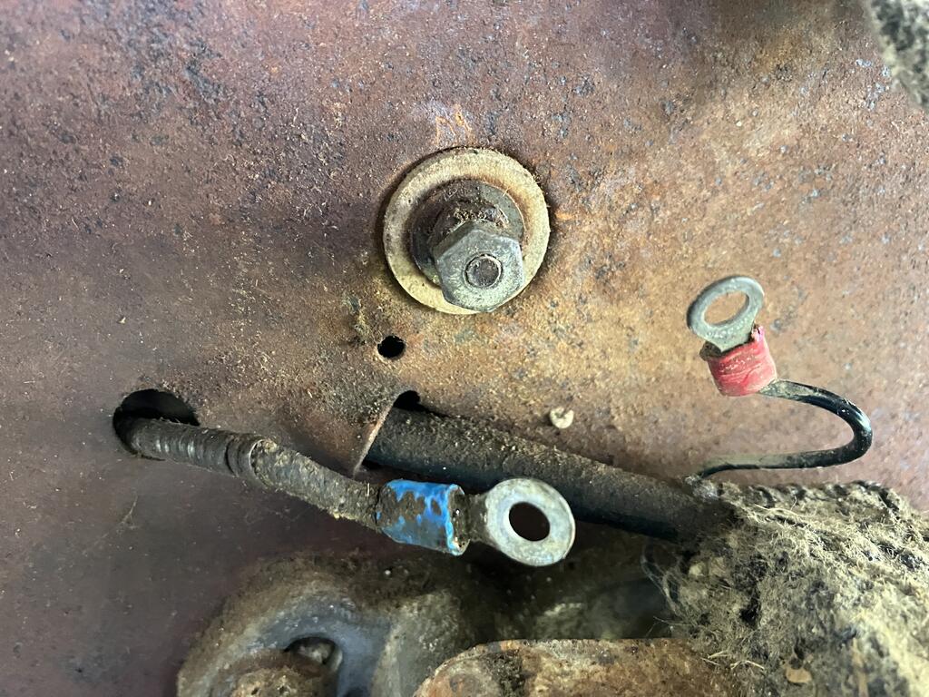

oliver2-44 11,076 #5 Posted September 2 (edited) 13 hours ago, Handy Don said: I've seen more after cleaning! I hope you’re able to resuscitate the old girl without a lot of trouble! To me, if in ohms, this is surprisingly high. This equates to 8 watts. I’d expect a reading less than 0.01Ω 0.7 - Resistance across closed points This, too, I’d expect to be near zero. 0.2 - Primary wire from end at terminal by coil to end at connection to points. I cleaned the point sawing heavy brown paper then dialectic spray. They now measure .02 to 0. The primary wire may have some strands broken in it. It changes .5 to 0 as I wiggle it. So I’ll replace it. Any thoughts on the “9.1 coil primary to spark plug lead”. Edited September 2 by oliver2-44 1 Share this post Link to post Share on other sites

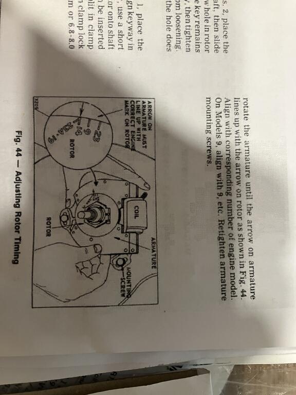

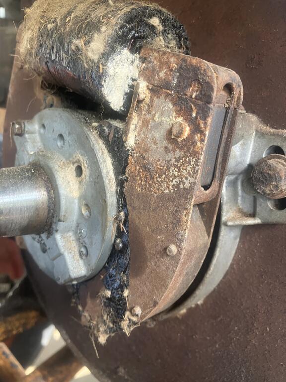

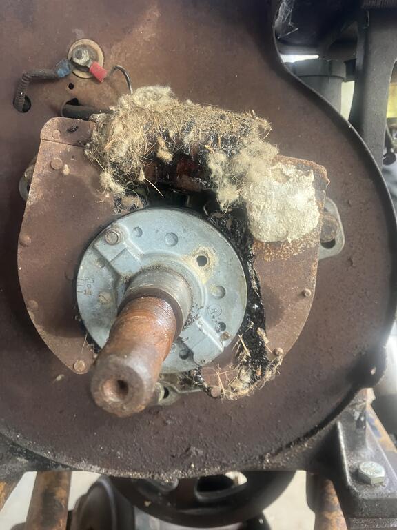

oliver2-44 11,076 #13 Posted October 22 (edited) @953 nut @Handy Don Here is the new coil mounted, put it all back together…No spark. Did a lot of head scratching and reading about these engines on other forums, but no clues. Read back through the manual and noted there need to be .004 clearance minimum between center rotating magnet and armature. Pulled it back apart and some areas had clearance and others closed up with black asphalt insulation from old coil. I had previously seen this and measured ohms between armature and center magnet and it read open, so I thought that was OK. I cleaned the air gap multiple times with brake clean and my feeler gage. Now have a good 0.009 all around. Put it back together and it started on 2nd pull. Notes: The center magnet to armature has to have an actual air gap, I don’t quite understand but I suspect it has something to do with the magnetic field flux acting on the armature. New coil primary to spark plug lead 5.6 ohm (old was 9.1 ohm) Across new closed points 0.01 ohm, old points even after cleaning and filing 0.7 ohm. Points set at 0.020. I took it for a ride around the neighborhood hood. I’m sure I had a big 😊 Edited October 22 by oliver2-44 2 Share this post Link to post Share on other sites
Handy Don 15,319 #14 Posted October 23 On 10/21/2025 at 11:06 PM, oliver2-44 said: I took it for a ride around the neighborhood hood. I’m sure I had a big 😊 Kiudos for persevering. Well deserved victory lap, I say. Over many years playing with small engines, I’ve developed a near reverence for the “gospel of the service manual” as written by the engineers. While in some areas, the tolerances are wide, there are many where they are very, very small--particularly when electrics are involved. Share this post Link to post Share on other sites
