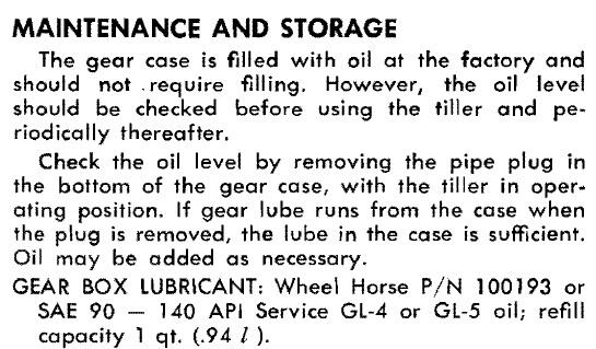

mike avad 60 #1 Posted August 31, 2025 How much gear oil dose a tiller hold in the gear box's and what the best way to check to see how much is in the gear box? put her up for the winter Share this post Link to post Share on other sites
gwest_ca-(File Mod) 12,097 #2 Posted September 1, 2025 This is from the 1980-82 operator manual for model 07-36TL01. I don't know about the plug in the bottom of the case but it may be part of the case so does not show up in the ipl's. The fill plug is shown. 1 Share this post Link to post Share on other sites
mike avad 60 #3 Posted September 1, 2025 Thank you for your reply and yes mine has a plug at the bottom of the gear case I just wasn't sure on how full the gear case should be? Its sure a Paine in the but on how to check the gear case oil level on that .You al most have to drain all the oil all the oil just to see how much you have in there. Share this post Link to post Share on other sites
