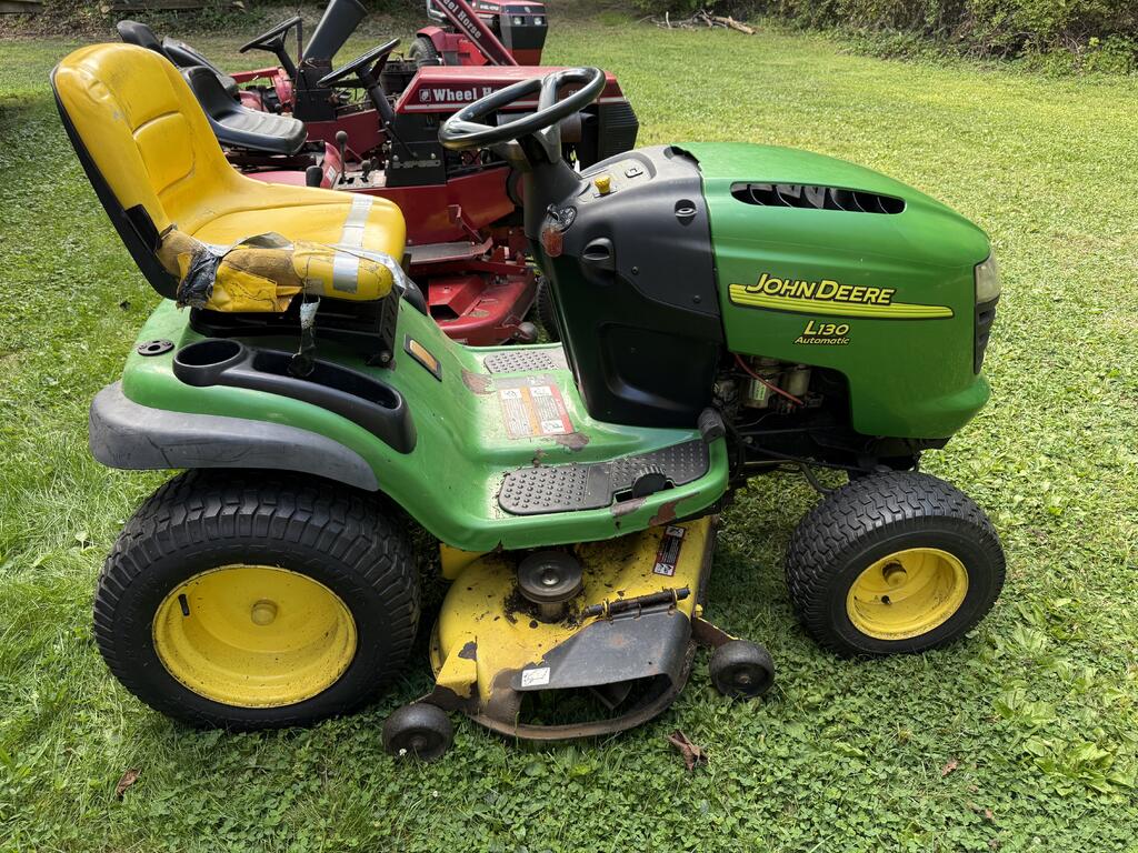

nylyon-(Admin) 9,196 #1 Posted August 30, 2025 Next door neighbor sends me a text and says, you want this John Deere tractor, hasn’t run in years just want it out of the shed. Well, even though it is green it is free, so I snatched it up. Got it home, put on the jump pack hit it with a shot of ether and it fired right up spewing gasoline everywhere. Replaced the fuel line and it runs. Only problem it has is when you shut it off hot, it won’t restart. It has one of those solenoid thingies on the bottom of the carb, wonder if that is shot? Kohler CV23s Share this post Link to post Share on other sites
nylyon-(Admin) 9,196 #2 Posted August 30, 2025 No spark, wonder if there is a common issue with this. Share this post Link to post Share on other sites

953 nut 70,653 #4 Posted August 30, 2025 Clean up the contacts on the ignition switch for starters (pun intended). On many engines the solenoid on the carb has two power sources, one from the "S" terminal of the ignition switch to open it while starting and the other from the charging circuit via a diode to keep it open as long as the engine is running. 3 1 Share this post Link to post Share on other sites

nylyon-(Admin) 9,196 #10 Posted September 2, 2025 Got around to pulling the shrouds off the engine, what a mouse mess in there. One of the plug wires was chewed to the core, and neither cylinder had spark. It has a real simple magneto ignition so it almost has to have spark otherwise either the coil is bad or the the magnets are missing on the flywheel, but the magnets are there so must be the coil. Ordered up 2 aftermarket coils (I am not keeping this) will see tomorrow if it fixes it. 1 Share this post Link to post Share on other sites

nylyon-(Admin) 9,196 #12 Posted September 3, 2025 2 new coils and she fired right up, promptly listed it on FB Marketplace 3 Share this post Link to post Share on other sites
