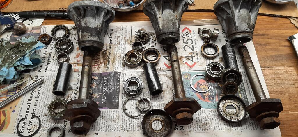

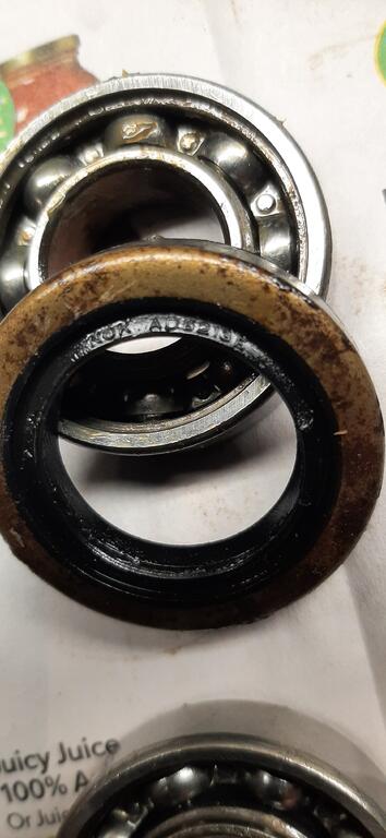

John c 197 #1 Posted August 29, 2025 I'm working on my new 42 RD deck and I found a separate oil seal on the pulley end of the spindle shaft. I say separate because the others I've taken apart have just had sealed bearings. I can't find a part number for it, any of you guys seen this before ? Anybody got a part number for it ? Thankfully the PO had a greasegun, there's is not a thing wrong with the bearing, I'm planning to reuse them. Have a look at the seal I'm talking about, just below the top bearing, it has a number on it, are seal numbers like bearing numbers, kind of universal. Share this post Link to post Share on other sites

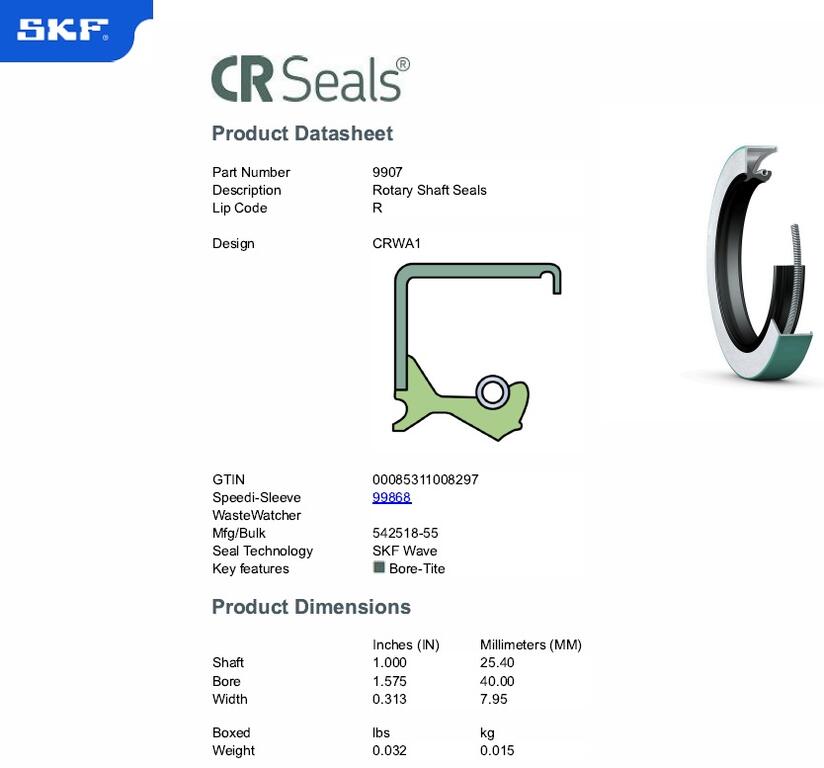

gwest_ca-(File Mod) 12,346 #2 Posted August 29, 2025 Probably Toro part number 106075. The Chicago Rawhide/SKF replacement is 9907 Click on the fuzzy picture in this link and again on the thumbnails that come up. The L spindle is the original assembly and M, V and Z are later updated assemblies. 1 Share this post Link to post Share on other sites
