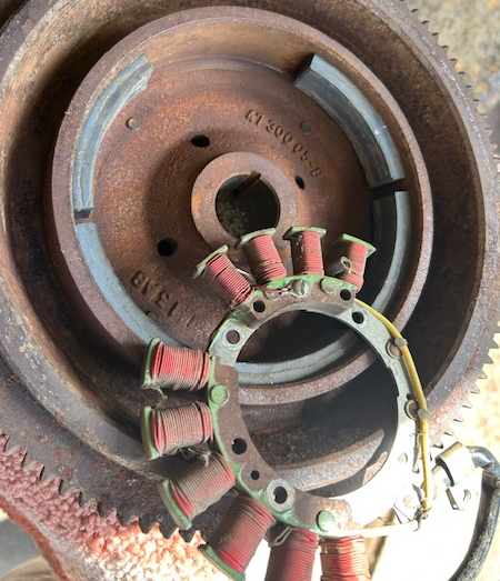

JoeM 10,099 #1 Posted August 26, 2025 Taking some parts from a M10 Kohler and seen one of the flywheel magnets was missing. Looks like it never was installed from the factory. Never noticed this before. Share this post Link to post Share on other sites
WHX?? 57,453 #2 Posted August 26, 2025 Never saw a stator missing teeth either. A magnum thing? 1 Share this post Link to post Share on other sites
gwest_ca-(File Mod) 12,362 #3 Posted August 26, 2025 With poles missing maybe the magnets don't matter either? 1 3 Share this post Link to post Share on other sites
clueless 3,427 #4 Posted August 26, 2025 Does your Magnum 10 have a gas tank attached to it? Share this post Link to post Share on other sites
JoeM 10,099 #5 Posted August 26, 2025 3 hours ago, clueless said: Does your Magnum 10 have a gas tank attached to it IDK got this from someone else for parts Share this post Link to post Share on other sites
RED-Z06 2,718 #6 Posted August 26, 2025 Kohler M flywheels came with a few different magnet layouts so it wouldn't surprise me. 2 Share this post Link to post Share on other sites

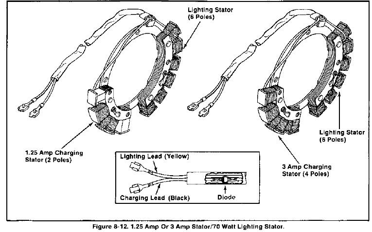

clueless 3,427 #7 Posted August 27, 2025 On a WH M10 early on they came with at least two different charging system, a dido 1.25 amp system and a 3 amp system. depending on the model. so magnet count and stator or going to be different. 1 Share this post Link to post Share on other sites
Lee1977 7,710 #8 Posted September 10, 2025 A cording to the Operators Manual the 1985 year 310, 312, 314, and 416 models all had 3 amp charging systems and AC light lighting system. Share this post Link to post Share on other sites
