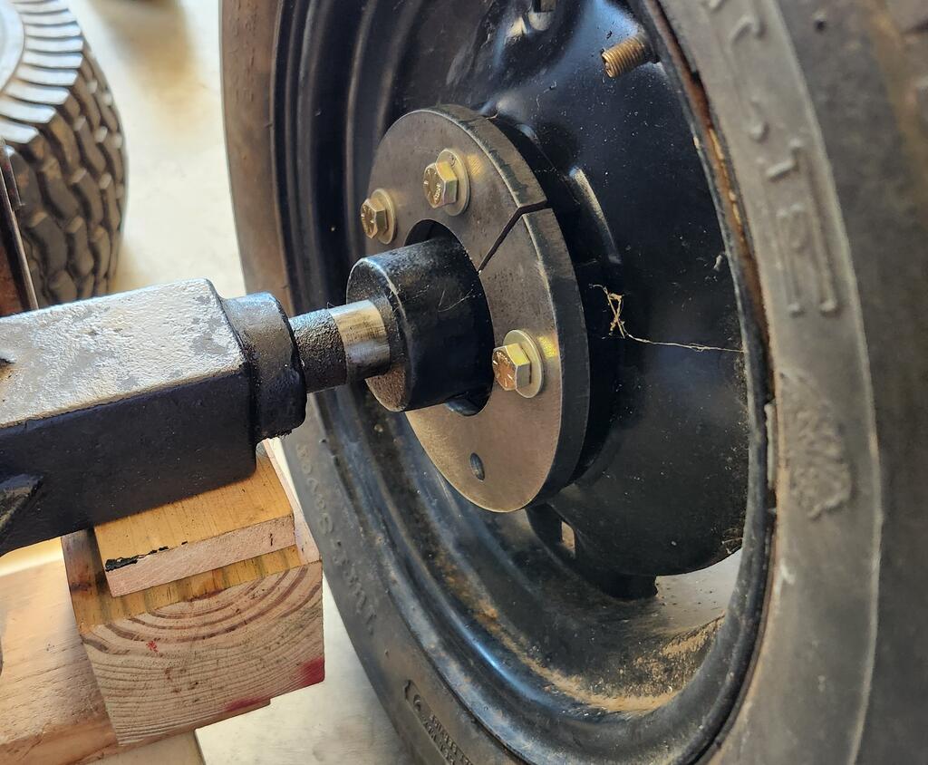

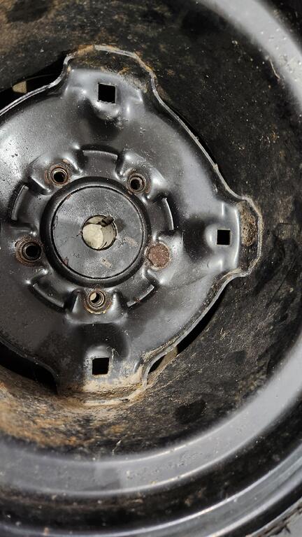

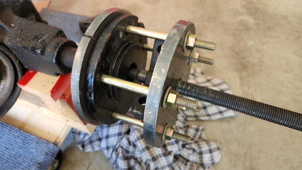

Racinbob 13,183 #1 Posted August 26, 2025 I'm tinkering with a 68 Raider 9 sorting out some things. Why the heck did they call these Raider 9's when they have a 10hp engine? One of the wheel lugs on the right side wants to put up a fight. The best I can tell is that it's not a lug bolt but a regular bolt that's been buried into the steel wheel and is mangled beyond any socket getting a grip. The other 9 came off easily and to my bewilderment the hubs came off without a fight. I decided to remove the hub with the wheel attached so I could get it to a better working height. Again, it came off easily using 4 of the five bolts on the puller. I'm thinking I have a couple of options here. Drill the stuck bolt from the backside or weld another nut on top of the mangled head. What would you guys do? Share this post Link to post Share on other sites
ebinmaine 80,692 #2 Posted August 26, 2025 3 minutes ago, Racinbob said: weld another nut on top of the mangled head IMHO the better option 3 Share this post Link to post Share on other sites
rmaynard 17,582 #3 Posted August 26, 2025 Just remember that whatever caused the bolt to seize is still there. Welding a nut on is a good idea IF you are a welder. Lots of PB Blaster and heat should break the bond. However, if you don't weld, you need another way. Since the bolt head is destroyed, and you have the wheel and hub off the tractor, drill the bolt from the back side. Start small and get increasingly larger until most of the bolt is gone. At some point the bolt will come out. Chase the threads with a 7/16-20 tap. 2 Share this post Link to post Share on other sites
squonk 48,117 #4 Posted August 26, 2025 Weld on another nut. Then heat the hub again but not red hot because it's cast. Then quench it good, Then hit it with an impact gun 1 Share this post Link to post Share on other sites
953 nut 69,255 #5 Posted August 26, 2025 8 minutes ago, rmaynard said: drill the bolt from the back side. Start small and get increasingly larger until most of the bolt is gone. At some point the bolt will come out. Chase the threads with a 7/16-20 tap. 47 minutes ago, Racinbob said: Why the heck did they call these Raider 9's when they have a 10hp engine? Real Raider 10s have a Kohler so you couldn't call a Tecumseh powered Raider a 10 perhaps the judges were being generous to give it a 9 3 Share this post Link to post Share on other sites
oldlineman 1,809 #6 Posted August 26, 2025 (edited) I am not a " welder " but I can weld, learned on the farm when I was growing up. Having said that I have always had good results when welding nuts in this situation. You have the wheel off and can lay it down ,perfect position for welding. Clean the head of the bolt well and use a little more heat than usual, and if it breaks off try again. If you have a welder, preferably a MIG set up, a stick welder will work, ( I tend to do better with the MIG) Eyesight is becoming more of a problem I later years,I would go for it.You can always drill it if welding doesn't work. Bob Edited August 26, 2025 by oldlineman 2 Share this post Link to post Share on other sites
rmaynard 17,582 #7 Posted August 26, 2025 22 minutes ago, oldlineman said: I am not a " welder " That describes me. I borrowed a friends MIG welder and did more damage than good. 1 Share this post Link to post Share on other sites
Ed Kennell 47,293 #8 Posted August 26, 2025 1 hour ago, Racinbob said: weld another nut on top of the mangled head. Yep, use a big nut that the mangled head fits inside. 2 Share this post Link to post Share on other sites
Racinbob 13,183 #9 Posted August 26, 2025 I'm thinking the big nut is the hot ticket. I'll give it all the heat my welder is capable of. 130A 1 2 Share this post Link to post Share on other sites
oldlineman 1,809 #10 Posted August 26, 2025 I have a hobart 140 MIG with gas, does everything that I need to do. 2 Share this post Link to post Share on other sites
kpinnc 18,959 #11 Posted August 26, 2025 1 hour ago, oldlineman said: I have a hobart 140 MIG with gas, does everything that I need to do. I have the same welder but run with flux core. Nice little welder! 1 Share this post Link to post Share on other sites
Racinbob 13,183 #12 Posted August 26, 2025 (edited) I've got a little Arccaptain 130. It will do flux core and arc. Also tig if I add the equipment. It's a fairly recent purchase and seems well suited for me. I did weld quite a bit in the 'old' days and it was all with a Lincoln 225 AC. Edited August 26, 2025 by Racinbob 3 Share this post Link to post Share on other sites
953 nut 69,255 #13 Posted August 26, 2025 8 hours ago, Racinbob said: I'm thinking the big nut is the hot ticket. I'll give it all the heat my welder is capable of. 130A If that doesn't work for you there is still Bib's drill it out option. Share this post Link to post Share on other sites
