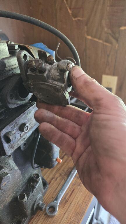

NEW points and she is coughing.  Will run briefly choked.  I cleaned and re installed the carb.  I think I need a new one.  No luck finding a rebuild kit,  I know kits are available for a wh K91.  This carb I have not seen before.  Any links to a complete carb?
13 hours ago, wallfish said:
wallfish
You got any pics of that carb?
If you can find or order a carb for a K91-K181 it will fit right on there.
A Clinton carb is another option
Treepep

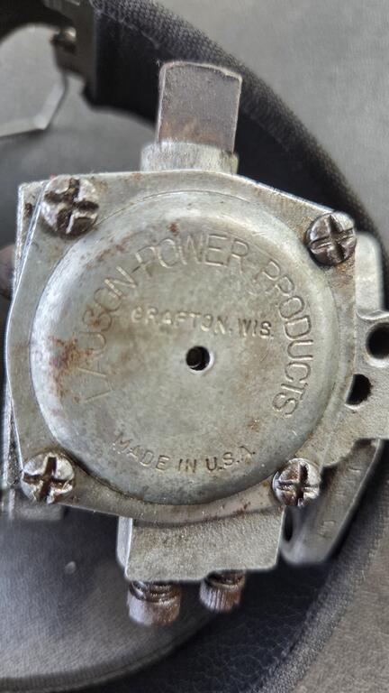

This carb is soaking.  I took everything apart.  Cleaned and it sorta ran.  Win...  not getting enough fuel.  A carb with a sediment bowl would be preferable.
wallfish
Posted (edited)
I've never seen one of those before but I have a WHOLE BUNCH (60 +) of little 2 stroke engines that use pulse pumped carbs. The diaphragm in there MUST be soft and pliable and no stiffness at all or it can't move to pump fuel from the little amount of pulse pressure. Tank above the carb and clean the check valves good.
Is there anything special with that diaphragm or is simply a piece of rubber? I have some fuel resistant diaphragm material that I can send so you can make one if it's just a simple material set up
