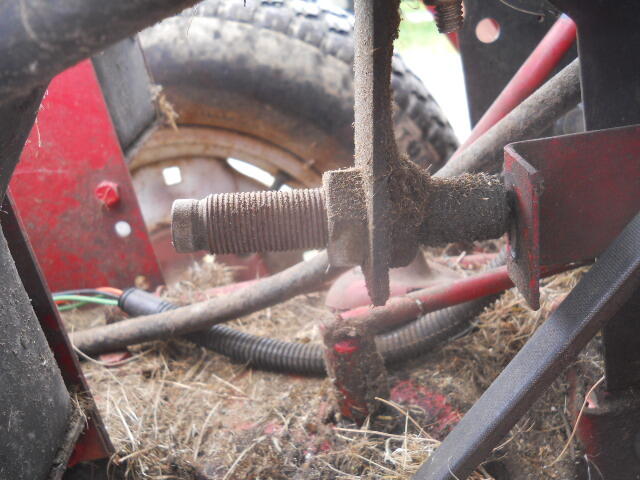

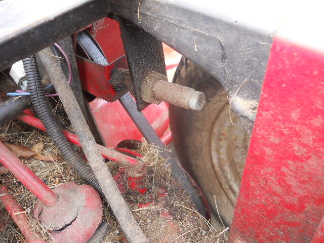

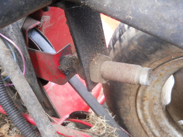

screech 18 #1 Posted August 25, 2025 This is on my 312-8. It is not on my other Wheel Horse Tractors. What is it for, I can not find it on any part diagrams. Thank You! Share this post Link to post Share on other sites
Ed Kennell 47,946 #2 Posted August 25, 2025 Clutch damper that slows the engagement of the belt. Safety feature that prevents a quick start that may flip the tractor over. 1 Share this post Link to post Share on other sites
screech 18 #3 Posted August 25, 2025 3 minutes ago, Ed Kennell said: Clutch damper that slows the engagement of the belt. Safety feature that prevents a quick start that may flip the tractor over. Thank You, Why is it not on my newer tractors and not on any parts lists? Share this post Link to post Share on other sites
Ed Kennell 47,946 #4 Posted August 25, 2025 3 minutes ago, screech said: Thank You, Why is it not on my newer tractors and not on any parts lists? Probably one of several Wheel Horse ideas where the benefit did not justify the cost. Anti vibration shaker plate engine mounts are another example. 2 Share this post Link to post Share on other sites
ri702bill 13,393 #5 Posted August 25, 2025 It is a cousin to gas hood or trunk struts. Over time it is destined to fail..... Share this post Link to post Share on other sites
gwest_ca-(File Mod) 12,557 #6 Posted August 25, 2025 Item #53 on this page. I call it an air shock. If you take it off and clean it out it will likely function OK. Debris plugs up the holes that allows air to enter and exit. https://www.partstree.com/models/31-12k801-312-8-toro-garden-tractor-1990/clutch-brake-and-speed-control-linkage-4/ 2 Share this post Link to post Share on other sites
Ed Kennell 47,946 #7 Posted August 25, 2025 A word of caution. Make sure it is adjusted properly. If the belt is too long, it can allow the contact plate to pass below the piston pin. The spring loaded piston pin then pops out and locks the clutch in the engaged position and will not allow the clutch pedal to be depressed. And of course the clutch pedal switch prevents the tractor from starting. How do I know? I bought a 310-8 sight unseen for scrap price. The ad said the clutch and transmission are locked up and the tractor will not start. It took about an hour to replace the worn belt and clean and adjust the damper. Oh, it came with a 4yo 42"SD deck. Runs and mows great. 3 Share this post Link to post Share on other sites
