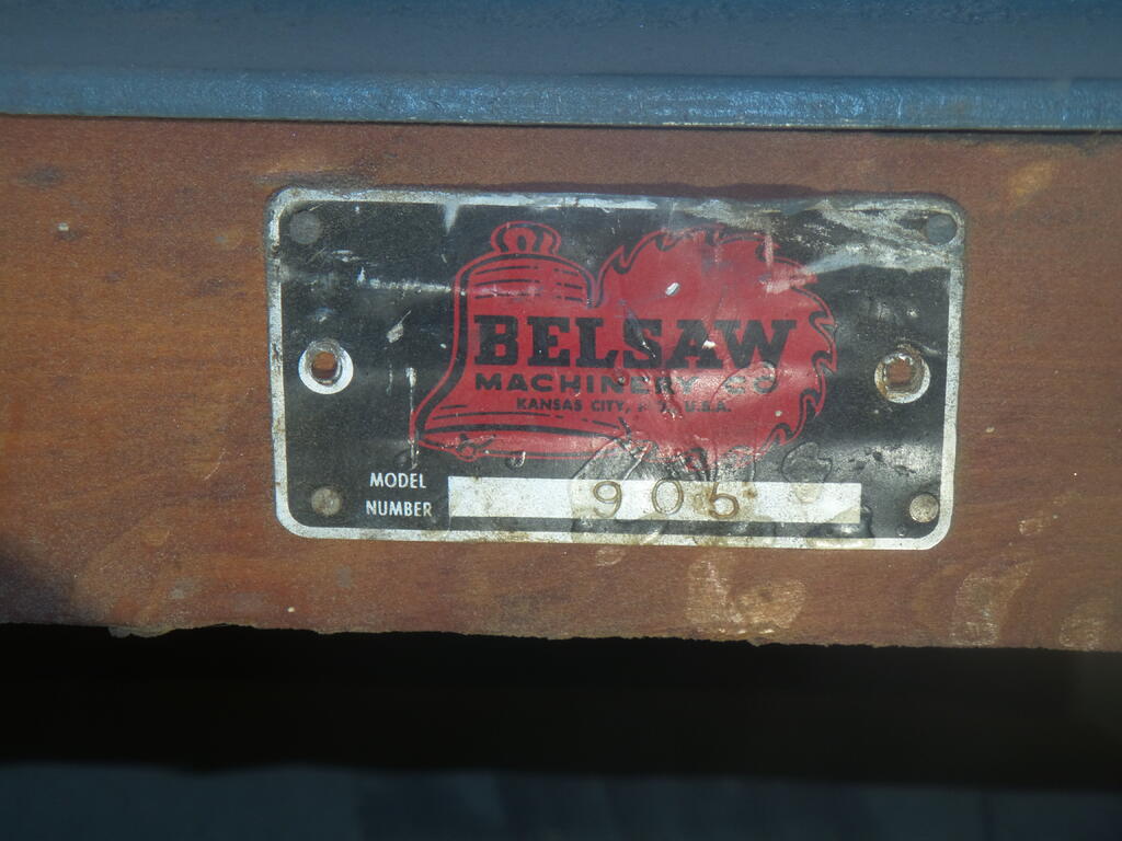

Belsaw 905 Planer
bc_gold

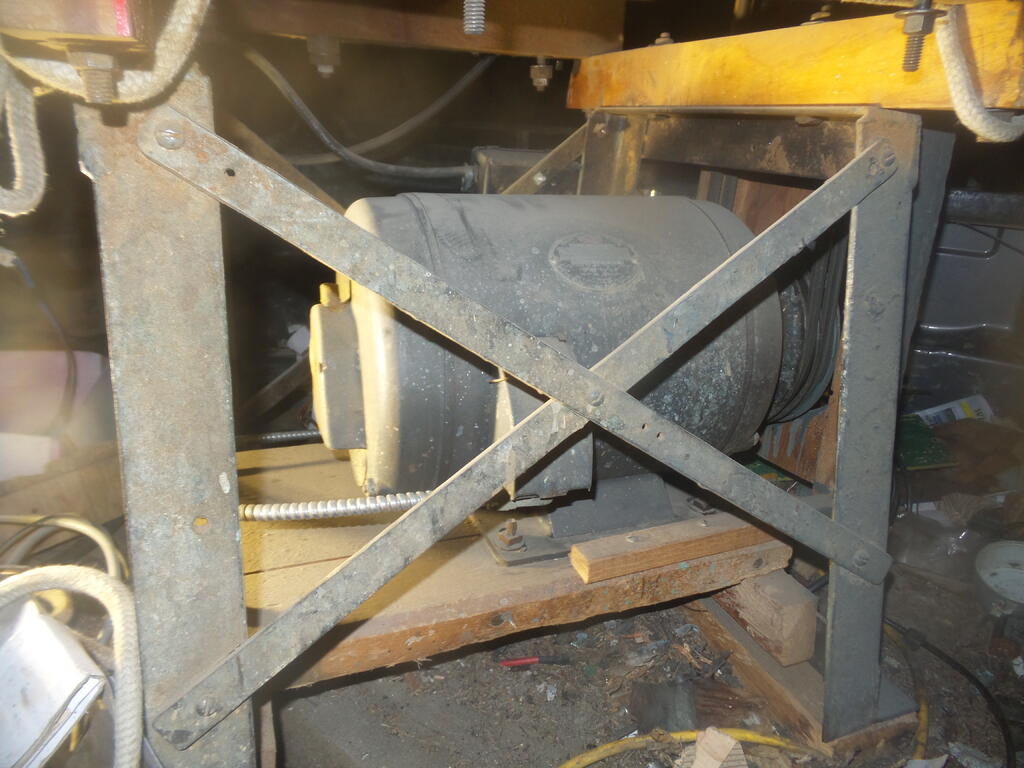

12 inch Belsaw wood planer Mfg mid 1940's making this planer older than me.
2 hp repulsion induction motor.

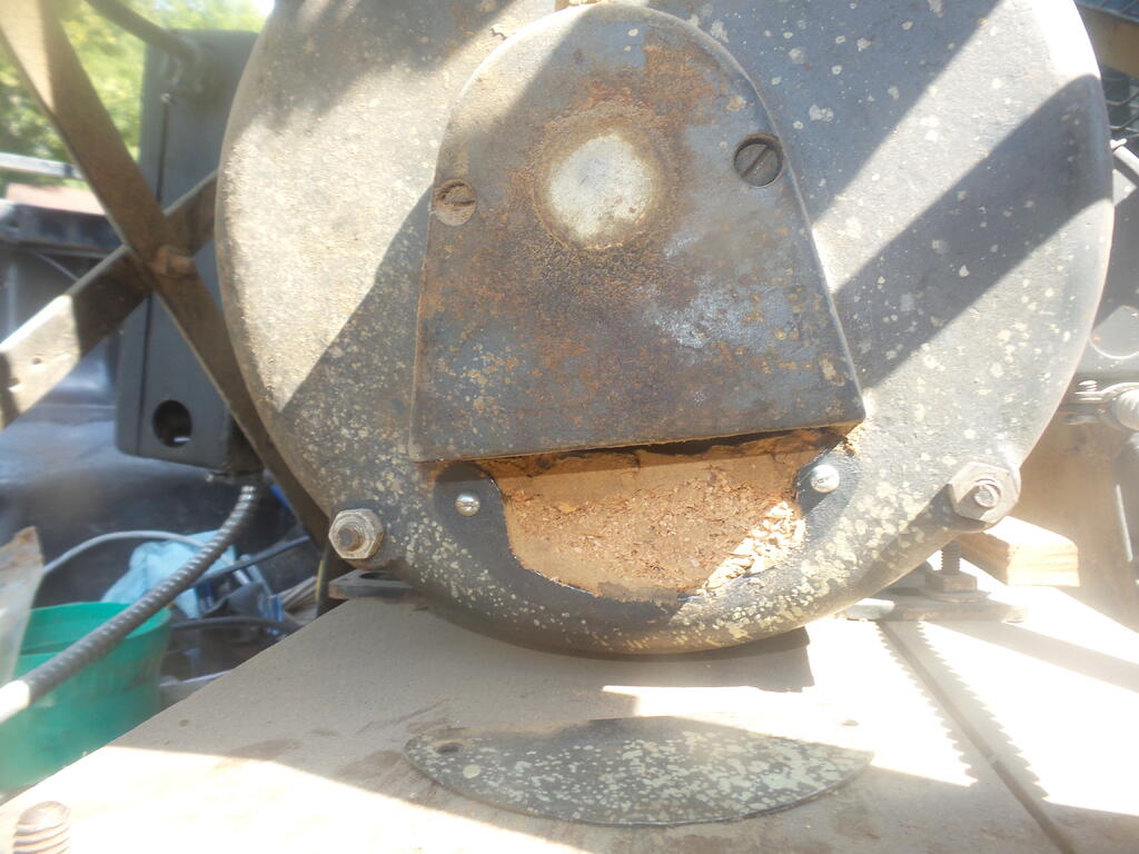

I think the excess of sawdust hangs the brushes up in their holders.
