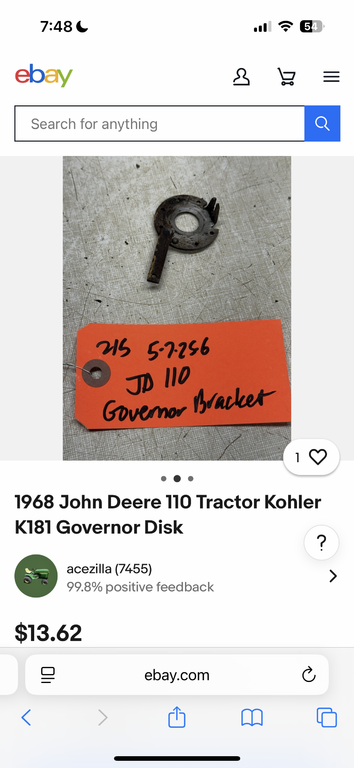

1968Commando 189 #1 Posted August 24, 2025 Hello all, my wheel horse has very poor throttle adjustment and saw that if you have a governor disc with a tab on it, it works better will this work? Share this post Link to post Share on other sites
Racinbob 13,210 #2 Posted August 24, 2025 That should work fine. I modify them myself. It makes a world of difference. Share this post Link to post Share on other sites
ri702bill 13,162 #3 Posted August 24, 2025 Yup, that's the one. the spring locks into the notched tab. Sometimes the tab breaks...... Share this post Link to post Share on other sites
