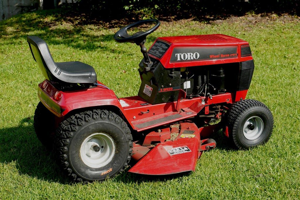

OldNoob 27 #1 Posted August 21, 2025 (edited) Greetings All. I've been tweaking on this WH 210-5 for about a month now. I have Replaced the tires Added bearing wheels to the front. Repaired the drag link Tightened the steering Replaced the blades Repacked the Idler pulley bearings on the deck Replaced the seat Leveled the Deck. I am currently examining a problem with the PTO that kills the engine when engaged at lower RPMs. I pretty much have to have the RPMs all the way up to engage the deck and then i can lower the idle after the deck is engaged. The Spindles spin freely the idler pulley turns smoothly. Im wondering if this is a Carb issue or a PTO issue or even possibly a electrical issue? What do you think? Edited August 21, 2025 by OldNoob Share this post Link to post Share on other sites

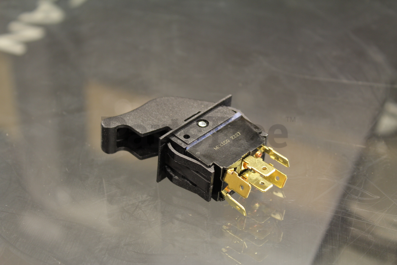

OldNoob 27 #9 Posted August 23, 2025 Ok another dumb question.. Does anyone know if the PTO switch is the same as a normal 20amp six connector toggle?? I've noticed the PTO toggle switch is really loose "floppy" for lack of a better word and was thinking about replacing it.. but at 135 bucks the OEM switch is WAYYY to expensive for me . https://www.partstree.com/parts/toro-78-3030/ Share this post Link to post Share on other sites
OldNoob 27 #10 Posted August 23, 2025 On 8/21/2025 at 7:06 PM, ri702bill said: Basic questions - are the blades sharp and not installed upside down??? Yes the blades are bran new and and mulcher fin is up. I suspect it may be something inherent with the low power 10hp motor simply doesn't have enough low end torque to keep running when engaging the deck at anything other that high speed. It just may be the way it is with this low end model. Share this post Link to post Share on other sites
gwest_ca-(File Mod) 12,320 #11 Posted August 23, 2025 Click on the picture in this link. There is a switch function page there. 1 Share this post Link to post Share on other sites
