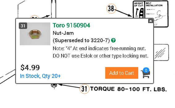

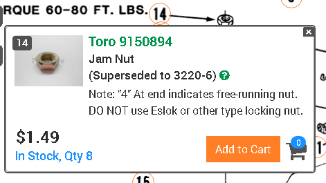

JoeM 10,268 #2 Posted August 21, 2025 The top nut that holds on the pulley the bottom nut that holds on the blade. 1 Share this post Link to post Share on other sites

kthomas62 46 #5 Posted August 21, 2025 5 hours ago, JoeM said: The top nut that holds on the pulley the bottom nut that holds on the blade. Thank you 1 Share this post Link to post Share on other sites
