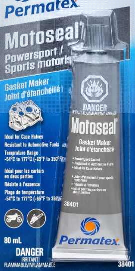

JoeM 10,155 #7 Posted August 20, 2025 Just now, lynnmor said: hardening pipe thread compound I have had good results with MotoSeal I know it's a gasket maker but it locks into threads and works great. As far as the cap or plug just plain thread tape for those. I also used it on a couple old briggs carb bases that mount to the tank. The early ones have one less mounting screw and can be hard to seal. Resistant to gas. 1 Share this post Link to post Share on other sites
lynnmor 9,010 #8 Posted August 20, 2025 2 minutes ago, JoeM said: I have had good results with MotoSeal I know it's a gasket maker but it locks into threads and works great. As far as the cap or plug just plain thread tape for those. I also used it on a couple old briggs carb bases that mount to the tank. The early ones have one less mounting screw and can be hard to seal. Resistant to gas. I use Motoseal, it is good stuff for some applications. The problem with the oil drain pipes is vibration and usually the pipe is hanging in a position that will loosen it. Once it moves a bit, that is the beginning of a failure. That is why I use a more permanent compound to lock it in place. The red thread locker can be loosened, if necessary heat with a torch. 1 Share this post Link to post Share on other sites
