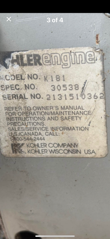

Sparky-(Admin) 26,484 #1 Posted August 19, 2025 This is one of those gray factory replacement engines. Anything anyone can tell me from the data decal other than its an 8hp. 1 Share this post Link to post Share on other sites
gwest_ca-(File Mod) 12,505 #2 Posted August 19, 2025 It was made in 1991. Here is an illustrated parts list https://www.partstree.com/models/k181-30538-kohler-k-series-engine-service-version-8hp-6kw 2 1 Share this post Link to post Share on other sites

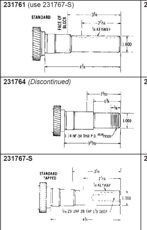

ri702bill 13,162 #3 Posted August 19, 2025 Tapered output shaft per the diagram - inline axial load from generator Not meant for pulley side load.. Not a good overall choice for a WH. If it's free -then carb, head, valves, etc are spare parts. Maybe the block too.... 2 1 Share this post Link to post Share on other sites
ebinmaine 80,881 #4 Posted August 20, 2025 12 hours ago, ri702bill said: - inline axial load from generator Not meant for pulley side load.. Not a good overall choice for a WH. How do you determine that? Looks like the crankcase picture shows two different side covers? One shows a ball bearing which is what I understood is side load compatible? The other is unclear to me. Share this post Link to post Share on other sites
pfrederi 21,215 #5 Posted August 20, 2025 It is a service engine It has Ball Bearings on the crank 231625 The crank is a straight crank 231797s for some reason the picture in the manual is bad but it is very similar to 231761 Should work fine for a WH 1 Share this post Link to post Share on other sites
ri702bill 13,162 #6 Posted August 20, 2025 I based my text upon the Partstree diagram.... that showed the tapered generator style shaft. Straight shaft - good. Ball bearing for side load - very good. Share this post Link to post Share on other sites
