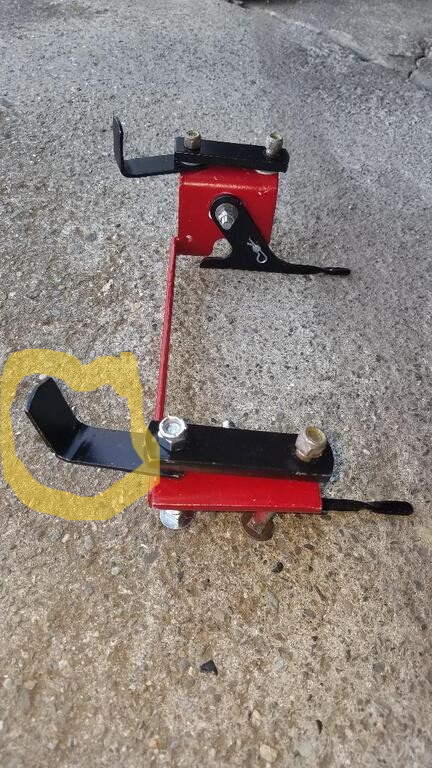

Brockport Bill 2,407 #51 Posted August 24, 2025 12 hours ago, Ed Kennell said: What is this for Bill @Brockport Bill here is an answer to the question about those two elbow type pieces that go with the rear axle bracket for plows (see photos) -- they are indicated in the manual for plows as an "angle spacer" ( part # 7713 ) for "8 speed tractors" -- interesting because i have had a plow on a 312-8 for decades and i never found the need for them -- Curiously, the WH plow manual doesn't say or show how to install or in what alignment -- however, if you go to partstree.com their parts diagram will show the proper alignment for installation use. Here is photo also of an ad on ebay of some rear axle bracket parts which includes those two "spacers" 1 1 Share this post Link to post Share on other sites
c-series don 12,045 #52 Posted August 25, 2025 @Brockport BillOkay, so I’m still not sure where they go? I tried putting them on my C-101 and couldn’t figure out how they went on, got frustrated and installed the axle bracket without them. I’ve installed them on 8-speeds before not even knowing about those little pieces and never had an issue. 2 1 Share this post Link to post Share on other sites
Dan 312-8 571 #53 Posted August 25, 2025 In over 30 years of plowing snow, all on 8 speeds, I have never seen, much less installed these on my tractors. Tractors include C-120, 310-8, 416-8, & 312-8. 2 Share this post Link to post Share on other sites
Brockport Bill 2,407 #55 Posted August 25, 2025 13 hours ago, c-series don said: @Brockport BillOkay, so I’m still not sure where they go? I tried putting them on my C-101 and couldn’t figure out how they went on, got frustrated and installed the axle bracket without them. I’ve installed them on 8-speeds before not even knowing about those little pieces and never had an issue. agreed it's a weird WH engineering for that axle bracket "spacer" as they call them -- as i noted with my 312-8 i never used them but for those wondering here is the actual WH diagram that shows how they intended the "spacer" as they called it -- tried to download image but not sure it loaded - -but you can see their alignment on the partstree site if you enter part # 104659 - - at top left corner part image # 31 Toro 79350 - Toro 48_ Snow_Dozer Blade (SN_ 210000001 - 210999999) (2001) FRAME ASSEMBLY Parts Lookup with Diagrams _ PartsTree.html Share this post Link to post Share on other sites
Ed Kennell 46,462 #56 Posted August 25, 2025 So, it adds the spacer thickness to the top and rear sides of the axle housing. Never seen one till now. The old dog is still learning. 2 Share this post Link to post Share on other sites
pfrederi 20,823 #57 Posted August 25, 2025 Hydro axle housings are bigger than Gear drives. Basic bracket was made big enough to do the hydro spacer used for gear drives. 1 Share this post Link to post Share on other sites
Dan 312-8 571 #58 Posted August 26, 2025 On 8/25/2025 at 10:57 AM, Ed Kennell said: So, it adds the spacer thickness to the top and rear sides of the axle housing. Never seen one till now. The old dog is still learning. So apparently it will automatically center the bracket to the axle fore and aft. So, if it they had marketed as an eyestrain saver for us "older" guys who would struggle reading a ruler, scale or tape measure while laying under our tractors, we would all probably be familiar with them... 2 Share this post Link to post Share on other sites
