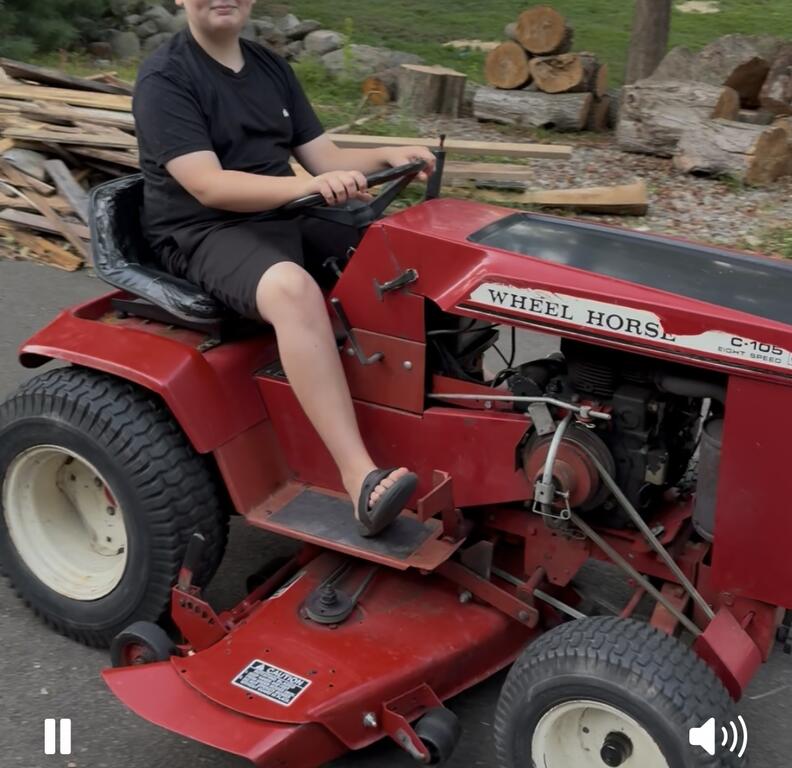

Awd79 31 #18 Posted August 23, 2025 My first wheel horse. Could not be happier. Boys love her too. we don’t get a ton of snow in ct but I’d like to get a plow or blower. I was given a like new ariens that I’m sure just needs car overhaul. This will always do a better job sure. But I was thinking of selling for cash in which case I need a plow or blower. Is one better than another. I see single stage blowers but not sure what fits my c105 1 1 Share this post Link to post Share on other sites
OutdoorEnvy 1,817 #19 Posted August 23, 2025 Solid choice! single kohlers and 8 speed manual trans are the tried and true simple rigs that just keep going. Just be careful though as it may need a friend in the future. Your boys each having their own too will make sense at some point Share this post Link to post Share on other sites
