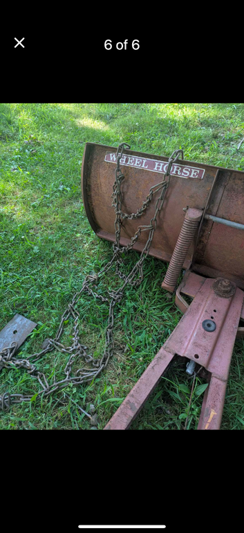

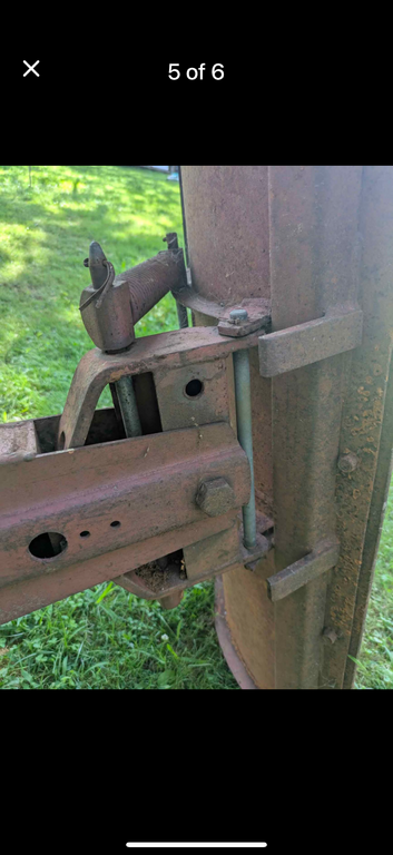

Ed Kennell 47,351 #28 Posted August 24, 2025 A new wear bar is a plus. I don't see the triangle shaped piece that connects the wires to pull the angle locking pin or lift link. Share this post Link to post Share on other sites
Awd79 31 #32 Posted August 24, 2025 These were all the pics. I will ask him. he has rear mounts I need as well. Share this post Link to post Share on other sites
Ed Kennell 47,351 #33 Posted August 24, 2025 Those two missing parts are pretty easy to make, but maybe could be used to negotiate for a free axle bracket. 1 Share this post Link to post Share on other sites

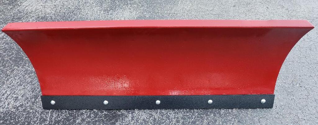

Brockport Bill 2,478 #34 Posted August 24, 2025 suggest for the plow blade to use a grinder sander disc, or sand blast, or sand the rust off front of blade and then prime and paint -- Reducing friction so snow, slush etc peel away is your goal. Also consider oil spay, or car wax, on blade for more efficient clearing of snow - Oh yeah - - suggest anything deeper than 6 inches take half a blade on angle and don't ask the blade or tractor to be a bulldozer -- here are a few blade photos i did rehab Share this post Link to post Share on other sites

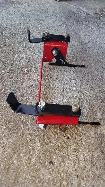

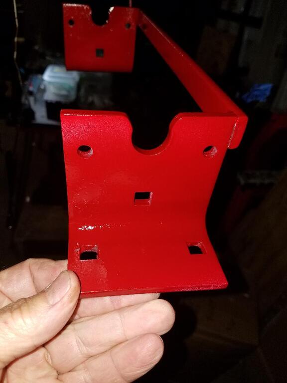

Brockport Bill 2,478 #35 Posted August 24, 2025 here is rear axle bracket you will need -- i rehab mine - not that it improves function but sometimes pretty is better 1 Share this post Link to post Share on other sites

Ed Kennell 47,351 #37 Posted August 24, 2025 (edited) What is this for Bill @Brockport Bill Edited August 24, 2025 by Ed Kennell Share this post Link to post Share on other sites

Ed Kennell 47,351 #44 Posted August 24, 2025 (edited) 30 minutes ago, Awd79 said: would that change your mind? No brainer, buy the plow. Those couple missing parts are easy to make if he doesn't have them. I don't see the triangle piece or the rod to angle the plow. Edited August 24, 2025 by Ed Kennell Share this post Link to post Share on other sites

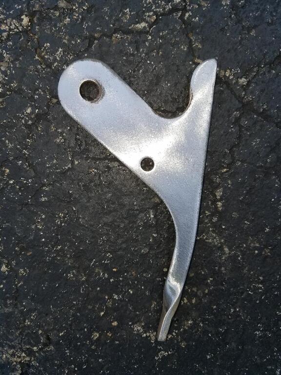

Ed Kennell 47,351 #46 Posted August 24, 2025 These are the two parts that I don't see in the pictures. They tend to get misplaced when a plow is removed from a tractor. 2 Share this post Link to post Share on other sites
rjg854 13,359 #47 Posted August 24, 2025 6 hours ago, Awd79 said: Does he have the flag and the lift bar for it, I don't see them in the picture. 1 Share this post Link to post Share on other sites

Brockport Bill 2,478 #49 Posted August 24, 2025 12 hours ago, Ed Kennell said: What is this for Bill @Brockport Bill interesting question - it seems like one of those obscure parts that beg a question -- wh rear axle bracket spacer manual info.htm Share this post Link to post Share on other sites
Awd79 31 #50 Posted August 24, 2025 17 hours ago, Brockport Bill said: suggest for the plow blade to use a grinder sander disc, or sand blast, or sand the rust off front of blade and then prime and paint -- Reducing friction so snow, slush etc peel away is your goal. Also consider oil spay, or car wax, on blade for more efficient clearing of snow - Oh yeah - - suggest anything deeper than 6 inches take half a blade on angle and don't ask the blade or tractor to be a bulldozer -- here are a few blade photos i did rehab Would you suggest a wire wheel or the sander disc as you recommended. any suggested grit. I have wire wheels but happy to grab discs at harbor freight Share this post Link to post Share on other sites
