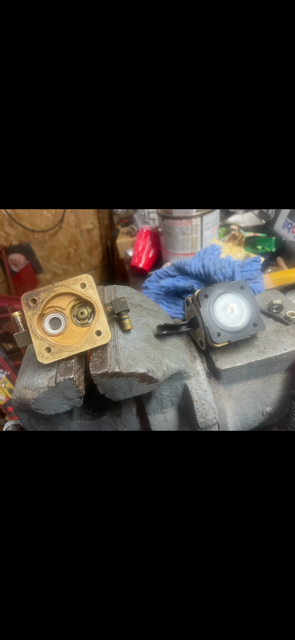

AHS 1,568 #1 Posted August 18, 2025 Kohler M12 fuel pump; ive rebuilt….doing something wrong. Can’t seem to get it to pump. I have the diaphragm slightly off the pump and “locked in”. Im doing everything right? I know it will run! Show me pictures. Teach me! Thank you!! Share this post Link to post Share on other sites

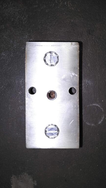

Bill D 2,506 #11 Posted August 20, 2025 Pulse pump mounting plate without the pump. 1 Share this post Link to post Share on other sites

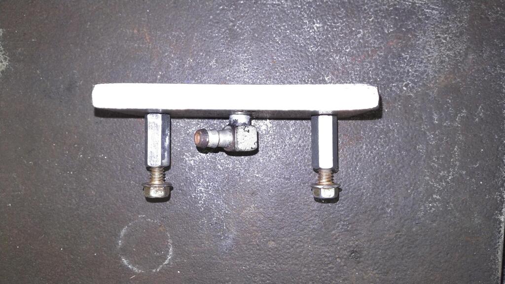

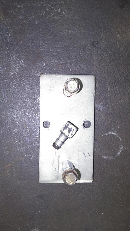

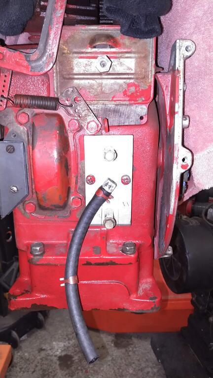

Bill D 2,506 #13 Posted August 20, 2025 7 hours ago, AHS said: @Bill D did you thread the top and bottom holes for the fuel pump? You must have. I understand how you did it. I spent many times pulling the rope on a snowmobile, but it was never cause of the fuel pump!! Here's some better photos of the pump plate. If you have a drill press these are pretty easy to make. I use red loctite on the screws holding the coupling nuts to the plate. I've seen multiple ways of converting old Kohlers to pulse pumps, but most require mounting the pump remotely. The pumps run about $40 at a dealer for OEM Kawasaki pumps which are made in Japan. If you go this route, stay away from the Chinese pumps. 2 Share this post Link to post Share on other sites
AHS 1,568 #14 Posted August 25, 2025 i took the fuel pump apart, and the 1/4” elbows off, and cleaned the fuel pump out with carb cleaner….ALL GOOD!!! Put it all together and took a Piece of clear hose and stuck on the “IN” side and the “carb” side, pumped it…it pumped up good!! Put it on the tractor, and fired it up!! The M12 ran so good!! Thanks guys!!! 1 1 Share this post Link to post Share on other sites
