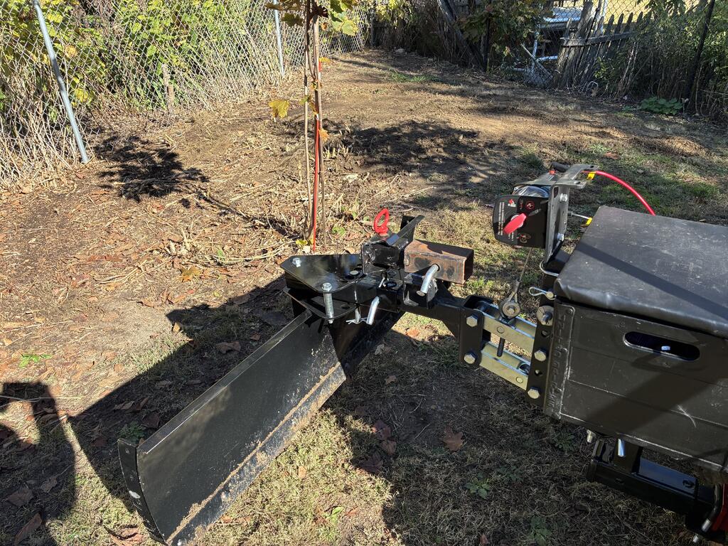

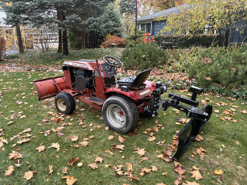

SylvanLakeWH 32,516 #52 Posted October 26, 2025 IMG_8643.mov First try with back blade and rake... blade needs weight but functional. rake tines need to be trimmed 3" to raise / lower adequately. it binds up at top if I don't stop it in time. Thinking need to either add a hard stop or eliminate the parallel function and replace with single 2" square tube that simply pivots on one plane... use pin so I can raise / lower it on the vertical beam. Thoughts appreciated. Oh, and Denali liked the new flat area so much he pooped on it right at the end of the video...!!! IMG_8646.mov IMG_3645.mov 1 1 Share this post Link to post Share on other sites
Handy Don 17,474 #53 Posted October 26, 2025 On 10/24/2025 at 5:53 PM, SylvanLakeWH said: and gonna need a bunch of weight up front With the implement so far to the rear, I’d be concerned about it potential to use its weight/leverage to put very strong bend/twist forces on the tractor. F-plate/frame reinforcement? 1 1 Share this post Link to post Share on other sites
SylvanLakeWH 32,516 #54 Posted October 26, 2025 40 minutes ago, Handy Don said: With the implement so far to the rear, I’d be concerned about it potential to use its weight/leverage to put very strong bend/twist forces on the tractor. F-plate/frame reinforcement? Thank you. I'm not an engineer so I appreciate such input... it's mounted via a 2" hitch from wheel horse parts and more... 1 Share this post Link to post Share on other sites

SylvanLakeWH 32,516 #57 Posted November 7, 2025 Added front blade: 4 Share this post Link to post Share on other sites

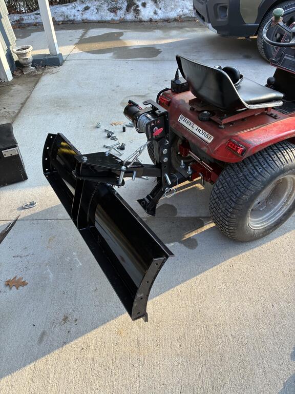

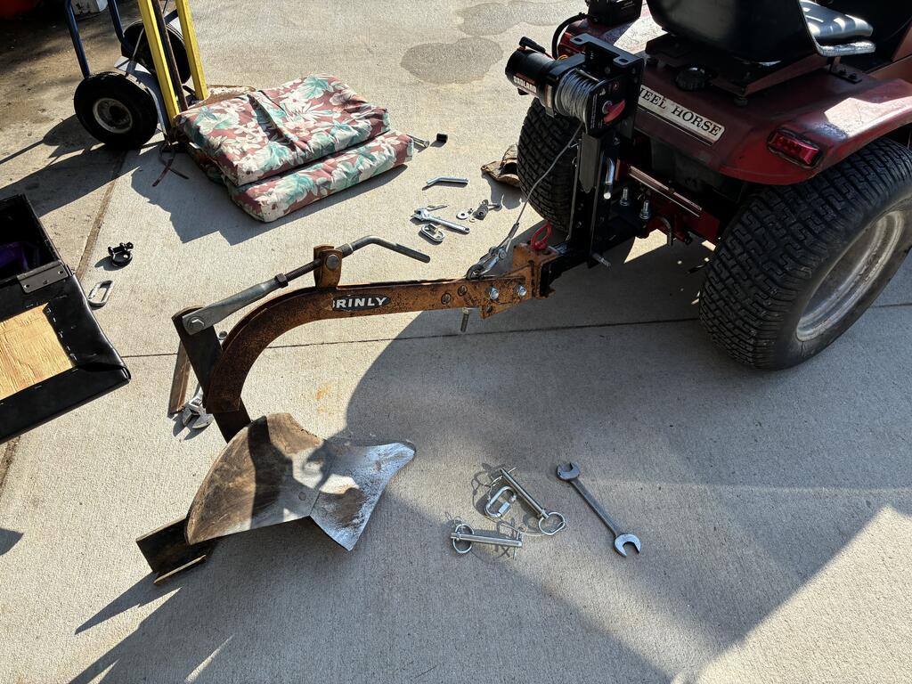

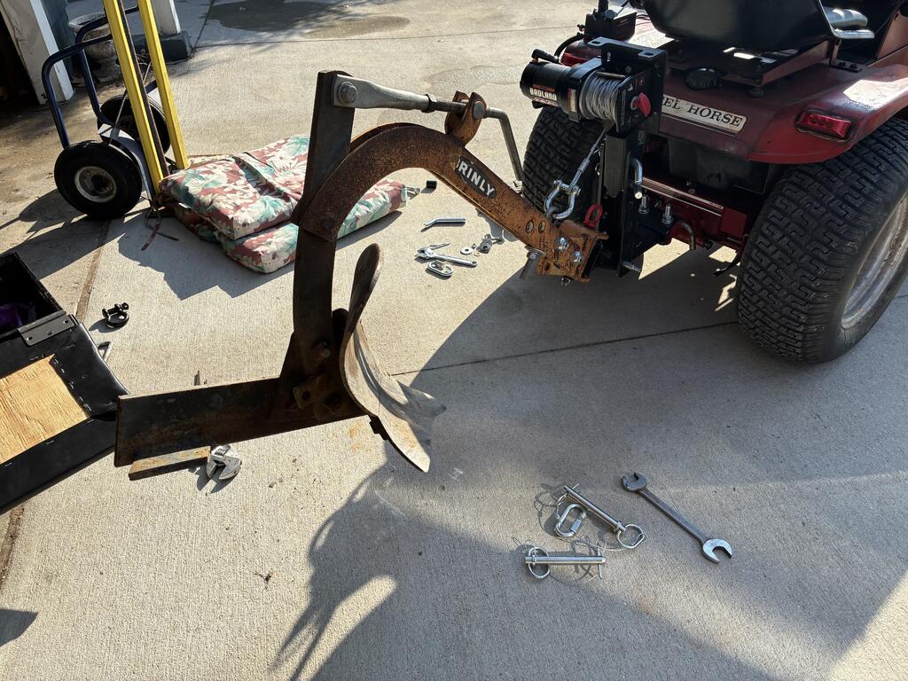

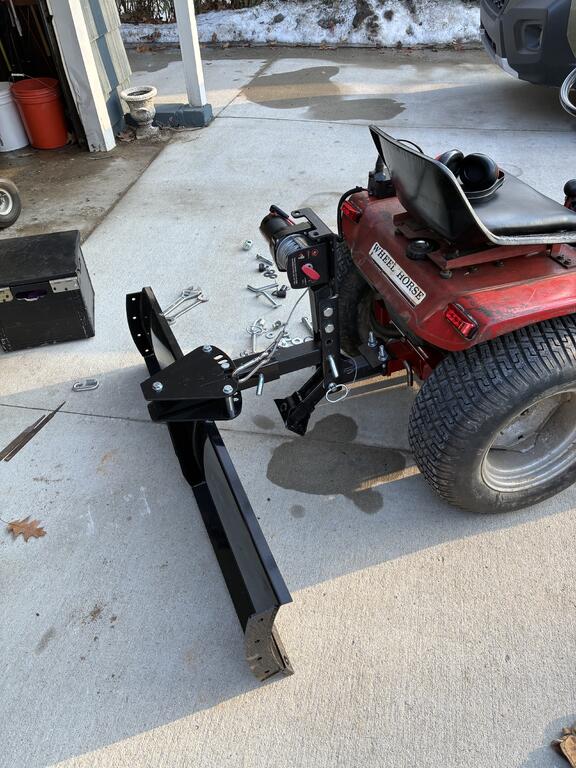

SylvanLakeWH 32,516 #58 Posted February 16 Reconfiguring the rear hitch system... a bit less complicated and far stronger... lower center of gravity, higher lifting of implements. 1 3 Share this post Link to post Share on other sites

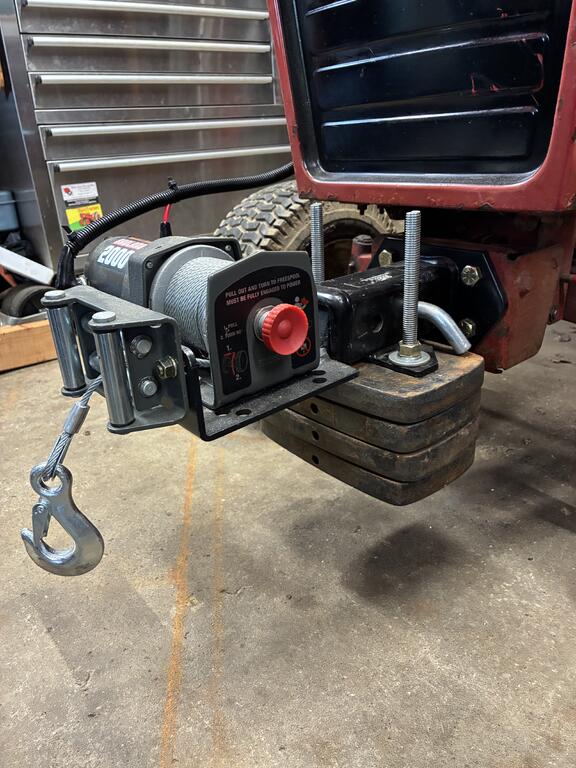

SylvanLakeWH 32,516 #64 Posted September 20 Added permanent weight up front. Gonna keep this as the plow mule and second back up snow rig. B-80 will be for towing kids and back up snow rig. 2 Share this post Link to post Share on other sites
