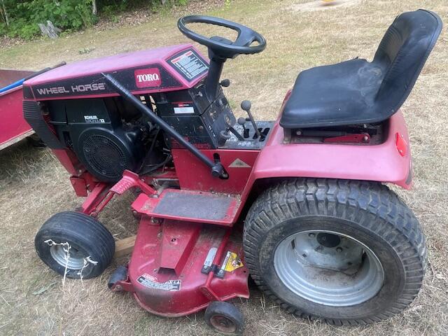

AHS 1,560 #1 Posted August 13 Brand new to me! I just replaced the fuel pump (and its pumping fuel, cleaned the carb), started for 10 minutes then i shut it off…..wait two weeks…. It wont start again, and its pumping fuel from the pump and. It’s filling up the carb bowl, but not getting to the spark plug. I cleaned the carb again, and it’s spotless! What should i do? Replace the head gasket? Replace the carb? BTW.. The story ive heard of the tractor was a very easy life, it was bangor savings banks long ago: it mowed. Their grass and snowblowed their sidewalks… even though it got 0000 on the meter, i have a feeling it’s got less than 300 hours. Then the tractor sat in a field for the rest of the years… and faded!! Share this post Link to post Share on other sites
squonk 44,600 #2 Posted August 13 Is the choke closing all the way? Sat in a field. Mice get in the shroud and chew on the coil wire reducing spark? 1 Share this post Link to post Share on other sites
nylyon-(Admin) 8,315 #3 Posted August 13 Will it fire if you shoot a little brake clean in the carb? 2 Share this post Link to post Share on other sites
clueless 3,318 #4 Posted August 13 There is cleaning the carb, then there is CLEANING the carb, what did you actually do? 2 1 Share this post Link to post Share on other sites
wallfish 18,625 #5 Posted August 13 If it fires with a squirt, it's fuel related. If not, it's spark/ignition related 2 Share this post Link to post Share on other sites
AHS 1,560 #6 Posted August 13 7 hours ago, wallfish said: If it fires with a squirt, it's fuel related. If not, it's spark/ignition related Ok, it fires with fuel. So, carb? Share this post Link to post Share on other sites
AHS 1,560 #7 Posted August 13 7 hours ago, clueless said: There is cleaning the carb, then there is CLEANING the carb, what did you actually do? Cleaned the carb good w/ carb cleaner. Took out the jets and sprayed thru the passage. I hate to buy a carb off ebay, (isavetractors tractors is all out of them!) Share this post Link to post Share on other sites
AHS 1,560 #8 Posted August 13 8 hours ago, nylyon said: Will it fire if you shoot a little brake clean in the carb? I haven’t tried thru the carb, but in the head it will. I’ll check that this morning. Share this post Link to post Share on other sites
Pullstart 68,171 #9 Posted August 13 Valve adjustment? Share this post Link to post Share on other sites
nylyon-(Admin) 8,315 #10 Posted August 13 If it’s running with the brake clean, then you have a fuel issue. Since you said that the fuel pump is pumping to the carb AND that the bowl is filling, then I would assume there is a blockage inside of the carb. When you cleaned it, did you run small wire through the passage ways and blow out with compressed air? 3 Share this post Link to post Share on other sites

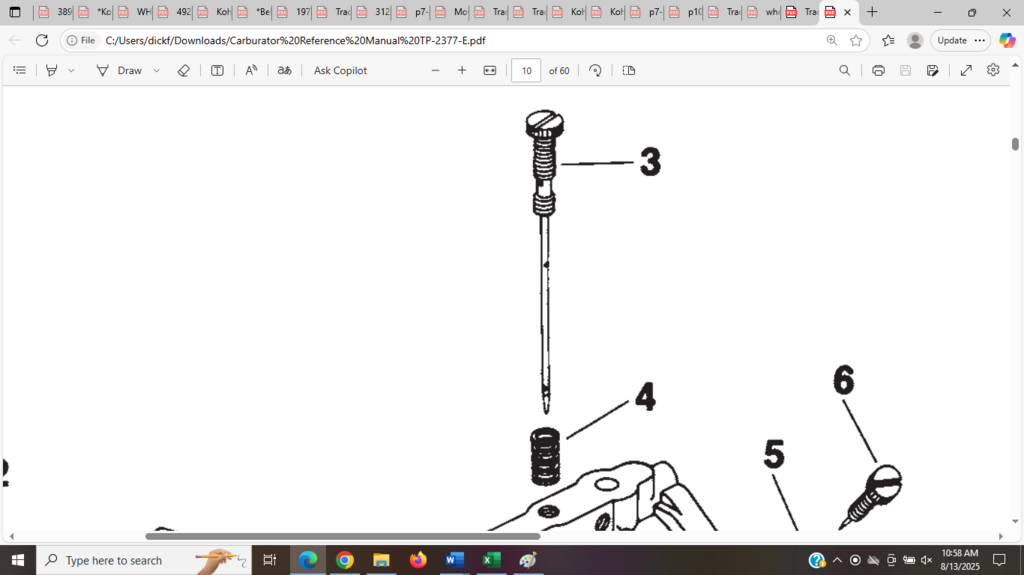

953 nut 62,142 #12 Posted August 13 5 hours ago, AHS said: Took out the jets and sprayed thru the passage Did you soak the High Speed Needle and make sure its passages are clean? It is actually a tube with holes at the top, middle, and bottom which determines the amount of fuel by comparing the atmospheric pressure to the pressure in the venturi. If it ain't right the fuel flow won't be either. @ebinmaine did a great job of documenting a proper carburetor rebuild. 4 1 Share this post Link to post Share on other sites
