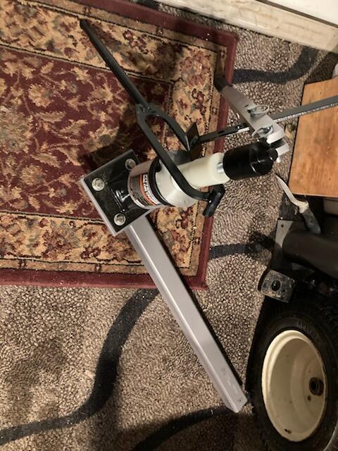

ebinmaine 77,075 #1 Posted August 9, 2025 I've being asked a few times both here on Redsquare and in person how I set this up. To give credit where it's due, this is an idea that I got from this site. I believe it was Richard @953 nut. Could have been others so I apologize if I'm forgetting someone. 6 3 2 Share this post Link to post Share on other sites

John2189 561 #5 Posted August 10, 2025 Nice. I’ve been using a piece of all thread nuts and washers in a vice similar to that for years. 2 1 Share this post Link to post Share on other sites

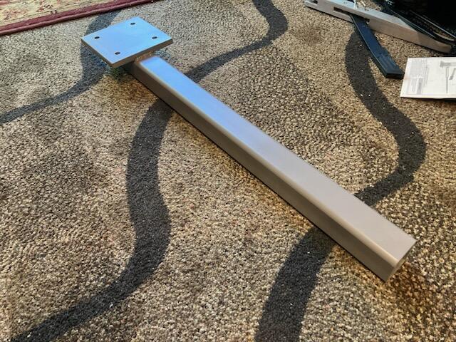

ineedanother 1,835 #6 Posted August 15, 2025 I was doing something similar and welded a piece of flat steel to the all-thread so the vise would hold it better. The issue I had was that I'm 5'9" and had to work at shoulder height. I finally broke down and got a mini changer from HF a couple weeks ago when a single item was 20% off. That made it under $50 so I talked myself into it. I went by the metal supermarket and picked up a length of 2" channel and a 5 x 5 piece of 1/4". That was another $25 but I was kinda pot committed at that point. Drilled 4 holes, welded it together and shot it with some granite gray. Works much better for my short self 1 3 Share this post Link to post Share on other sites

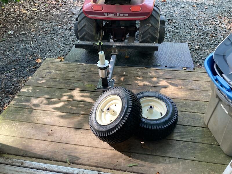

ineedanother 1,835 #8 Posted August 15, 2025 33 minutes ago, ebinmaine said: Niiiiice! Mounting some of those $5 Carlisle tires! 2 Share this post Link to post Share on other sites
Lee1977 7,544 #9 Posted October 3, 2025 I use a 1 1/4" in the vice if the wheel bearings are removed. The vice grips and a couple pieces of plywood also help. I have another trick when mounting old stiff 8" or 6ply 8's. Don't have a picture, but I use a braded rope tie down that I hook in the tire to keep the tire from slipping off when I move the tire tool. The other end of the is hooked on a drill press mounted on the other end of the work bench. Once I get the tire on far enough that it isn't slipping back off I loosen and remove it. 1 Share this post Link to post Share on other sites
Spareparts 92 #10 Posted December 22, 2025 I like that, would work great on the receiver hitch when you have to repair replace a tire at the Garden Tractor Pull 1 Share this post Link to post Share on other sites
