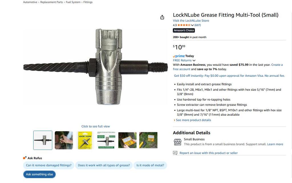

pfrederi 20,867 #3 Posted August 10, 2025 I use one of these 2 Share this post Link to post Share on other sites
