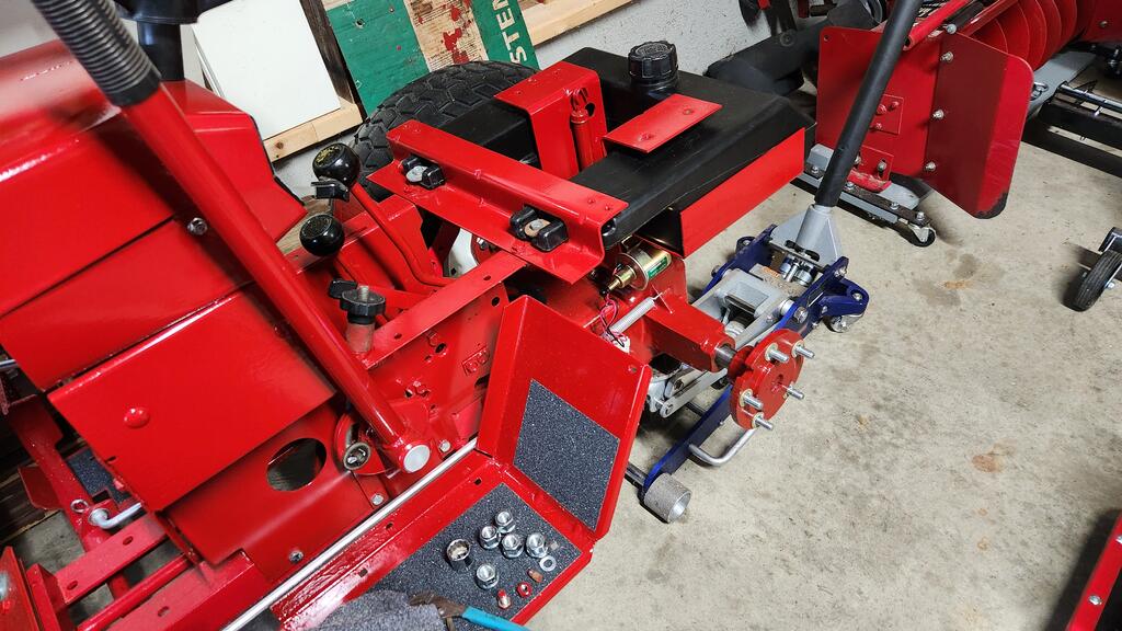

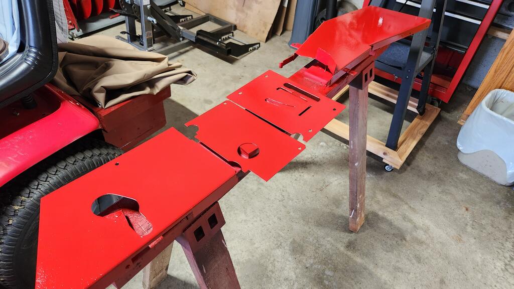

Racinbob 13,192 #1 Posted August 8, 2025 (edited) Just another quick update here to let you know I haven't abandoned it. Summertime priorities have kept me pretty busy on other projects. An abnormally hot and humid July kept me from painting the sheetmetal. I finally got a couple days and took advantage. 2 parts Rusty Regal, 1 part mineral spirits and a dose of Majic hardener. I did spray the wheels with the cheap Harbor HVLP gun but this was my first attempt at the sheet metal. It's far from perfect but not bad. This morning I mounted the electric fuel pump before I bolted down the fender pan. It's now just a matter of putting the pieces back together. How long should I wait before I put the decals on? Edited August 8, 2025 by Racinbob 2 1 1 Share this post Link to post Share on other sites
