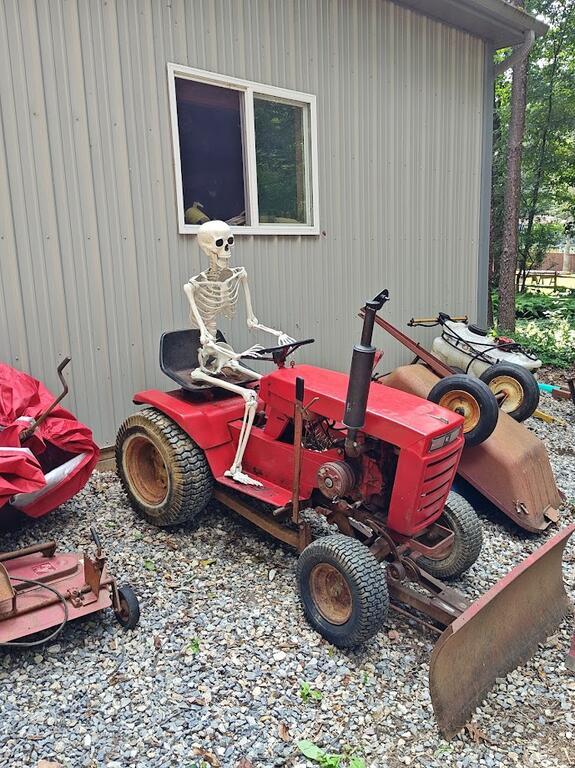

rmaynard 16,866 #1 Posted August 8, 2025 I just acquired a 1971 Raider 10 with an HH-100 engine. The engine has not run for a couple of years. Other than all the obvious things to check, does the HH-100 have any particular quirks that I should be aware of? Share this post Link to post Share on other sites

rmaynard 16,866 #3 Posted August 13, 2025 On 8/8/2025 at 10:58 AM, RED-Z06 said: The big issue with older Tecs has been their Solid State ignition but that one probably has points Nope, it has a non-working solid state ignition. Checked the secondary side and have 5600 ohms. Primary is open. Share this post Link to post Share on other sites

rmaynard 16,866 #5 Posted August 13, 2025 15 minutes ago, RED-Z06 said: Ouch, thats unfortunate. Yes it is. I guess I am going to have to try and build my own ignition system. Share this post Link to post Share on other sites

rmaynard 16,866 #10 Posted September 12, 2025 It's alive! Installed the coil I received from @Easton Rich, cleaned the carburetor, and ran the starter. It fired right up. 3 3 1 Share this post Link to post Share on other sites

rmaynard 16,866 #13 Posted September 15, 2025 Currently rewiring the whole thing. A previous owner had 14ga wire going from the ignition switch to the starter. Obviously that wire was melted, as well as the five-pin connector. Hopefully I will have it ready for a little seat time soon. 1 1 Share this post Link to post Share on other sites

rmaynard 16,866 #17 Posted September 15, 2025 (edited) Just to repeat, this Horse was obtained for zero dollars. I don't intend to put much into it as it was only meant to be a temporary lawn ornament for Halloween. Getting the engine to run was not necessary, but helps to make it easier to move it around. Edited September 15, 2025 by rmaynard 1 1 Share this post Link to post Share on other sites

rmaynard 16,866 #19 Posted September 15, 2025 Well, it runs. It's an oil burner. But that doesn't matter. As long as it goes under it's own power to move it to the front of the house. VID_20250915_153007755.mp4 1 Share this post Link to post Share on other sites
