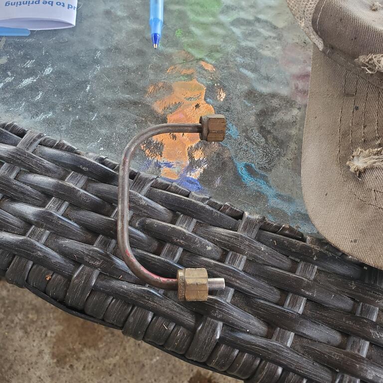

Cjwv1975 117 #1 Posted August 8, 2025 Ive never messed with a vacuum fuel pump which I assume I have. This tubing pulled right out of nuts. That isnt normal right? Also the rubber inside those nuts looks pretty bad. What do I replace it with if anything. Thanks 1 Share this post Link to post Share on other sites
ebinmaine 76,501 #2 Posted August 8, 2025 8 minutes ago, Cjwv1975 said: rubber inside those nuts looks pretty bad. What do I replace it with if anything. Thanks @Achto recommended something to me a few years ago. Harley parts i think 🤔 Share this post Link to post Share on other sites
Cjwv1975 117 #3 Posted August 8, 2025 25 minutes ago, ebinmaine said: @Achto recommended something to me a few years ago. Harley parts i think 🤔 Like as in Harley Davidson parts? 2 Share this post Link to post Share on other sites
ebinmaine 76,501 #4 Posted August 8, 2025 6 hours ago, Cjwv1975 said: Like as in Harley Davidson parts? Correct. They're a little O ring that has a different shape. I have a bag around here. With the workshop and apartment move some things are yet to be organized. If I can find them I could send you a few. 1 Share this post Link to post Share on other sites

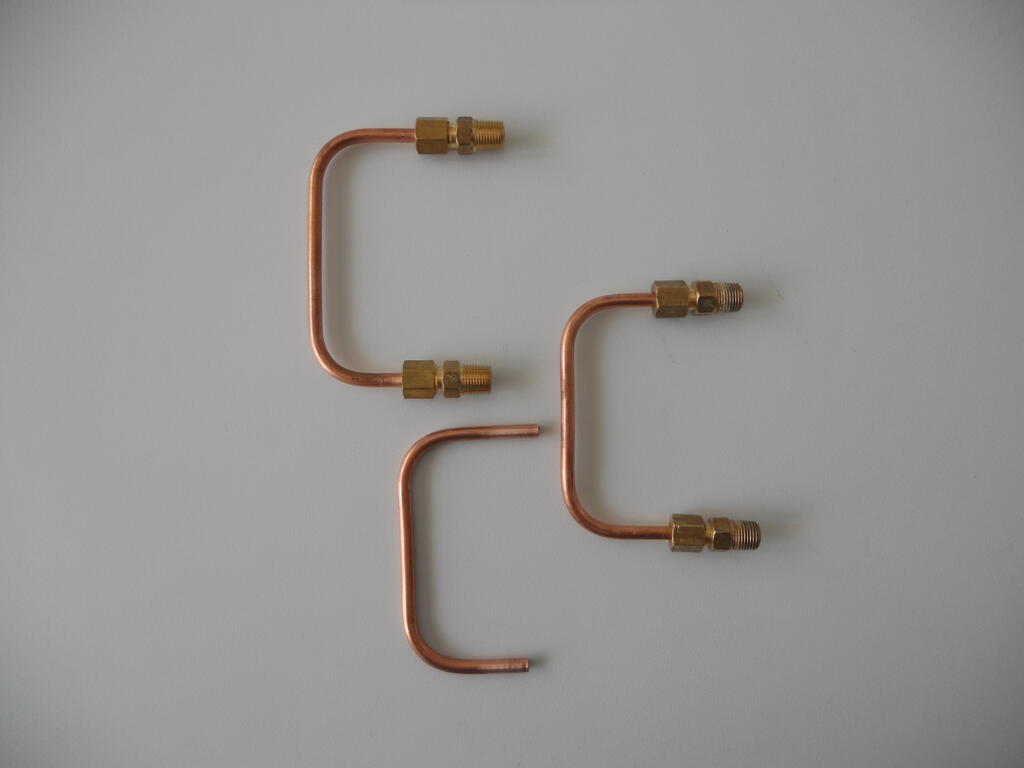

Racinbob 12,503 #5 Posted August 8, 2025 These compression fittings are readily available. I picked up a small tubing bender to make the fuel line. 3 2 Share this post Link to post Share on other sites
ebinmaine 76,501 #6 Posted August 8, 2025 43 minutes ago, Racinbob said: These compression fittings are readily available. I picked up a small tubing bender to make the fuel line. Nice work there Bob! 1 1 Share this post Link to post Share on other sites
Achto 30,435 #7 Posted August 8, 2025 9 hours ago, ebinmaine said: @Achto recommended something to me a few years ago. 9 hours ago, Cjwv1975 said: Like as in Harley Davidson parts? Rocker box oil line seals for a Panhead or Shovelhead. If you go to a dealership or a bike shop do not buy the orange colored ones, they will fall apart. These are the ones that I use. https://www.jamesgaskets.com/products/jgi-63529-57-seal-oil-line 2 Share this post Link to post Share on other sites
953 nut 63,546 #8 Posted August 8, 2025 They are a 3/16 compression Viton sleeve, take your pick. https://www.google.com/search?q=3%2F16+compression+viton+sleeve&rlz=1C1JZAP_enUS981US981&oq=3%2F16+compression+viton+sleeve&gs_lcrp=EgZjaHJvbWUyBggAEEUYOTIHCAEQIRigATIHCAIQIRigATIHCAMQIRiPAtIBCTI3NzU0ajBqN6gCALACAA&sourceid=chrome&ie=UTF-8 Share this post Link to post Share on other sites
peter lena 9,642 #9 Posted August 8, 2025 @Racinbob, you can't do that ! just teasing you , regularly revert to something to eliminate the issue . if you are a purest , it can't be done . frequently refer to , the functional re make on a problem spot . more often than not its been trouble free and easily worth the change . REPEDITIVE FAILURES , are your que , love those , take the time to really study what's going on , make the change , pete Share this post Link to post Share on other sites

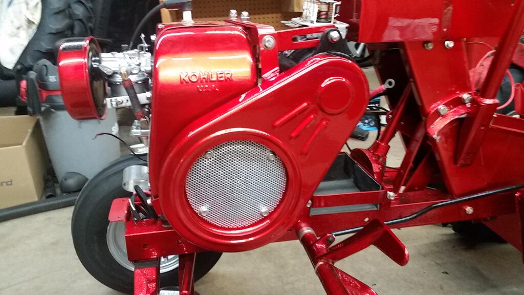

WHX?? 53,705 #10 Posted August 8, 2025 (edited) I'll second the HD seals but to be fair to Lowell he also sells them. https://wheelhorsepartsandmore.com/product/brass-fuel-fittings-qty-2/ He will sell just the rubbers. Before I knew this I got a dozen of them off Flea Bay for dirt cheap. Note in Bob's pic one end is slightly longer but I forget which end goes where. Edited August 8, 2025 by WHX?? 1 Share this post Link to post Share on other sites
WHX?? 53,705 #11 Posted August 8, 2025 (edited) 26 minutes ago, peter lena said: @Racinbob, you can't do that Actually he is correct Bob. Code states no compression fittings used as fuel lines. Now I gotta turn you in to the code police ... Me thinks Kohler used them long before codes tho but yes nice work for us purists! Two barb 90s and a short piece of fuel line work too. I have to pull the motor on the flame for repaint so this will get changed. Edit: BTW a drop of oil on any compression fitting goes along way to help with sealing. Edited August 8, 2025 by WHX?? 3 Share this post Link to post Share on other sites
953 nut 63,546 #12 Posted August 8, 2025 20 minutes ago, WHX?? said: I got a dozen of them off Flea Bay for dirt cheap. I got a dozen or so from ZORO years back. Have given them out to various people over the years. 2 Share this post Link to post Share on other sites
WHX?? 53,705 #13 Posted August 8, 2025 1 minute ago, 953 nut said: given them out to various people over the years. Yeah I gotta buy my friends too ... 2 Share this post Link to post Share on other sites
Mike'sHorseBarn 3,398 #14 Posted August 8, 2025 Another option is your local Case New Holland Dealership, that's where I get them from part #222-101 https://www.messicks.com/parts/new-holland/222-101 1 Share this post Link to post Share on other sites
Racinbob 12,503 #15 Posted August 8, 2025 1 hour ago, WHX?? said: Note in Bob's pic one end is slightly longer but I forget which end goes where. I think the long end goes to the fuel pump. I just matched what was original on an 854. Code?? Isn't that just for smart people who do things right? Don't pertain to me. Share this post Link to post Share on other sites
Cjwv1975 117 #16 Posted August 8, 2025 5 hours ago, WHX?? said: I'll second the HD seals but to be fair to Lowell he also sells them. https://wheelhorsepartsandmore.com/product/brass-fuel-fittings-qty-2/ He will sell just the rubbers. Before I knew this I got a dozen of them off Flea Bay for dirt cheap. Note in Bob's pic one end is slightly longer but I forget which end goes where. Just saw them on Lowells site. Ive been having issues getting on to it. Ill probably order some there since I need a few other small parts he sells. Share this post Link to post Share on other sites
