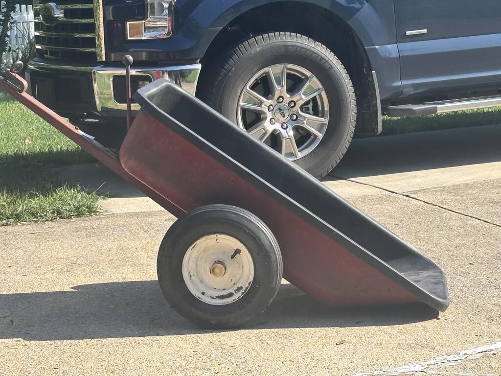

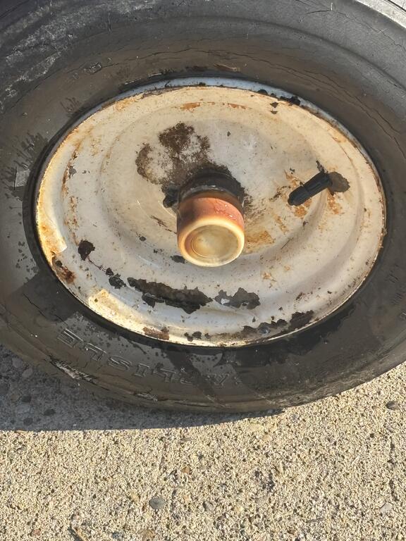

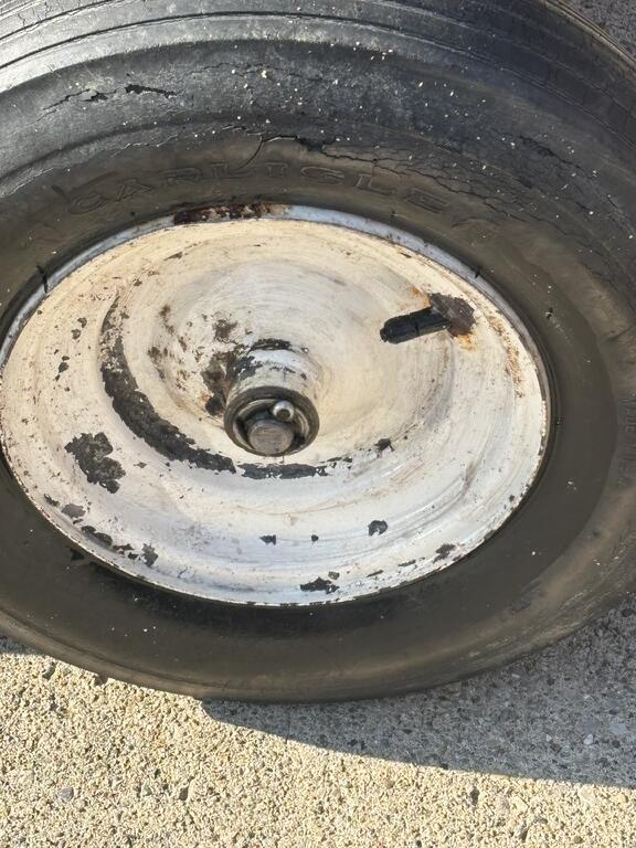

Lane Ranger 11,893 #1 Posted August 7, 2025 I have used this product several times and let me tell you it not only easily removes surface rust on wheels but also seems to protect them from reemergence of yhe rust for some time! i order this off of Amazon but it comes in a p bag that often leaks the gel as they send it with the sprayer nozzle installed instead of a solid cap! But I recommend this product for use on Wheel Horse tractors! The first wheel on the dump cart was sprayed with the gel and cleaned with a rag either moderate pressure on the surface rust. The second wheel pic shows the gel applied and working its magic! Spray with water after completion of an application! 2 3 Share this post Link to post Share on other sites
Lane Ranger 11,893 #2 Posted August 7, 2025 Photo after one application of the Rustoleum Rust Removal GEL! 7 Share this post Link to post Share on other sites
